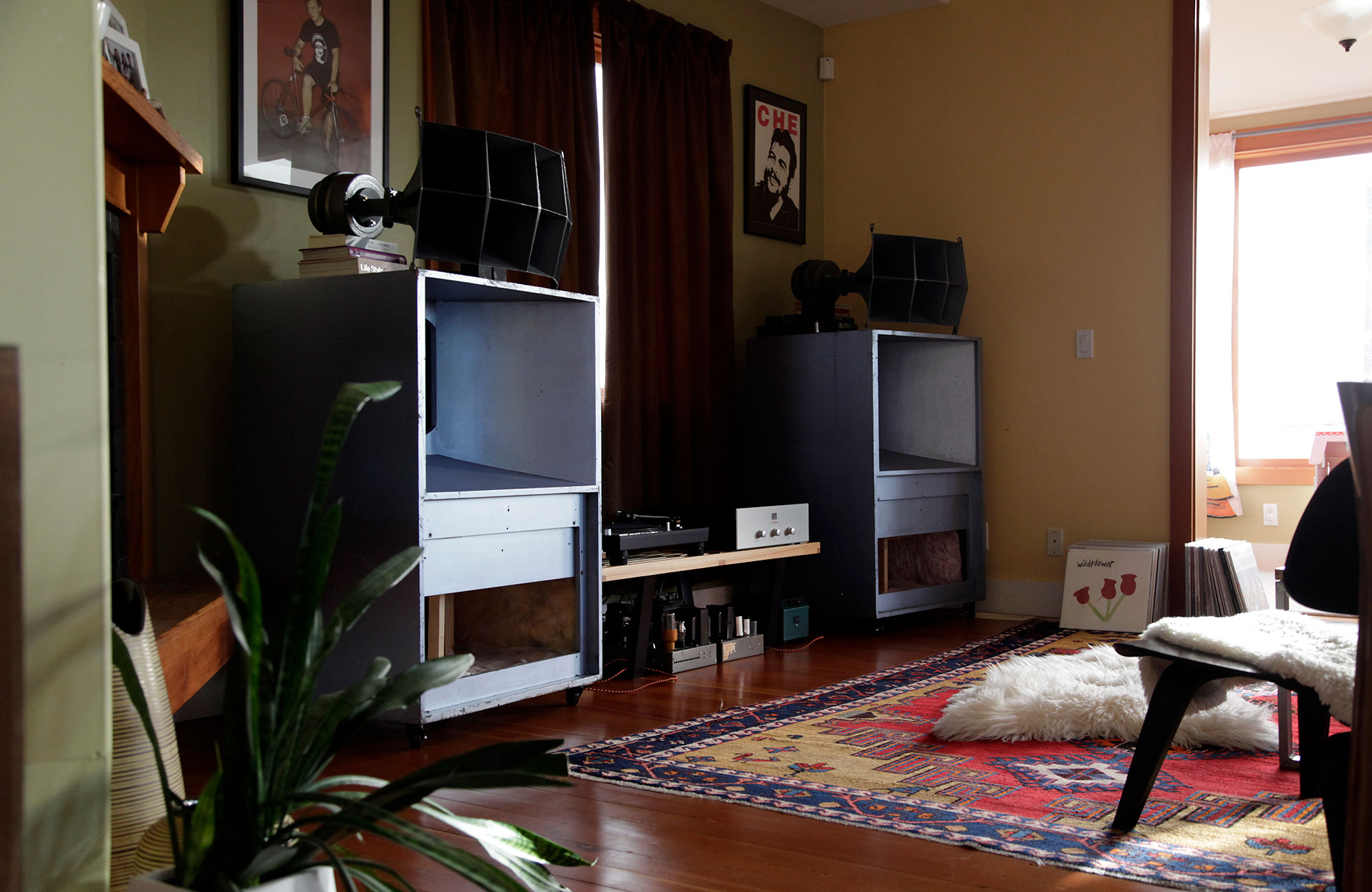

Here is the VOTT system that I built with Mr. Hiraga back in the '80s. I wanted a "Hi-Fi" PA system for some small touring and Jean Hiraga lent me this system, if I would do the upgrade labor. The results where phenomenal. I've heard systems that squeezed more detail out of a recording, or had a more giant sound - but never another set of speakers that sounded as much like real musicians playing real instruments in a real space. These just nailed it. They could even bring to life funky old mono blues recordings or make studio trickery fun.

If the cabinet width is 30, are those wings 12 inches or 15. Are the fixed? Or do they fold and lock into place?
Good question, I don't remember the width of the wings. They were standard Altec size IIRC, so maybe I can find documentation. GM likely remembers.
They were rigidly fixed in this case.
In the back of the woofer horn I used a nice think layer of Blackston (sp?) tar, which doesn't harden. It adds significant damping to the horn flares. On the back of flares of the box I owned, I added a plywood brace, then damped with bituminous paint loaded with sand. That killed the rather bad buzzes and rattles of the horn flares.
On the inside of the main part of the box, the lower part, Mr. Hiraga had me double the walls with Nantex plywood, IIRC 19mm. Nantex marine plywood is no longer made but it was the hardest, densest, heavist plywood I've ever worked with. So hard to cut and drill that it felt like cast iron. On my own boxes, I used 19mm plywood, OSB and bracing. Doing that reduced box talk to very low levels. It also made the boxes very heavy and hard to move.
I never used side wings on mine, had planned to, but never did.
