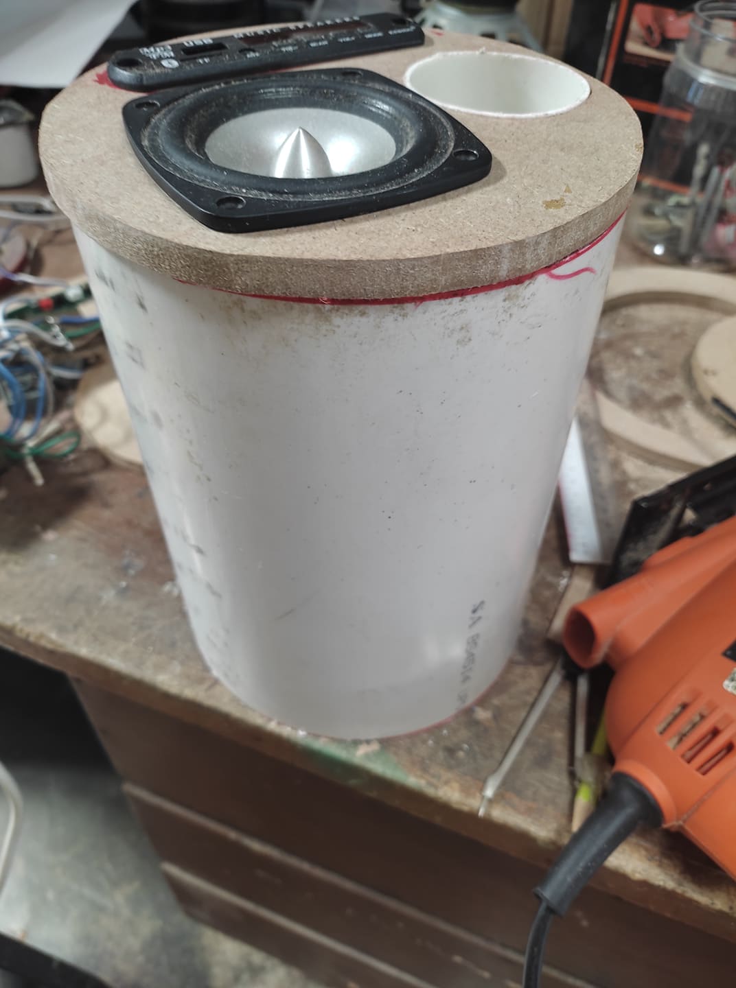

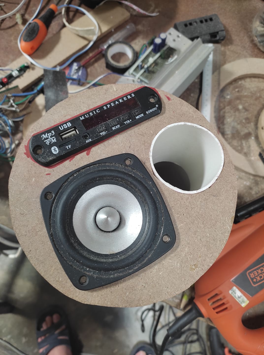

Now i am on a project building a portable mini full range speaker based on TangBand W3-593 driver. Now i currently house it in a 2.5 L ported box tuned about 110Hz using a 2inch diameter port. I am going to include a mono class D TPA3116D2 amplifier and also along with bluetooth module to make it a handy unit
The TangBand felt a little natural and balanced sound which felt it was lacking on the Low Bass end .... it still produces fair amount of bass but not something up to my expectation. I retuned it lower to around 90hz by adding another 90 degree elbow to increase the port length and the difference was not much ...
Any other Alternative drivers which suites for this application? thanks ... those i found locally were just below par than the TangBand which end up sounding worse than the TangBand ... i am looking for something which can deliver more agressive bass at the lower end and drum bass ... treble if lacking i can just simply add a tweeter and perhaps relocate the port to the rear

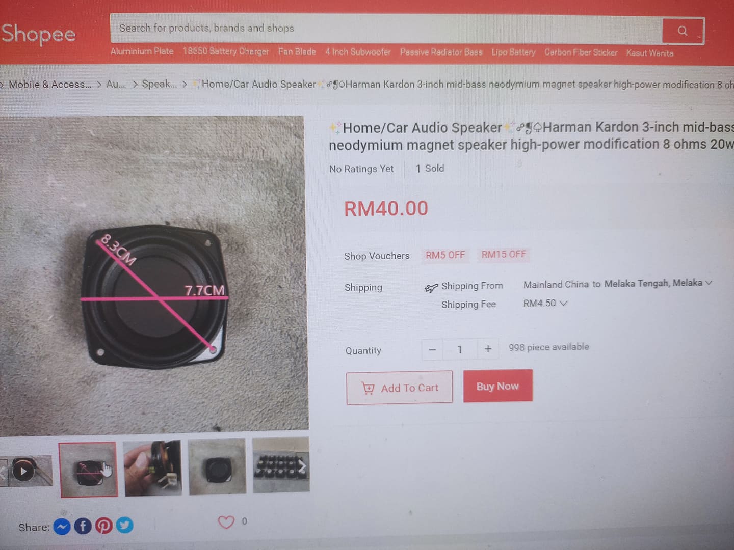

For this project i plan to use a single unit only since my goal for this project is compact, powerful and extending low ... i am building this project for my elder brother in mind it was planned to be placed in the kitchen and sometimes easy to carry to the living room ... and i dont get the meaning of "what are you comparing to?" 😵🤣 meanwhile i placed an order of this ... it a drop in replacement unit claimed that it was from harman kardon unit at good price ... i am waiting for some good newsA 2" port is probably over-sized for a 3" driver - you certainly won't run into air flow issues.

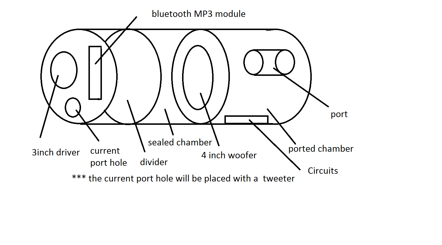

the tang band unit was chosen due to it was the spare unit i had around ( A pair of them actually !!! another one is still kept and not being used ) ... and i build the enclosure from scrap 6' PVC pipes that was leftover from previous home renovation materials and the port also were the remaining used from various previous speaker projects ... i've thought of adding another subwoofer but the idea here i need to seal the TangBand chamber and add a tweeter at the old port hole ... then the remaining rear chamber i just employ a simple small 4th order Bandpass in isobaric form using 2 units of 4inch woofer ... that should do the trick?
I think you might need to be a bit more precise about what exactly you're doing. Is this one box? Two boxes? How many are you able to use? Budget? Size? Crossover if applicable?
my project is basically just a cylinder shaped one unit portable speaker ... Now i am waiting for an alternative 3 inch driver to arrive (ordered) ... if i drop in replaced it, and it still didnt solve the problem of having acceptable bass i guess i will need to seal off the chamber that contains the tangband driver (3inches) the PVC pipe is 9 inches long which left me around 6 inches to house another woofer unit configured to 4th order bandpass ... in my next comment i will draw a diagram off how it going to looks like
As a general principle, it seems sound. In practice, it will depend on whether you can find something that, even in a 4th order BP alignment, needs such a small volume.

i just tested everything today ... it seems i swapped with various different 3inch full ranges when it turned up loud it would cause lots of intermodulation distortion ... i think i might have to ditch this design and follow your advice implement a system with a subwoofer to relief the bass from the full ranges
