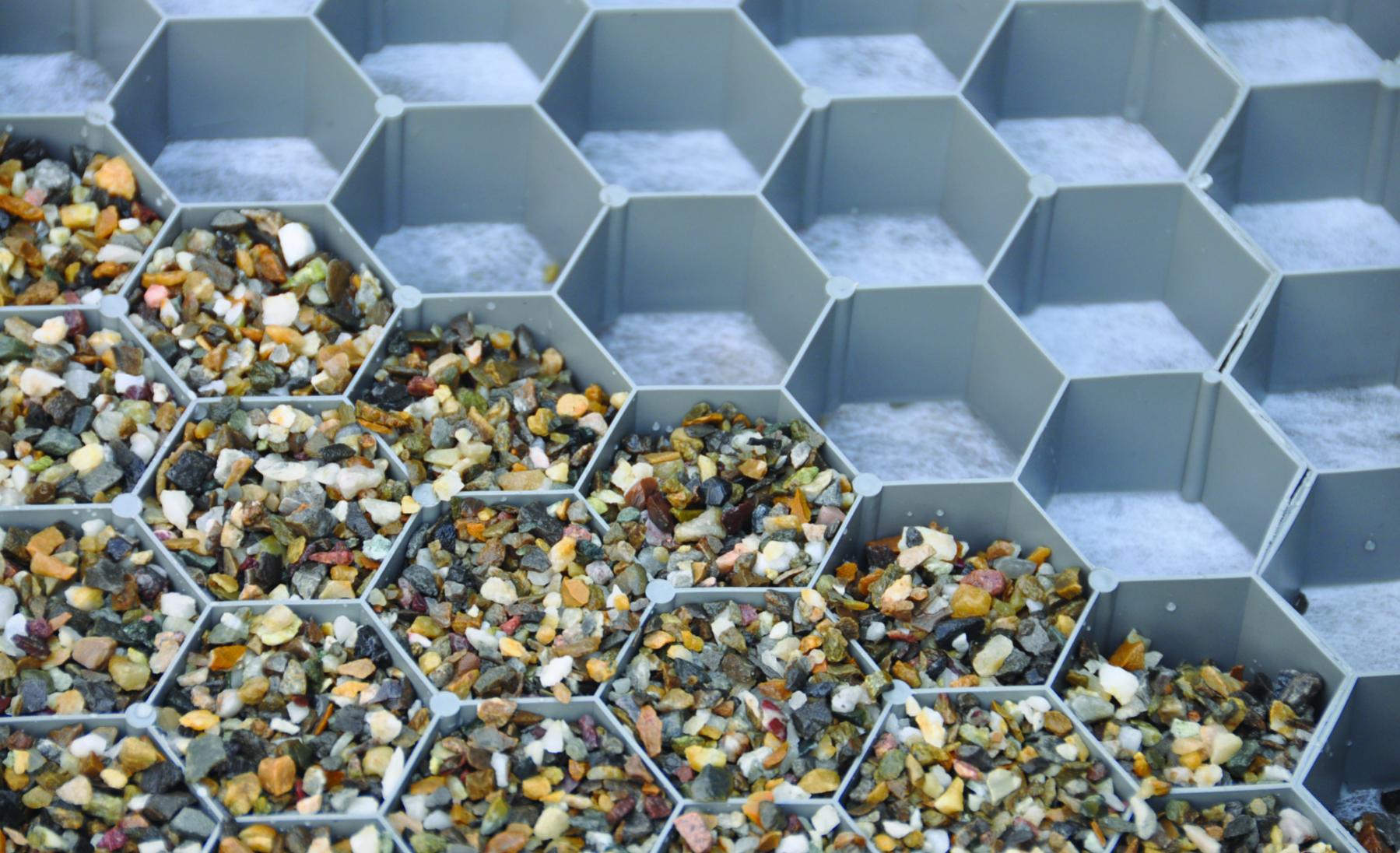

I picked up some of the gravel grid stuff to experiment with - the black one from post 4. It is strong enough to drive on, and structurally is exactly what I want.
The weight is 3.8kg / m^2, which is about the same as 6mm ply. Not bad, but less weight would be nice.
A lighter - and cheaper - option would be to make the filler (lattice) layer from a suitable moulded cardboard item, such as coffee or fruit trays. Most household doors are made this way - a cardboard lattice skinned with a thin sheet of ply.
The cardboard could be painted with something like polyester resin (acetone thinned, so it wicks into the fibres) for better strength and durability, without much additional weight - I think a litre of resin would go a long way.

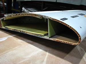

I'm not sure if Ikea did it first or if aerospace did. Here's a flap from a 747 jet, note that it's a similar construction.

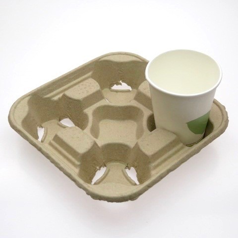

I considered contacting a door factory to try to source the exact same cardboard core that they (and Ikea) use. The problem is that the way they honeycombing is structured, the cells are all individual airspaces. This air volume wouldn't be 'seen' by the woofer, it would reduce the effective speaker volume, unless the inner panel was perforated with a huge number of holes.
I picked up a lattice / structure with communication between the air spaces cos it will be much easier to vent into the main airspace.

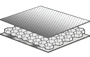

Yep ...but , from the image you posted, it looks like the cell structure of the honeycomb is pretty small, so thousands of holes would be required.
Look for it in the form of radiator protectors for race cars - I've found that's a lot cheaper than whole sheets. Honeycomb Radiator Protector, 19 x 26 Inch
Here's one place that sells paperboard honeycomb, which I think is what's used for non-solid doors. Save On Discount Utrecht Honeycomb Board Sheets & More Corrugated Cardboard at Utrecht

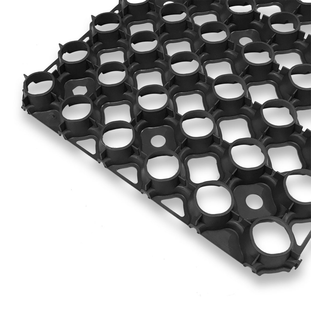

On consideration, the plastic stuff I've already acquired seems hard to beat. It ticks almost all the boxes, the main flaw being the (relatively) high weight.
However, in the context of a whole project, the plastic's weight will not be much of the total. I'm considering a sandwich of:
5mm bamboo (outer skin / aesthetic layer)
4mm ply (backing for the bamboo)
4mm ply (inner skin, with cutouts)
40mm plastic grid (the core)
For a full sheet of material (120cmx240cm or 4'x8') the costs in weight and $ would be:
- 25kg and $172 for the 'wood' component, 13mm thick
- 11 kg and $40 for the plastic core, 40mm thick
...so the core would be roughly 3/4 of the total panel's thickness (53mm), while being substantially less than 1/2 of the total weight and cost.
