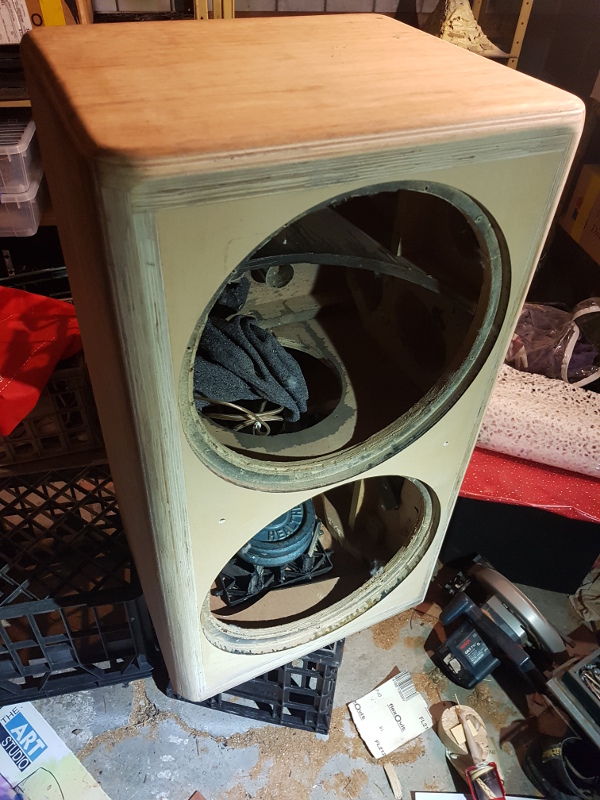

Anecdotally: with the box that I'm currently working on (pix in post 24), this doesn't seem to be effective.
In some of the cutouts, where the wall is (now) a thin skin, I've glued a layer of plastic grid to the inside. On a knuckle test, this has no effect / very little effect. It sounds very hollow relative to the bits that are ~45mm thick. I think a 'sandwich' material needs something rigid on both sides of the core material.

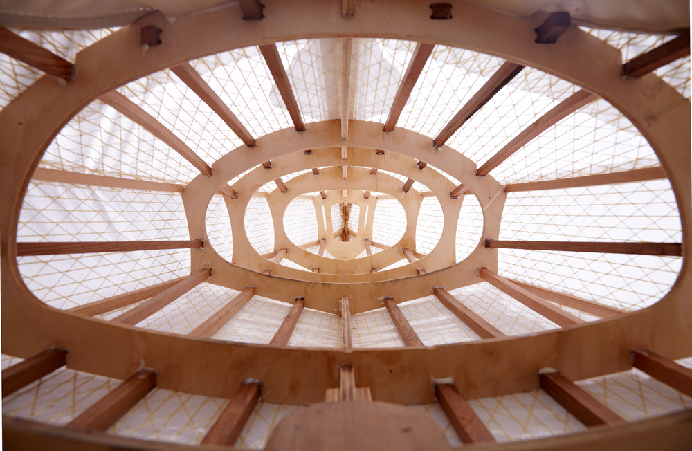

I want to see if making the inner layer as an open lattice (a few light braces, rather than a continuous skin) is enough to give that rigidity.
The lattice image attached here is not my work, but just illustrates how I think it might look, if crafted with care. I'm using random offcuts for my bracing, and hence it is much less pretty.
link I got the picture from
