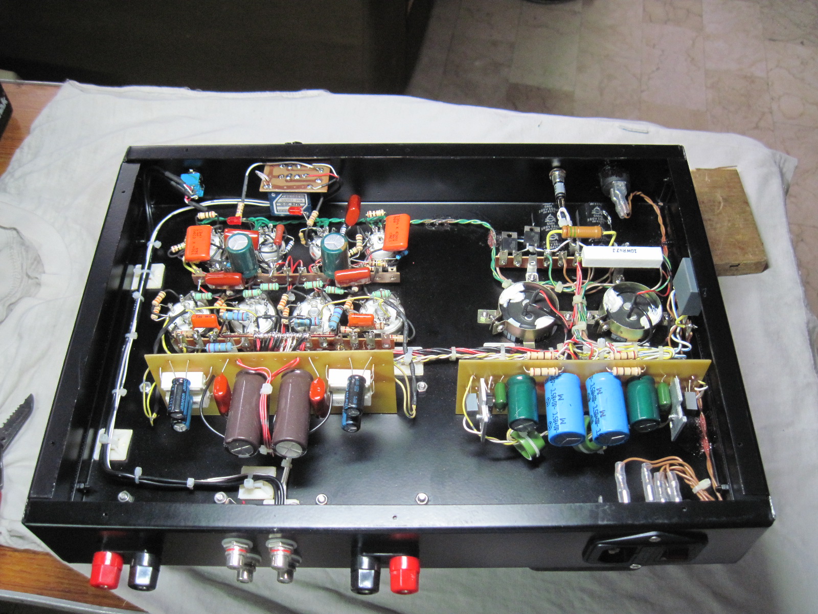

in my case i use a central buss wire #14 or #12 copper wire where all ground connections go, in one place......

not sure if you are reffering to my amp, but those hookup wires are gage #22 stranded wires that are stiff enough to form like they were solid wires...
Hi Eduard, a copper ground buss,using the #14 or #12 solid copper is an old tactic used extensively in the past...it is still relevant today..
Hi Eduard, a sopper ground buss is an old techic used extensively in the past...it is still relevant today..
