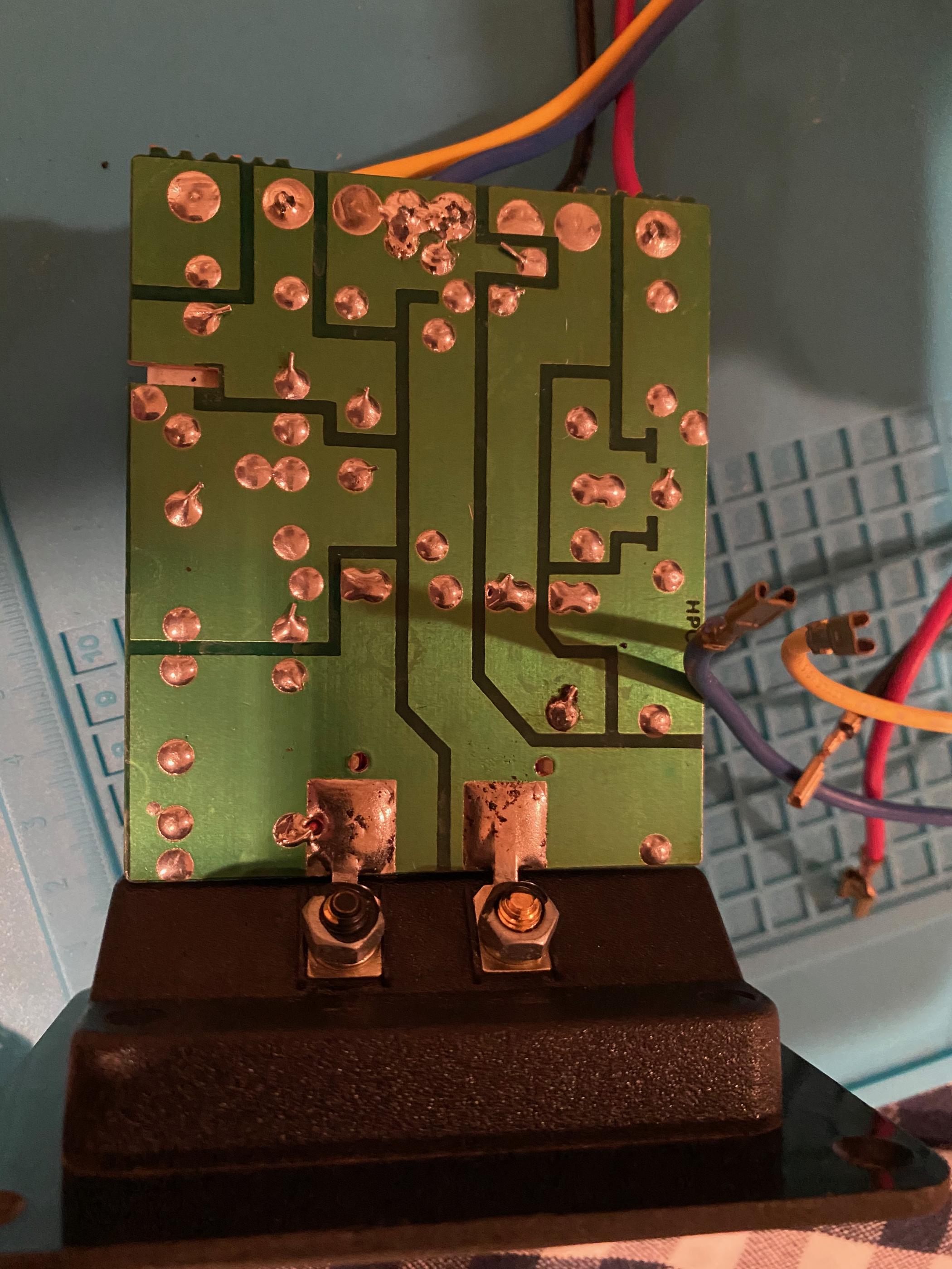

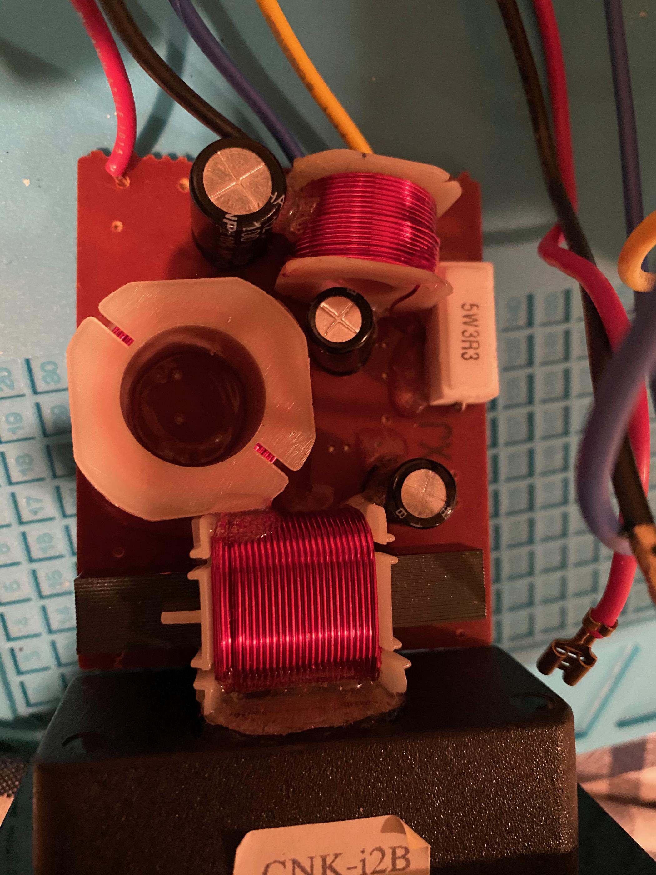

Attached are photos of the topside and underside of the XO PCB.
When looking at the underside photo, the speaker (+) terminal is on the left. Yellow wire is tweeter (+), blue is tweeter (-). On the woofer, I'm not quite sure which is (+) on the woofer side but it looks to me the iron core inductor jumps from the positive terminal to the black wire so maybe black is (+) on the woofer?
When looking at the topside photo, the cap lowest down and to the right is 8.0 uF. The next one up and sort of in the middle of the board is the 1.5 uF. The other cap at the top is 12 Ohms. I don't know the inductance ratings of any of the inductors.
Right off the get-go, it appears to me that the 3.3 ohm resistor is in series with the tweeter (+). Is that correct?

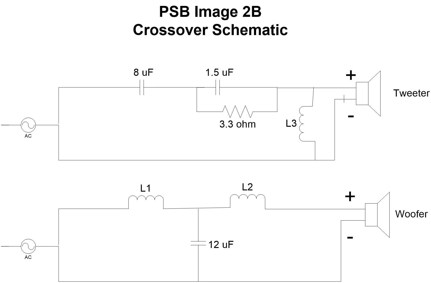

I think I've been able to figure out what goes to what on the XO PCB. I've provided my interpretation in the attached pdf document. If someone with more expertise than I could please check it and input the schematic into a XO design program to see if the design works and what the impedance of the original tweeter most likely is given the impedance curve for the speaker unit, it would be greatly appreciated. If you could put up the schematics for both parts of the crossover it would also be greatly appreciated.
Also, if someone could give an explanation of the XO design, I'd much appreciate it. I'd like to understand how certain aspects of it work and why they did things that way. (e.g. why run the 1.5 uF and 3.3 ohm resistor in parallel to the tweeter? Why run inductors I1 and I2 in series?)

Can you please explain why they have the 1.5 uF cap and 3.3 ohm resistor in parallel to each other and in series with the 8 uF cap in the tweeter circuit? In your simulations be aware that I replaced the OEM electrolytic 8.0 uF with a Dayton 5% 8.2 uF audio grade cap if that makes a difference.
Also, I1 is an iron core inductor and I2 is an air core. Can you please tell me why they went with the two Inductors in series instead of just one inductor? I think I know the reason but would appreciate it if you or someone could explain it just in case I'm wrong.

1.5uF cap was there to lift the HF past 10kHz, and the 3R3 behind 8uF cap is one of the ways to pad tweeter down. 8uF cap with L3 is a 2nd order electrical HP filter.
L1 and L2 form with 12uF a 3rd order electrical LP filter, obviously because designer thought this much was needed to get the response to his liking. I wouldn't be concerned about it.

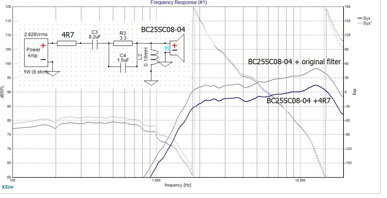

This is a sim of the HP original filter with L3 estimated, a 4-Ohm version tweeter and the solution could be to place one resistor ( either 4R7, 5R6, 6R8 or similar) before 8uF cap to achieve a total spl of a PSB Image 2B measurement from the review.

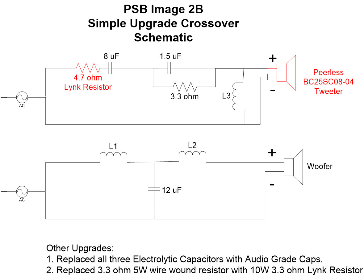

On your suggestion (Lozjek), I tried a 4.7 Ohm resistor ahead of the tweeter circuit first. I could've added some smaller resistors to tone the tweeter down a bit more or put in smaller resistors to kick it up a bit with the extra resistors I ordered but I decided to leave it at 4.7 ohm and be done with it. I don't have test equipment or a well trained ear but I thought that the tweeter seemed in good balance with the woofer with 4.7 ohms added. It definitely didn't need to be made any brighter by reducing the resistance ahead of the circuit and I couldn't imagine the sound could be improved by subduing the tweeter further with added resistance so I just left well and good enough alone and went with the 4.7. I still have the other resistors I bought so I can always change it later on if I ever get access to some test equipment to give those speakers a proper response test.
Attached is the final schematic for the upgraded PSB Image 2B crossovers. While I was adding the 4.7 Ohm Lynx resistor to the tweeter circuit I also replaced the original 5W 3.3 Ohm wire wound resistor with a 10W 3.3 ohm Lynx resistor.
Aside from deadening the cabinets (which I intend to do still) the only other simple upgrade that's possible would be to upgrade the Inductors to better ones, especially I1 which is a laminated iron core inductor. Unfortunately, the Inductances of the three inductors are not marked or known and I lack the knowledge and equipment necessary to measure the inductance of the inductors.
