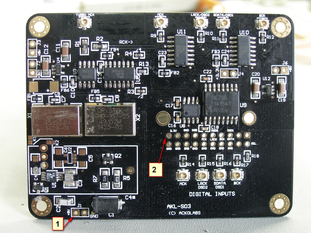

Hi to all.
Just I finished with the last IC that I received.
Sorry for my ingorance, but if I feed this with amanero, the only power supply that I need is J1(1) with 5V and (2) via 3.3V amanero output.
Finally, the big C4 over the LTFDK area.
Am I right?

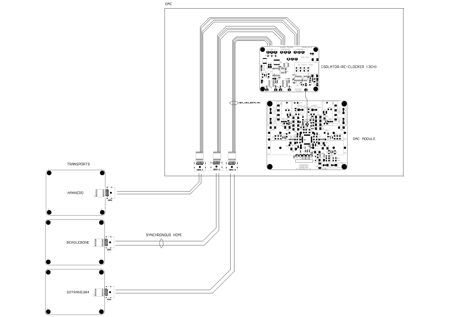

Ray, I am also thinking along the same lines. Teleporter LVDS is fine but I if Edel (or BBB) works out best why not select just one only and put in the same casing (separately shielded of course) with direct connections and avoid all the complications of signal conversions. I am also assuming you will eventually settle for just one type of DAC. I have some plans to do a Sync HDMI version with LVPECL signals as shown where even the clocks are transmitted for synchronous re-clocking - more complex and possibly only for those who want a complete DAC System.
Again concept only at this stage ....
For EDEL-NMR, I will roll out an adapter board soon (before any testing can be done). Primary reason for buying a sample was to get the manufacturer to push the specs up further to cover up to 384K. As you can see this was only partially achieved with the revised hardware at this stage but they have promised to press on to develop the matching firmware soon. Yes, the built-in buffer (now, 2s length) and 32-bit Vol are looking very attractive

Sorry for my ignorance, but if I feed this with amanero, the only power supply that I need is J1(1) with 5V and (2) via 3.3V amanero output. :checked: make sure both the 3.3V pads are connected
Finally, the big C4 over the LTFDK area.:checked:
Am I right?
Lemon,
You need to power up with 5V the J3 and the J6 as well.:checked:
Don't forget the bridge in the K1 position.:checked:
Enrico
Do you want to populate both R3 and R4?:forbiddn: Only R2 for your build. Please remove R4
BK
Enrico many thanks for the help.
Can I feed the J3 & J6 from the same J1 5V PSU or must to be isolated?
Either way will be fine but prefer to drive clock from its own power in a final setup.
Please see wiring diagram and BOM as shown in the manual for more information

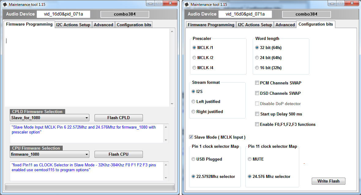

Hi to all.
.... if I feed this with amanero
For Sync Re-Clocking with Amanero:
Please configure Amanero with:
1. CPLD: Slave_for_1080
2. CPU: Firmware 1080
3. Set Config bits as shown to match S03
Please be aware that there seem be a issue with the operation this way. First reported by Miksi here:
post#1050
Not sure if others have experienced the same problems.
I have been following up and found that only 44.1k files worked properly on my setup. As soon as 48k music is played the Bit_Clock from Amanero disappears and no sound!
Also, when I tried HiRes DxD (358.8k 24bit pcm) music from Nordic 2L e.g.
http://www.lindberg.no/hires/test/2L38_01_DXD.zip all I heard was garbled sound!
Looking more like a firmware issue with the Amanero as S03 works well with other transports for both 44.1/48k-based music.
All these have been reported to Amanero about a week ago and awaiting response. Hopefully this can be fixed soon
