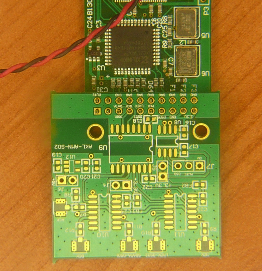

I'm finally getting around to finishing off a DAC that I started some time ago 🙄. I was going to use the ACKO AKL-AMN-S02 board just as an isolator for the Amanero board, but I'm not sure the boards are compatible. If you look at the picture you will see on the top right of the Amanero output header labels F1 F2 & F3 where the Acko board has them labelled as ground.
Does anyone know if they are compatible?
I'm pretty sure (is inside another DAC) on my other Amanero board F1 F2 & F3 are ground connections, the 2 Amanero boards appear to be different versions.
As I am connecting this to a BIII with no re-clocking does anyone know which firmware I should use?

No harm connecting the new version of Amanero to the S02. F1-F3 are open collector outputs and can be connected to ground- will not fault.
Use the factory default firmware 1080 in master mode for your Async operation of the BIII
