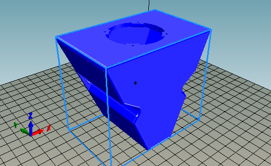

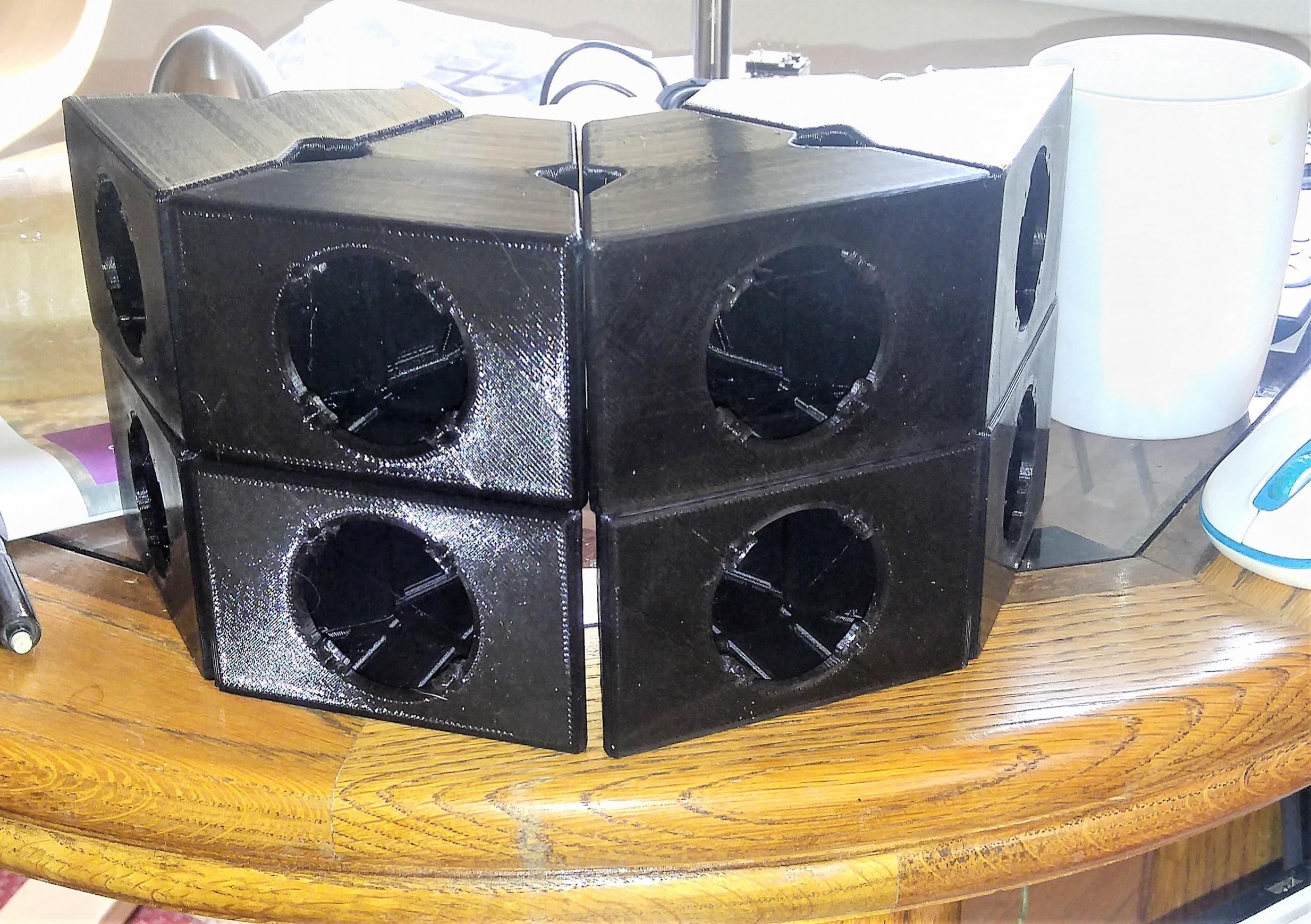

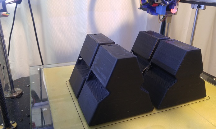

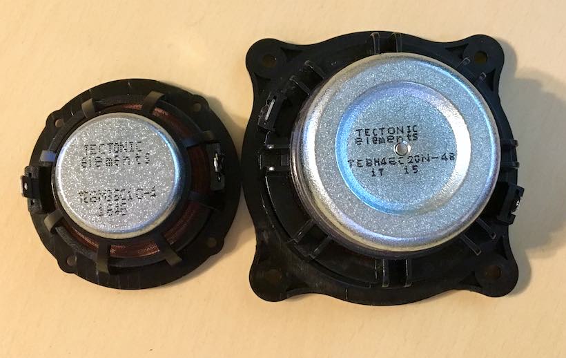

Getting there. The BMR drivers came in and I 3D printed a few little enclosures for them to try out, maybe later today. A printed box is about the only practical way to mount these little suckers if you plan to use the tiny mounting holes, the cutout is pretty complex and not much room for error. Of course, if you plan to use wood and construct by hand, you could just cut a 46.5mm dia hole and use silicone glue to mount the driver, but the mounting holes wouldn't be usable since the holes are on a diameter of only about 47.5mm! The screw sizes, btw, would be either M2 or #2 self-tapping type. About the same size as the screws that hold remote control units together. I got some on order from ebay.

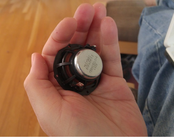

These things are TINY, here is one in my not-particularly-large hand:

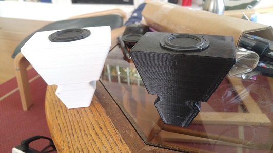

These are two enclosures I made to test it out. The black one was supposed to be a revised version (different side mounting slots), but I managed to choose the older file instead when I went to print last night
The plan (if this works out) is to have 4 of these per side mounted to the back of each speaker, firing upward and toward the sides. With one each, I don't expect to get much volume from them -- not sure I'll get enough with 4 each for that matter! Hoping that running them with a highpass will let me drive them a little harder.
This is what the 'revised' version looks like. Mostly just moved the mountings more toward the fronts and changed some angles/slopes to make things easier for the 3D printer.

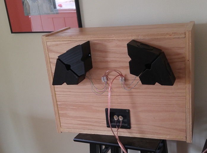

OK, all the stuff now copied over, here is where I am today -- after some printer problems (caused by me changing nozzles incorrectly), I've started to print the enclosures needed to install this. The plan is to have four mounted onto the back of each SmallSyns speakers. Here are the first four, which just finished printing. I have the print of the last four started now (takes about 12hrs for a set of four):
I've been listening to the single ones playing for a few days now. I have to say that I really like the effect. I get the precision of the Synergies, and the ambience of an omni, at least at higher frequencies. I can't say whether ambience to lower frequencies would be a big improvement, as these little critters don't play all that well into the hundreds of Hz for me to realistically try out.
So, I've only gone slightly over to the Dark Side. Not a full Bose effect (which always reminded me of the sound heard walking around in a drive-in movie theater during a show, about 40 years or more ago!). But little ambience tweeters give quite a lot more life to the presentation (without being shreaky), a way better depth illusion, and (paradoxically) better ability to differentiate instruments in recordings. And they aren't visible behind the speakers, so the room still doesn't look a like a hobby room!
Also, being behind the main speakers, they don't reveal their locations when I move within the room, which is a good thing.

The STL file is up on Thingiverse, for anyone with access to a 3D printer and an interest in playing with ambience tweeters. They will work without DSP delay, though not as well (more tendency to affect sound coloration).

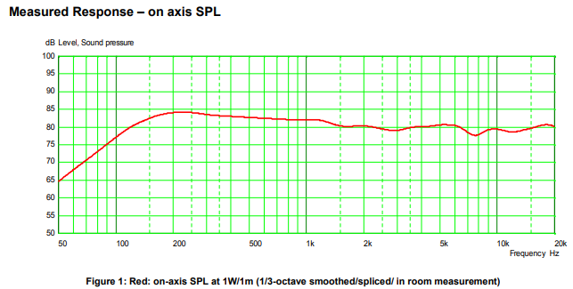

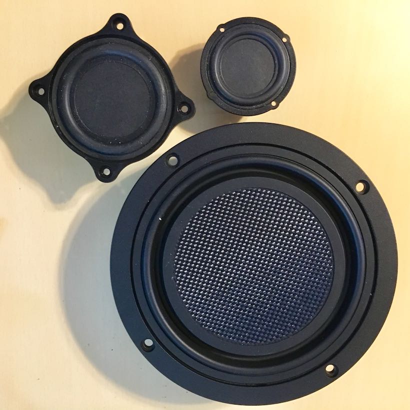

Interesting that you chose that little driver. I have a pair of those and they sure are tiny. I also have the bigger brother about 3.5" See photos below.
Dayton sells a similar flat woofer, also pictured below. I bought them for a shallow speaker project but ended up using other drivers. Nice idea using them for ambient channels.

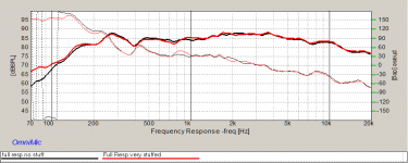

Bill have you measured them? I found they were extremely sensitive to reflections in the enclosure. Only denim insulation all the way around them made them smooth. I found out later in a discussion with Dennis Murphy he had the same experience.
No measurements yet. I did plan on stuffing the enclosures with denim fill (mostly because I have a huge bale of it sitting around already!)

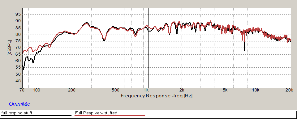

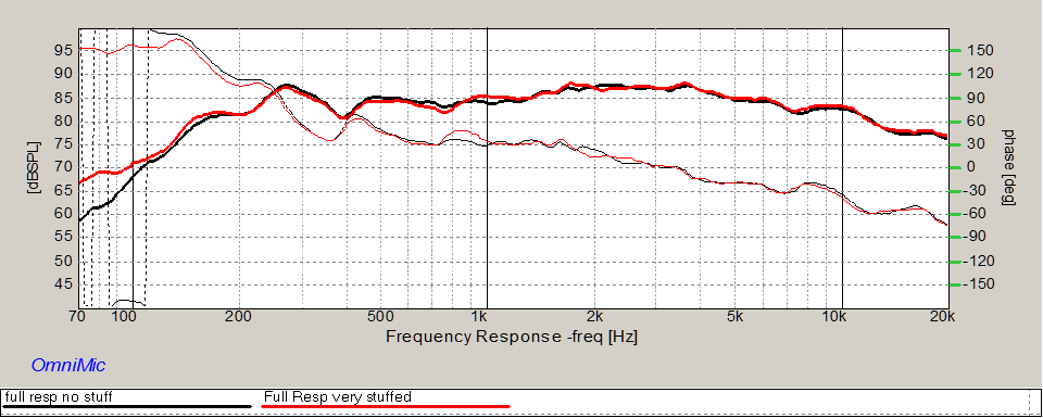

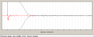

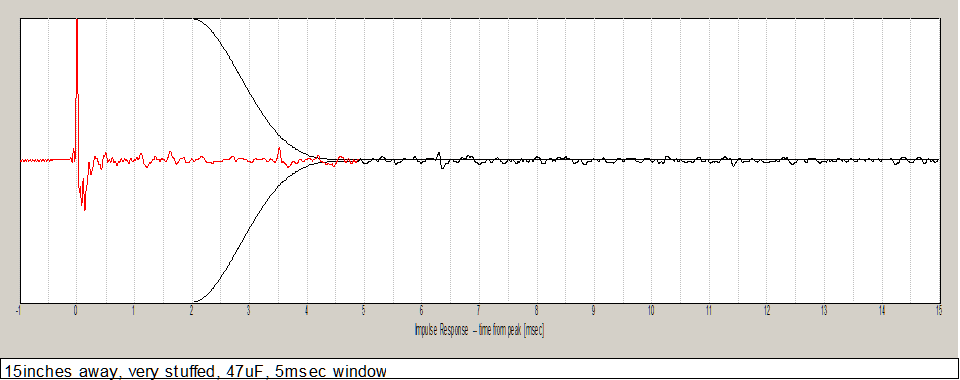

I finally got around to measuring. I can't say I found the effect you described. Here are measurements I made today. These are from 15" away (I was working in a tight area). Windowing is at about 12msec, so lots of nearby reflections getting into it, still.
No Smoothing:
1/6th octave smoothed:
Not a heck of a lot of difference, there.

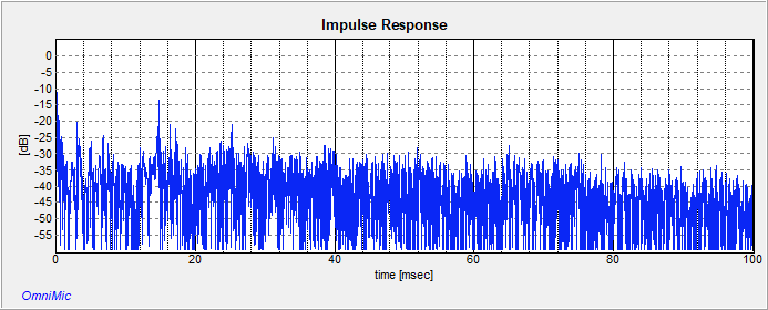

Here's an impulse response (the stuffed version):
Those are all on-axis, I didn't do any off-axis. Though just playing around they didn't change much when they were somewhat off.
Surprising how smooth they actually are. Also surprising is that the HF is rolled off, doesn't look too much like the plots in Tectonic's data sheet:
Not surprising is that their sensitivity is low, like driving bricks almost. Fortunately, I'm only using them at HF and for ambience so not all that much power is really needed.

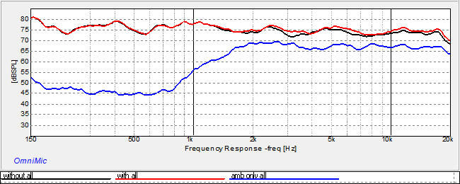

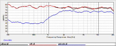

Some system meas with the ambience

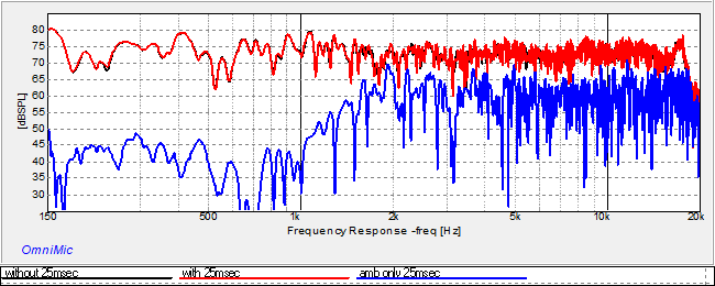

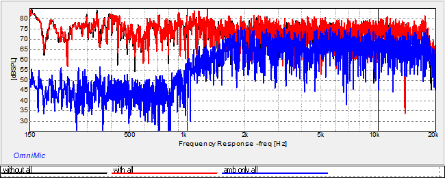

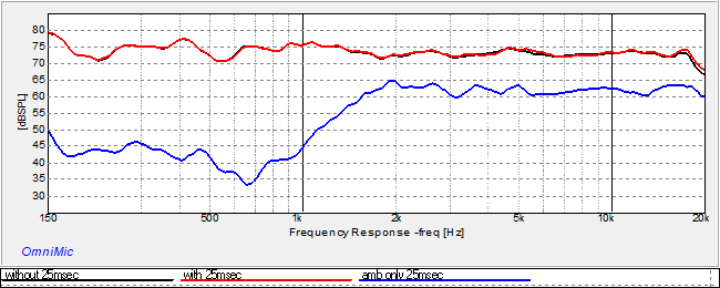

So, I have all the BMR drivers mounted behind the speakers and playing. Some DSP alignment today and measurements.
Here is an unsmoothed set of responses from a 25msec window. Black is without ambient tweeters, Red is with, Blue is the ambient tweeters on their own:
With 1/6th octave smoothing:
The BMR hardly shows in the overall response and its level looks about 10dB below the main this way.
But if I take out all windowing, then it looks like this:
Which shows the added ambience being about 5dB below, this sounds pretty good, too. It might be able to be pushed up a smidge, but I want to listen to more music types before I do that.

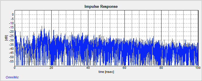

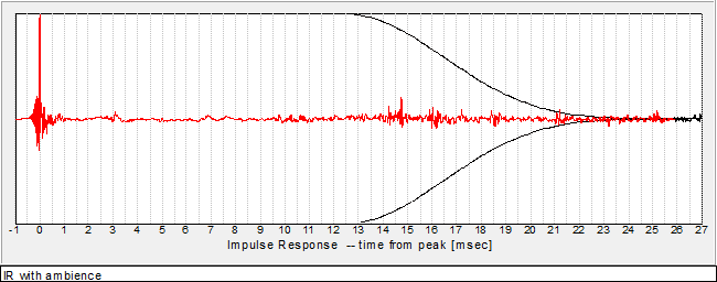

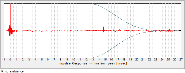

This is the Log-Impulse Response without:
And with:

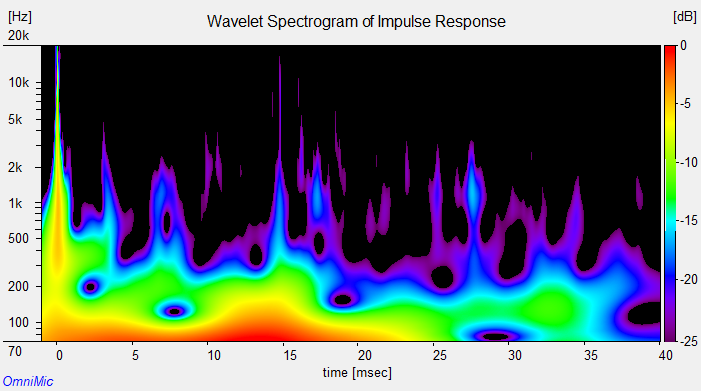

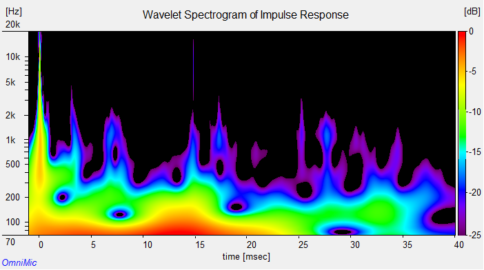

Probably a better way to look at this is via Wavelet Spectrogram, so:
Without:
With:
I can't imagine anyone would prefer the sound without, at least based on what I've been playing so far (jazz, live classical, old rock). 'Chris Botti in Boston' is pretty amazing actually.
Probably some will consider this cheating or not being faithful to the recordings. But I see it as no different than placing speakers out into the room, which ehances room ambience also -- and who wants to listen in a totally dead room? Most recordings we use are only spot samples of a sound field, and were mastered to be heard in decent room, so this is just making the room more decent. But a lot more versatile than just speaker type or placement.
