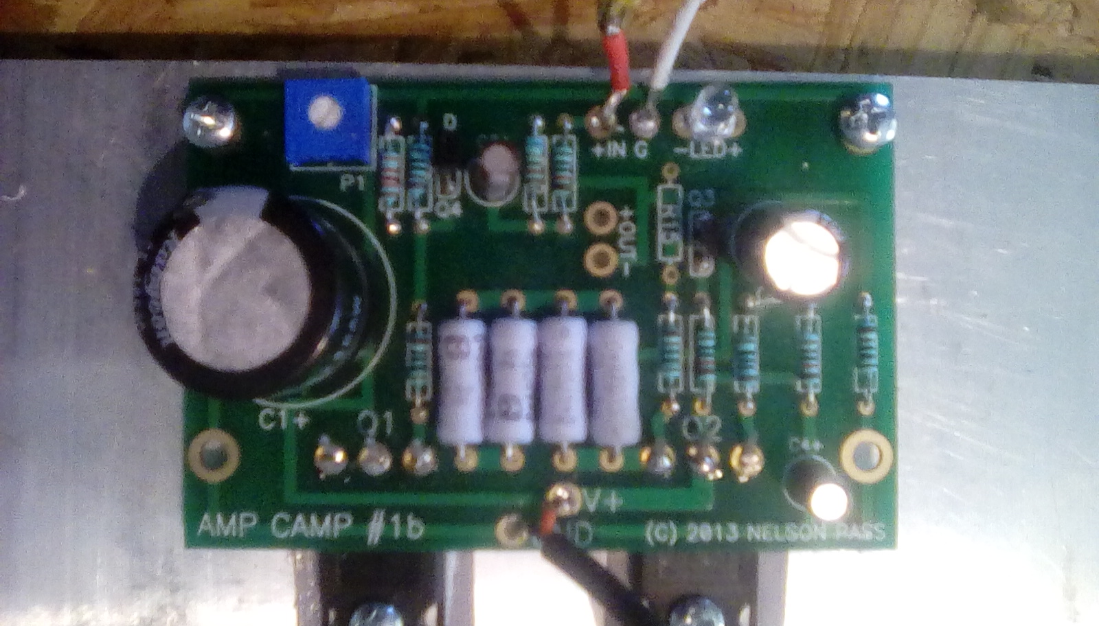

Hello,
I just tried to adjust the bias on my amp camp. On the 20v setting of my mm I can mostly read 0.02v no matter how I turn the pot, sometimes it jumps to 2v. The LED stays on for a while after shut off. What's a good method to trouble shooting? Here's a picture.

R15 is missing, but this would not cause your problem.
