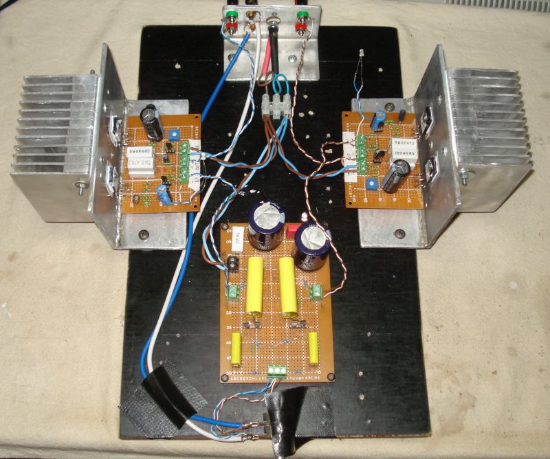

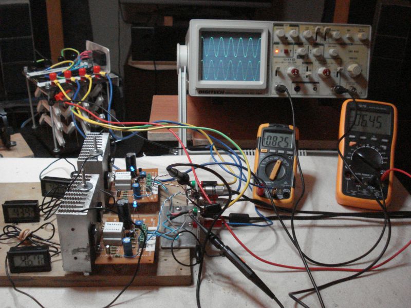

Hello,
This is my attempt at an ACA.
I have used it to try and gain more knowledge since my other builds.
Started with the basic ACA, then added and removed R15, R12, 24volt and heatsinks and other bits.
Well the figurers below have all gone funny when I added them so I hope they make sense.
Measurements are Average not RMS,(something else I have to get my head around)
Input 8ohm load clipping
Volts, amps, Volts, Amps, watts, amps, volts, amps, watts
242, 0.079, 19.6, 0.979, 19.19, 0.778, 6.34, 0.807, 5.12
242, 0.140, 24.0, 1.404, 33.69, 1.275, 7.07, 0.899, 6.36
Have ended up going back to the basic 19v ACA with the home made heatsinks.
Also added the B1 pre.(this was in my junk bin as I did not like it compared to the B1.2 or the BA3 pre I had built but it sounds great with the aca)
It all runs of a single computer power supply.
Now I need to put it in a box.
