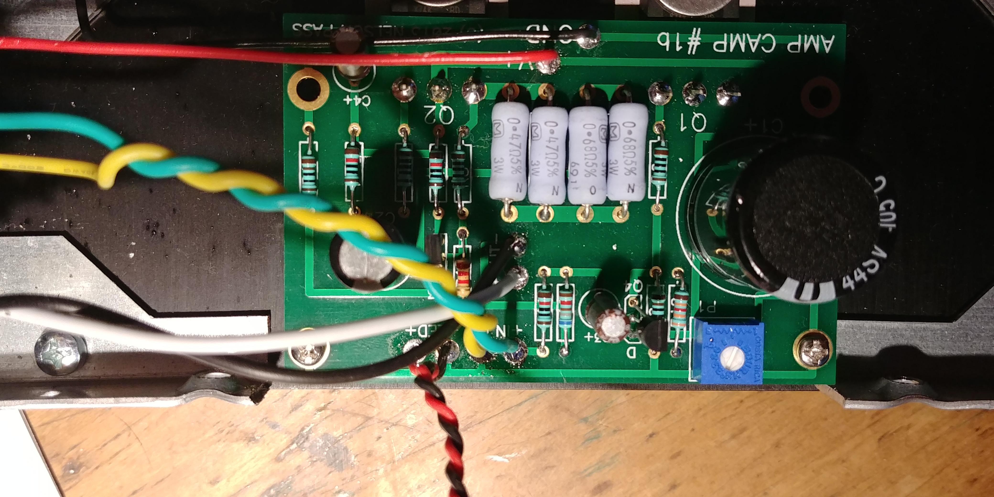

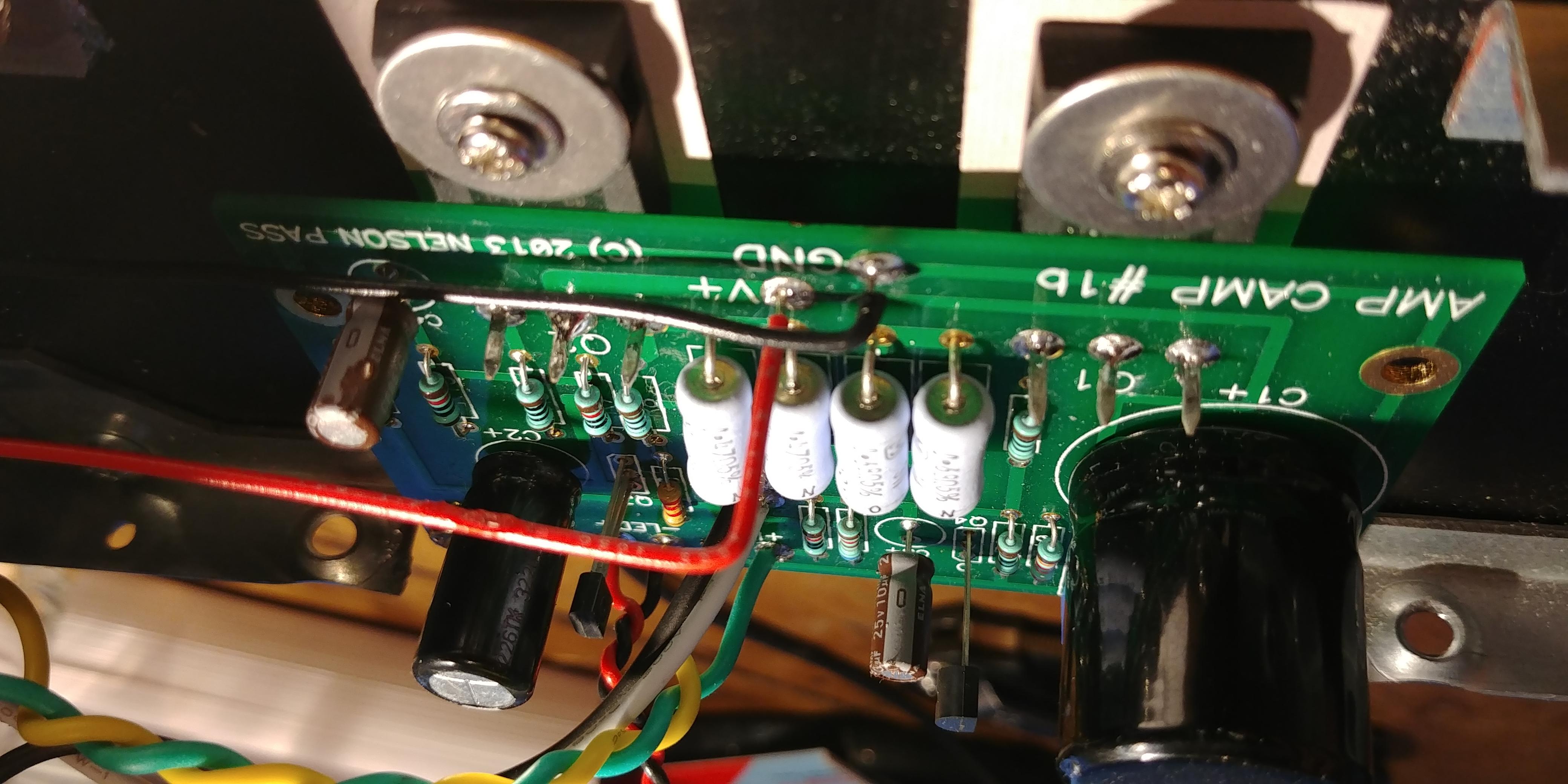

ACA Troubleshooting Help
Hello everyone.
I finished my first ACA build and it sounded wonderful. I was really surprised at the build. This was my first build and it was an amazing experience.
I decided to clean up the wiring runs; to make it neat and tidy. You know that saying "if it ain't broke, you should totally mess with it - whats the worst that could happen"?
I finished the first board and tested it. The channel stopped working properly.
Initially, I was getting very very faint audio from the channel. Then, nothing. At all.
I have tested:
-checked rca cable
-checked speaker cable
-checked source out
-powerbrick is powered up
-adapter is wired properly in chasis
-power is running from the supply through the switch
-switch working properly
-power to the board at 24v
-led lights up
-however when I test q1 for voltage I get 0
-does not heat up
-I went back over all my soldering and re wired a second time
-other than the wiring I have not intentional changed anything
Pretty sure I ve managed to do something inadvertently and I am out of my depth to trouble shoot it further. I am a complete noob and as part of the learning process I'd love to figure this one out. Any insight/advice would be great.

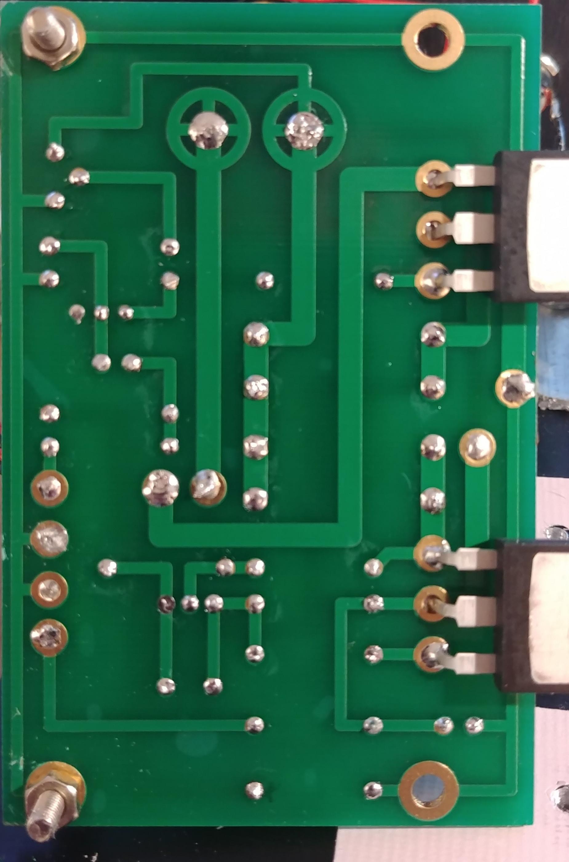

no shorts on back side ?
everything properly soldered ?
Thanks for the quick reply.
Everything was working so I am assuming the parts are in the right place. Just pulled the board and while some of the solders are not exactly pretty, it looks to be short free...
yeah ,short free and hopelessly cold , in most places
find proper video tutorial for soldering (not smd) , find some old pcb and do some exercising
It was my first soldering project. Learned lots along the way. Thank you for the advice. Would this cause the failure or is this more an aesthetic/best practice kind of thing. Would it be worth pulling the components and re soldering?
cold solder joint means no contact or bad contact (having resistance )
no need for pulling , use solder sucker pump to remove most of already applied solder , then solder again properly
again - best to prolong it few evenings , and practice soldering on some old pcb , they're everywhere

paceworldwide also has an excellent series of videos available on youtube, if you don't mind the dated style. #7 has good examples of correct and incorrect joints and what causes them. Thing is, every board is a bit different and sometimes you need adjust your technique a bit based on how things are behaving.
