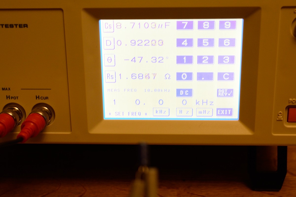

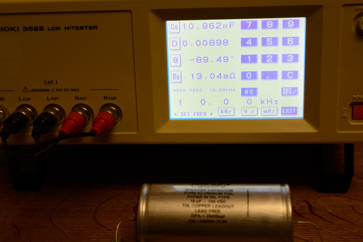

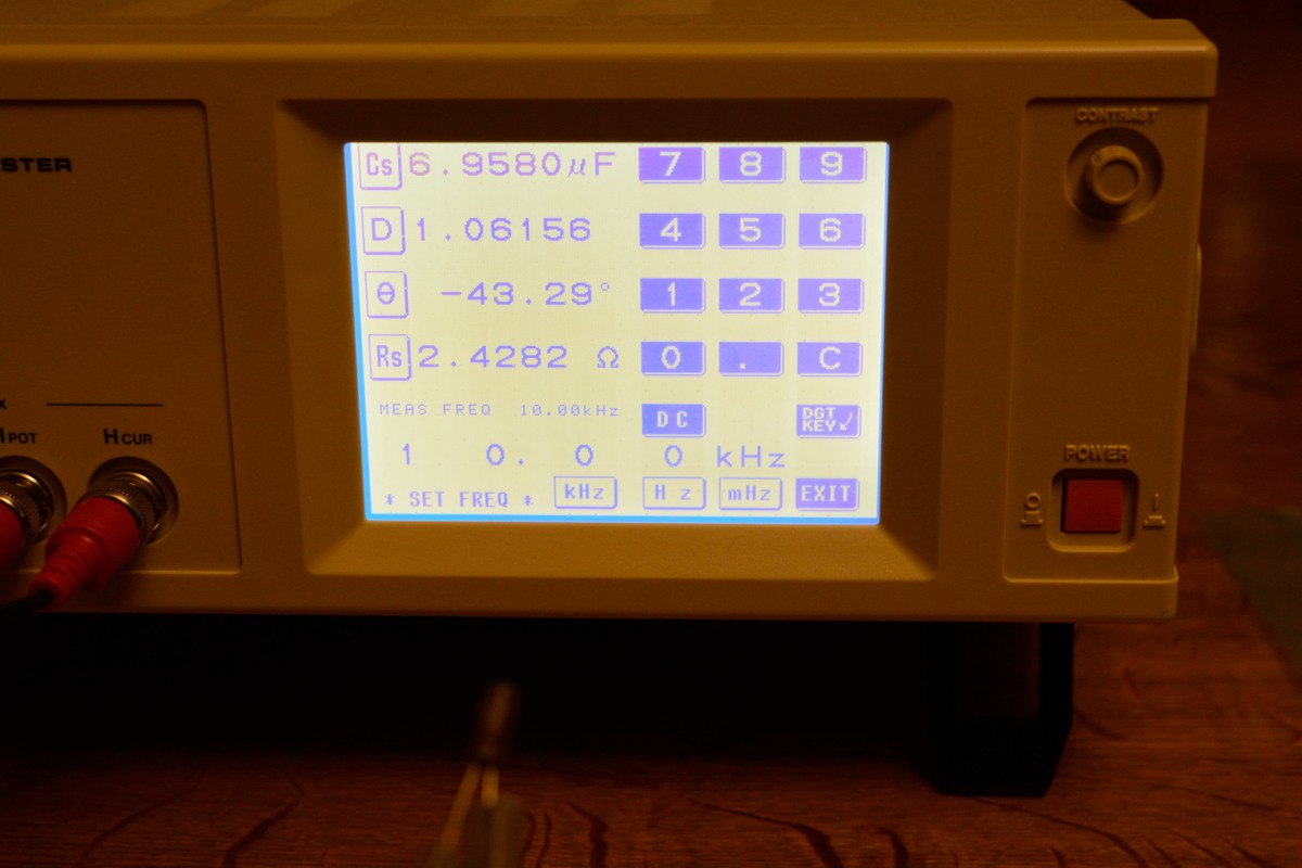

I just got components home from DigiKey for the ACA. I got the 10uF/25v Elna silmic II and to have something to compare with I also got the standard Panasonic 10uF/25v. Then for the project I have a Jensen 10uF/100v alu foil (a "real" capacitor).
I made some some measurements at 10 kHz to check how the 3 capacitors performs. The Elna Silmic II performs worst. The Panasonic a bit better but no match for a real capacitor. Think the data talks for itself.
But people thinks the Silmic "sounds" good?
There will be some "phase error".....
