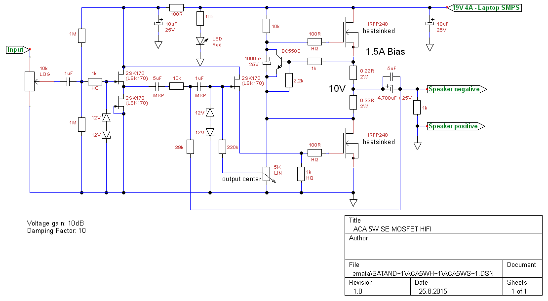

What music source do you use? if you stream music and use a DAC some of them has both a fixed output mode and a pre-amp mode. My DAC has that. Then I can switch between the modes. Until now the fixed output mode and use of a passive pre-amp (pot = 24 step attenuator) has been the best solution.
I think the problem by using a passive pre-amp with the ACA (e.g. a 10k pot) is that when you change the volumen setting you also change the amount of NFB.....as I have understood how it works. It could work OK using a 10k or 5k pot. It has to be tried. You get more and more NFB when you turn up the volumen. Then when you have turned all the way up so there is direct connection to the source the ACA works as specified. Someone could correct me if I am wrong.
The first version of ACA has less NFB....and sounded ok? ....therefor it might work by using an e.g. 5k pot as volumen control? That is my logic without beeing an amplifier expert :)
It is probably wrong what I wrote.......you will start with more NFB than specified and then when you turn up.....it will be lesser.....if you use a pot without a buffer......

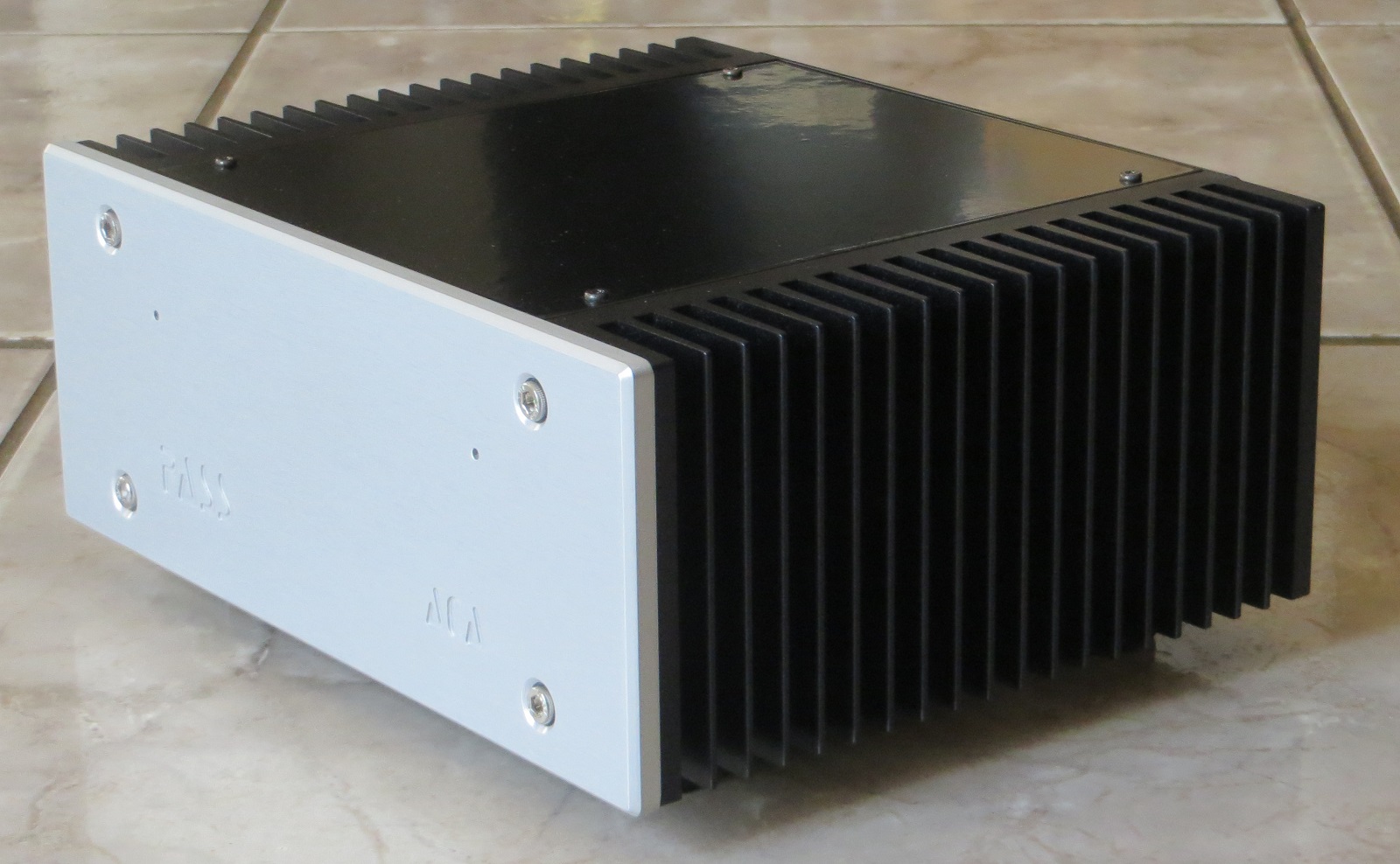

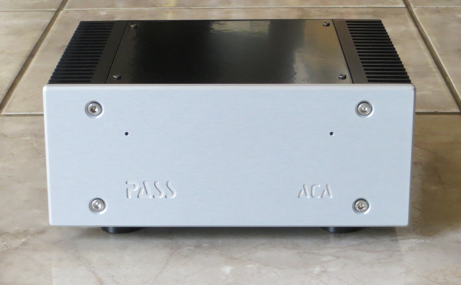

Isn't it uncanny how much the new chassis looks like my recently completed ACA?

I think it was me that mentioned about the changing of NFB when using a pot without a buffer. The pot will be in serie with the 10k input resistor so amp will "see" a higher value than the 10k input resistor.....and Rin is part of the NFB loop. If you use a 10k pot and turn op a bit so it stays at 5k then Rin is 10 + 5 = 15 instead of 10 and that will change the amount of NFB as far as I can see. If not I have to read a bit more about the inverting op amp......Zen Mod was mentioning in an previous post. The solution may work ok........but has to be tested I think.

Doesn't the ACA have a "buffer " of sorts with the JFET at the front? Is it still only 10k ohms input imp. ?
yup
though , we can go up to 20K , altering two resistors in FB by factor of 2 , but 20K is still too low for pot in front of it
