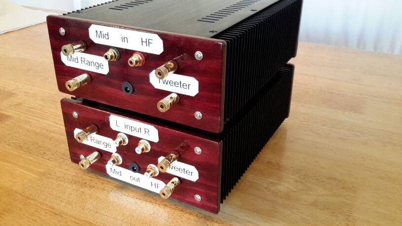

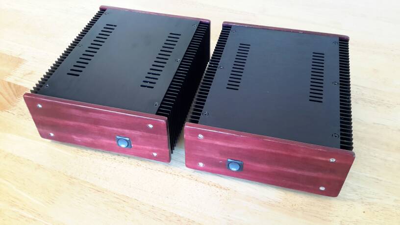

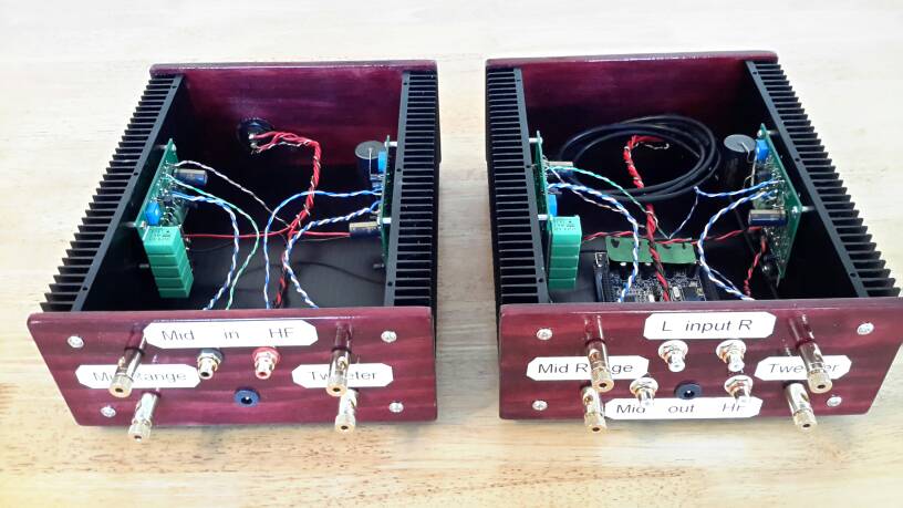

Hi all, just an opportunity to thank Mr Pass and all those that contribute to these forums. I've just finished my Pass ACA build. Two chassis with two ACA's in each and minidsp to make a full active setup for my LeCleach horns. Each chassis has two amps, one configured for hf and one for mid range. The output caps have been reduced and upgraded to good PP caps as the mid amp only has to have a response down to 350hz and the hf amp down to 5500hz so good caps are affordable. I also have a Berhringer DSP amp for the bass.
This setup sounds absolutely beautiful!
Thanks for sharing this design and knowledge.
