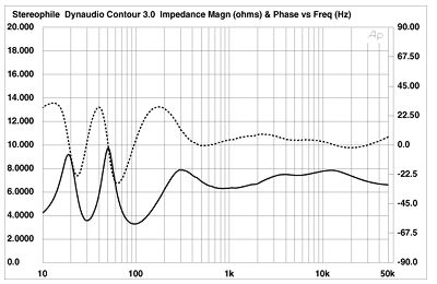

Couldn’t find measure of the JBL, i’m gonna guess given it is 2.5way will not have a flat impedance curve, but the reduction in impedance at LF might give more appropriat elevels of BSC
Seems there are lots of Dynaudio Contour, the first i found has an OK curve for bridged ACA.

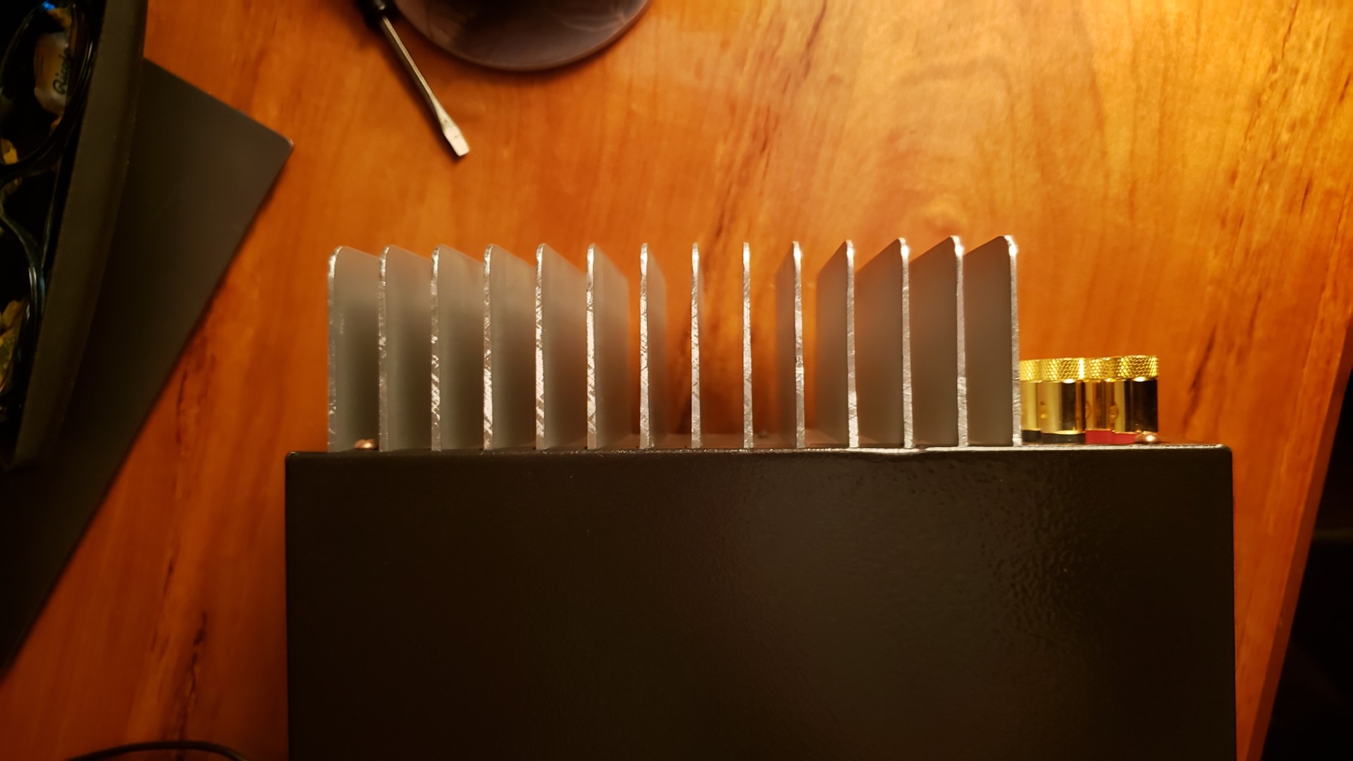

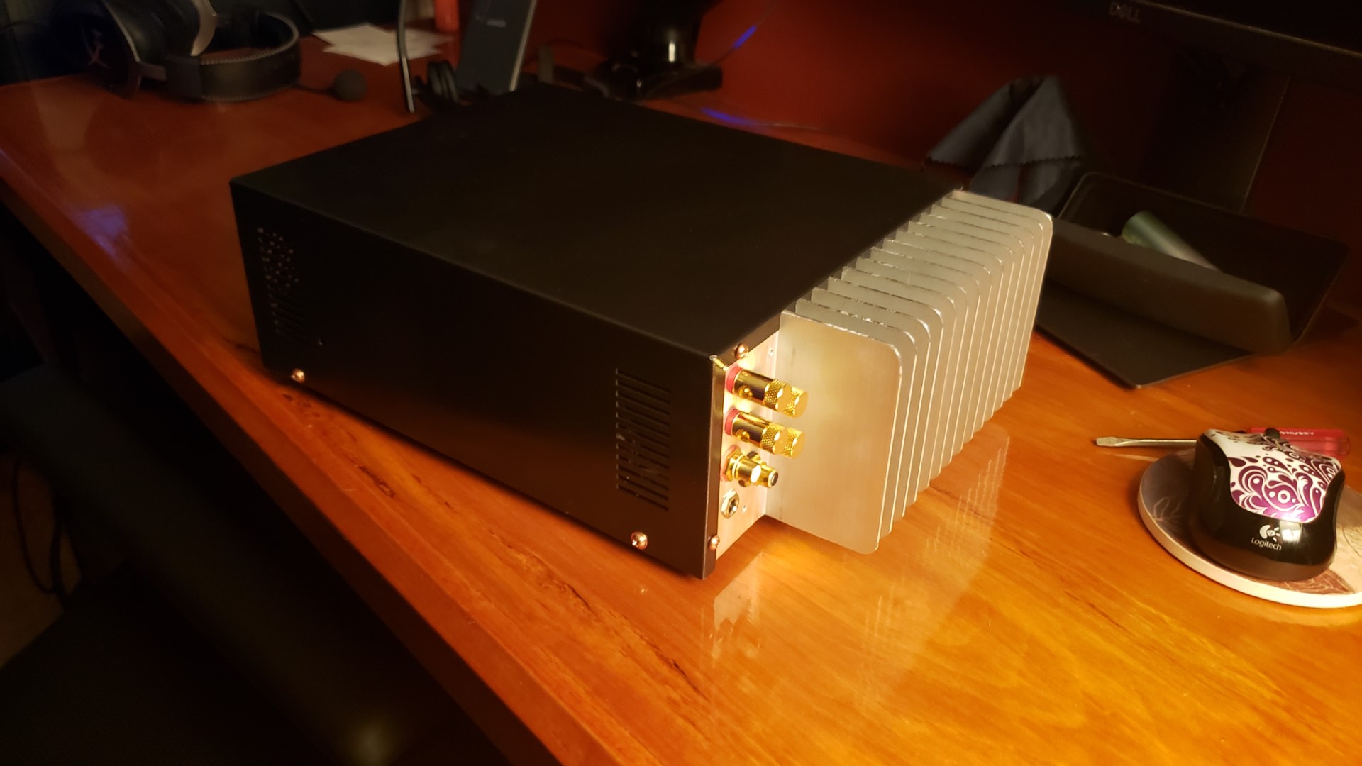

I way under guesstimated the size of the heat sink I used for my ACA. Instead of the using the heat sink I originally planned on using, I opted for a lighter (easier to work) heat sink that I salvaged out of a long dead, circa late 90's JVC receiver that I purchased as a teenager.
After powering up the amp, after about 10 minutes, the heat sink was getting uncomfortable to touch. I had a temp sensor that was reading about 45C on the heat sink. The sensor didn't have very good contact, so I suspect the temp was a bit higher, and I just shut it down before anything was damaged.
I assume this new heat sink will be more than substantial. I have a student version of Autodesk Inventor, so I modeled the profile, and after I trim it down to 8.5"x4.5" to fit the case, it will be around 1.22pounds, and have 435 square inches of surface area. Rather than make another assumption, how would I go about calculating the heat dissipation of the new heat sink.
