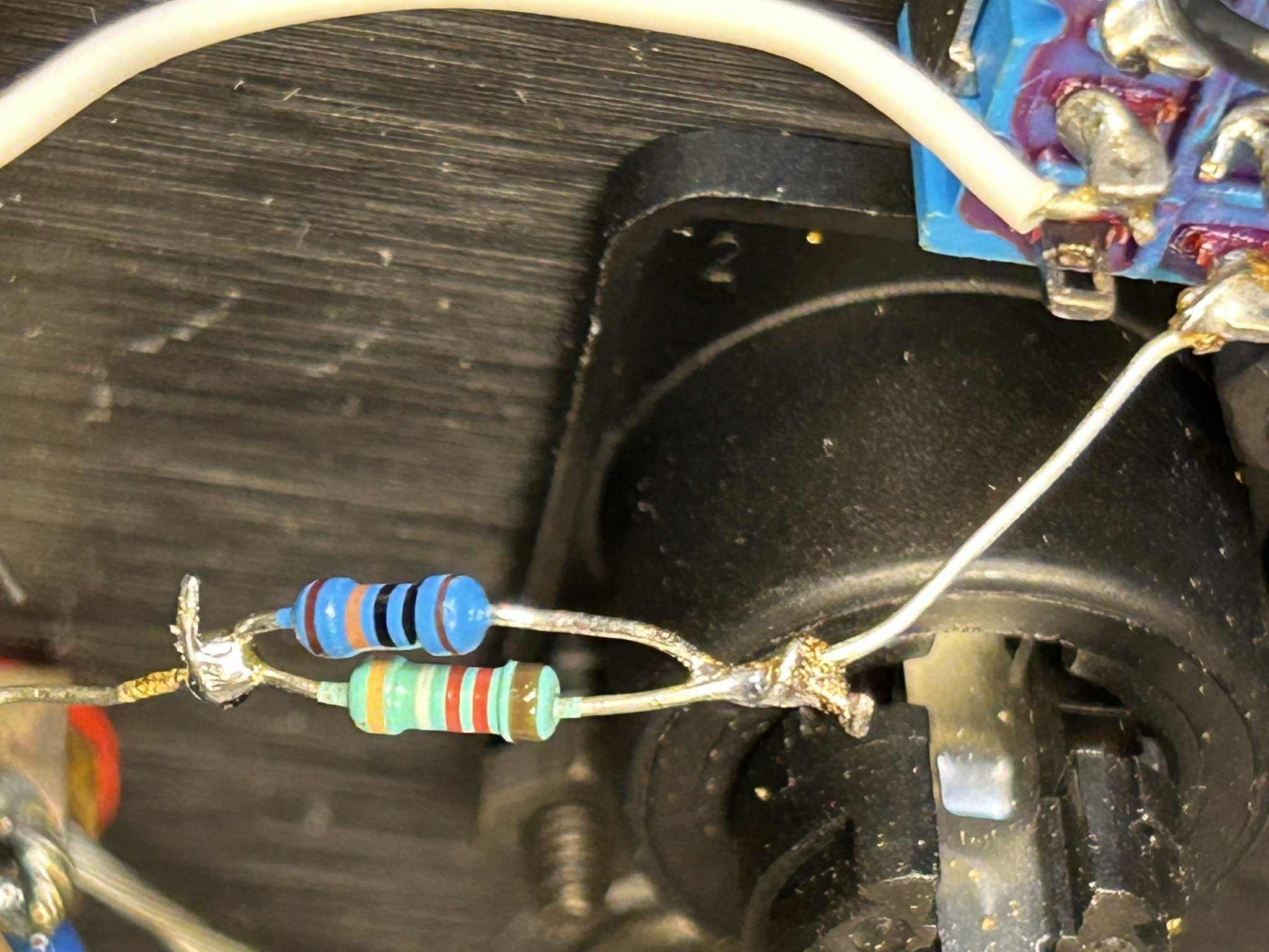

It always bugged me why the numbers I got from "Bridged Mono" as it's called on the back panel of the ACA 1.8 kit didn't match the numbers Nelson got when he ran an amp that he borrowed from Variac. See posts 8788 and 8810 in this thread. The numbers I got were from the ACAs I built at home on Vector Board running on a bench power supply.
Well, here's the story. Somewhere along the line R12 was changed from 68K to 39K. I know I was aware of the change, but might not have incorporated it into my builds. I don't think I used the extra 39K resistor that is wired to the switch on the back panel of ACA 1.8, I probably just stuck a trim pot in the circuit and tweeked it for a gain of minus one because looking at it with a scope, I could see the gain was off. Variac's ACA must have had the 39K. The 39K does not take into account the 10K R11 on the ACA circuit board. So the gain is less that unity by about 2dB. ( I used the math, not an actual measurement which will be lower still.) This means side A clips before side B with it's low gain. Just guessing, I think the resistor on the switch needs to be 24K to 27K.

The graph I posted of "Balanced Mono" THD and Balanced Drive THD is posted in post 7030 of this thread.
^ Nice! Thanks very much for sharing the details of what prompted the investigation, the work, and the fix.
I've never run mine in that mode or measured it, but for the 'price' of a 100k resistor from the stash, I'll go ahead and pop one in each of my ACAs before I forget.
Edited to add - Takes less time to modify two than the site allows for editing... See below. Not my finest work, but it'll do. Thanks again!

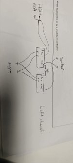

Looking into wiring up a pair of mono rca ACA in one chassis just a question on the wiring would for each channel have the output from one ACA board go to the input of the next with the output from the second then going to speakers?
Looks fine to me. This is the diagram I made.
@Loudthud posted a suggested update to that resistor value with some sound reasoning. I did it to mine.
Thanks @ItsAllInMyHead thats a great diagram much clearer. I will check out that thread for resistor values has there been any benefit by placing a pF cap across the resistor. Also for the output + are they just connected to ground in ur diagram.
