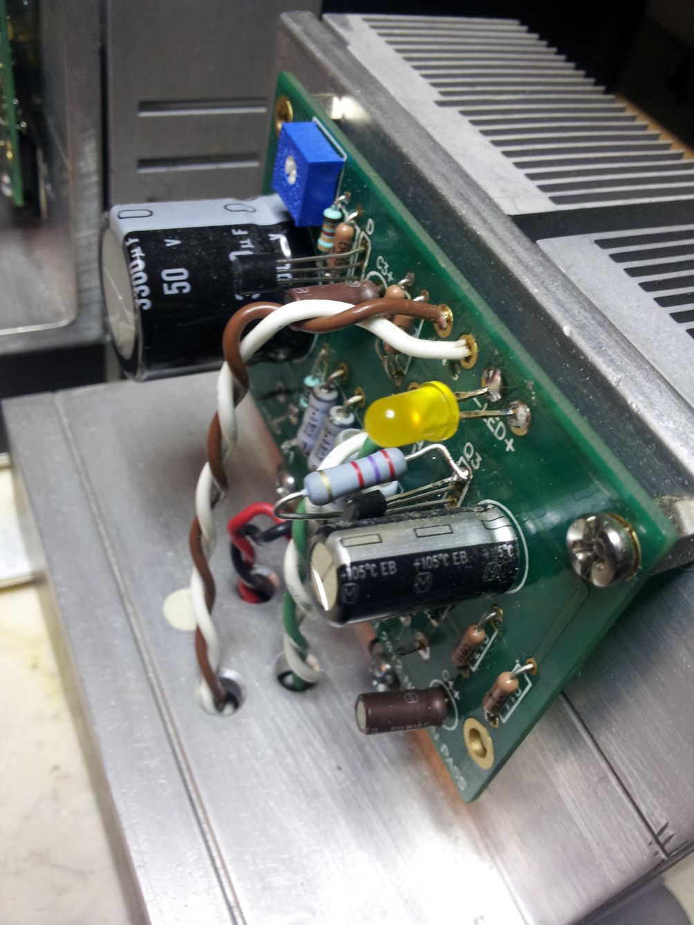

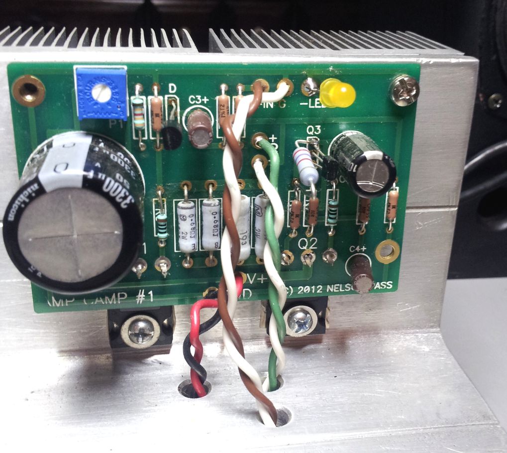

I'll get some matching Dales later, but this worked. Noticed something interesting though. With the new part the initial bias read 9.38. I got it to 9.98 and decided to turn on the other one for warm up. The bias jumped to 10.17 then settled back to 9.78. Probably no big deal but a bit surprising as each amp has it's own 18.5 Vdc power supply. Didn't think these were that sensitive to line fluctuation. I'll adjust to 10V with both amps on over time.
