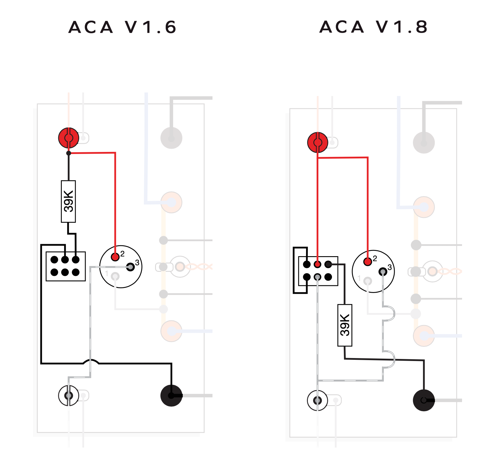

V1.8 builders - please note below the slight but important wiring changes between V1.6 and V1.8 and use the V1.8 wiring diagram.
