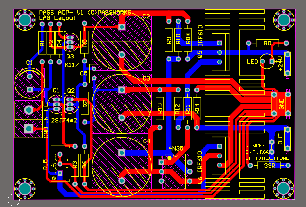

Nisbeth, if you decide to create (lay out) a new improved printed circuit board for the ACP+, including those two trimmer potentiometers you mentioned, please permit me to offer a couple of suggestions for additional modifications that you might want to think about incorporating:

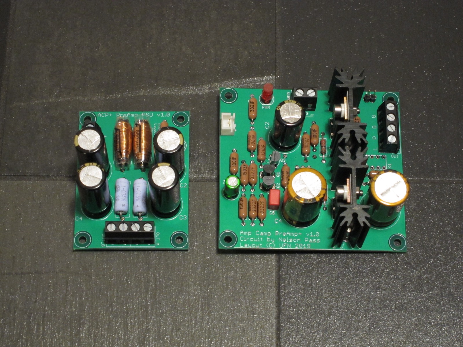

Well I did do a clone, but I didn’t really implement any of the things you suggested – sorry Mark 😉 Took a bit longer to arrive than planned because boards and parts were delayed, but now it is (nearly) completed.
Highlights: Amplifier boards are separate mono channels, PSU is a separate board and volume control is separate (offboard) as well. For the amp I’ve chosen a different heat sink profile, and also made some tweaks to the parts footprints in some places. Last but not least the headphone/line outputs are both on the board along with a tiny relay to allow switching between them.
I’m still missing the relays so no full testing yet, but the amp biases as expected and it plays clean audio – never a bad start 😊
Apologies for the crappy pic - this time of the year I'm only really home when it is dark outside

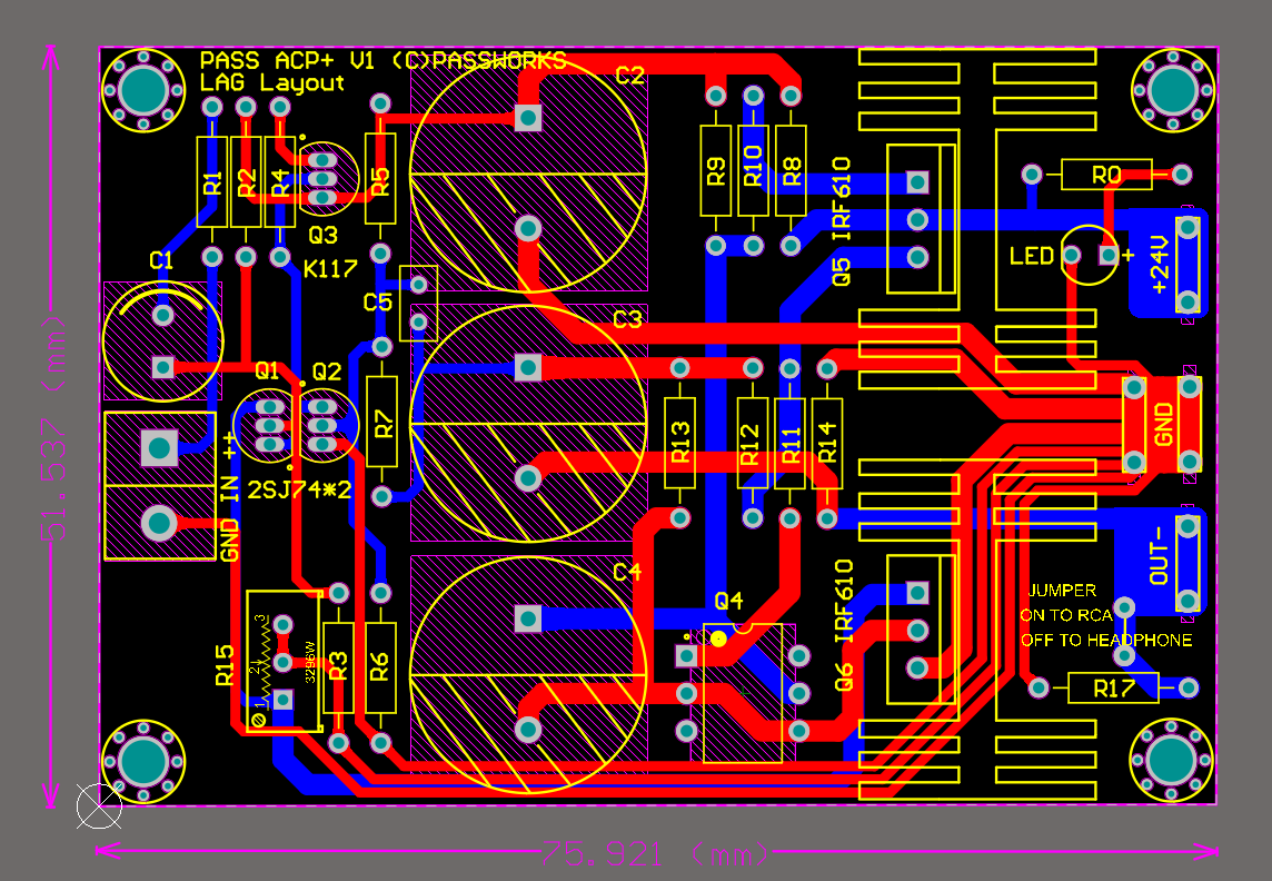

It would be great if this design was available just for the main circuit. Most of us can scrounge up a nice linear single rail power supply. But the main circuit is a miniature J2 which is in and of itself a pretty cool circuit. Given how the board is laid out, a Gerber layout of just the main circuit (mono or stereo) looks pretty straightforward, perhaps?

It would be great if this design was available just for the main circuit. ... a Gerber layout of just the main circuit (mono or stereo) looks pretty straightforward, perhaps ...
It's time for you to learn to create your own PCBs. The good news is, this is not especially difficult, and you don't need to be an EE with a degree to be successful. The software is free and there are three dozen PCB fabs that will build your boards at incredibly cheap prices; see pcbshopper dot com for hard data.
Here's a DIYer who had "minimal experience in electronics" yet taught himself to layout PCBs for his first-ever diyAudio project: an Amp Camp Amp. If he can do it, you can do it: post #6021. You've got much more DIY experience than him, and in North Carolina you have access to resources that are every bit as good as the resources he had in Pretoria, South Africa. If he can do it, so can you.

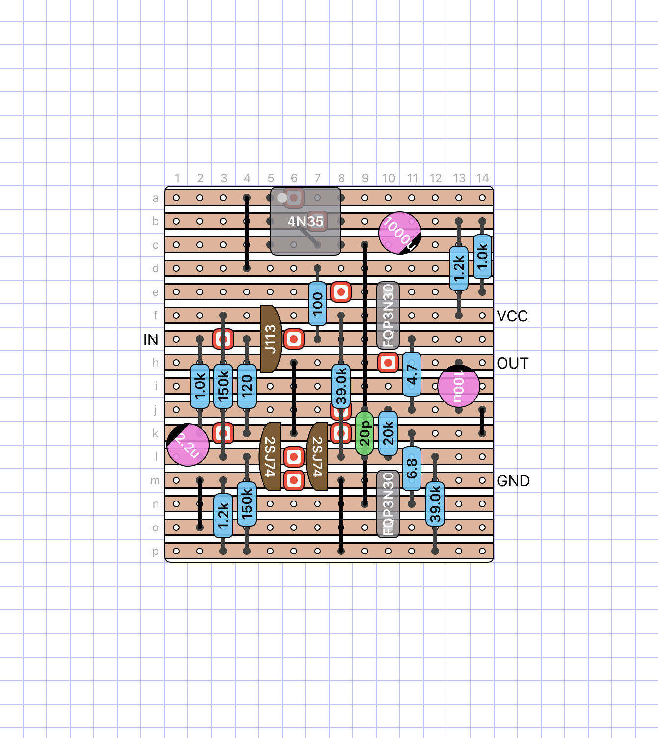

Or if your are comfortable working with Veroboard, you could build something like I have shown here.Sounds like it’s time to learn PCB layout!![]()
Breaking out what you suggest would be very straightforward...
I haven't verified the current source settings around the J113, and have used FQP3N30 output devices instead of the IRFP610. Note that the Mosfets are oriented opposite from one another. This is for the more intrepid amp builder for sure, but should be fun.
That looks super cool and fun to boot. Might be a good idea as a trial build to see if I like the circuit. Then transfer over to a fully designed PCB, etc...
