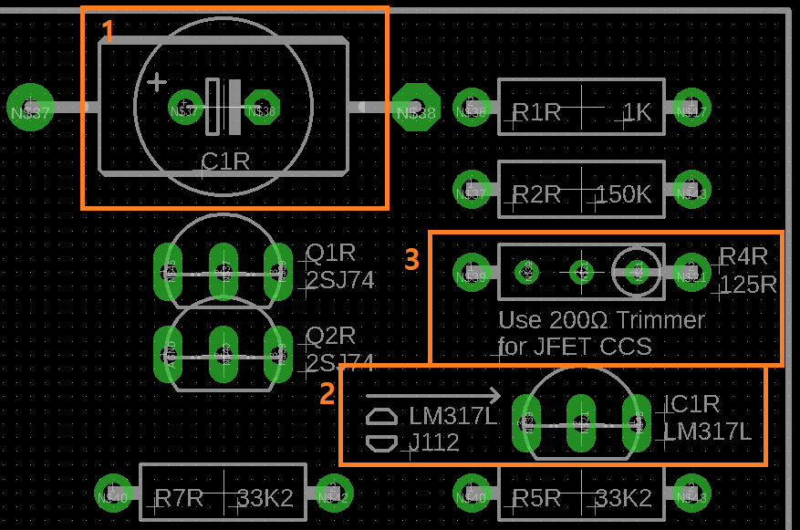

While I was building another ACP+, I had difficulty to get exact 10mA CCS with J113.
On-semi J113 with 121ohm only had 7-8mA, old stock Vishay J113 had only 5-6mA.
I do not think it is manufacturer dependency, but J113's Vgs/Idss spread.
Getting good combination of J113 and Resistor value will be pain.
I have updates on my ACP+ PCB design.
1. Both Axial and Radial Capacitor can be used for C1. (8mm diameter for Radial Capacitor)
2. J113 now changed to LM317L. J112 (J113) still can be used in reverse direction.
Note 125Ω for R4 is still valid for LM317L also!
3. Trimmer can be mounted in R4's place (3296W) when J112 is used for CCS.
Then the user can set exact 10mA CCS.

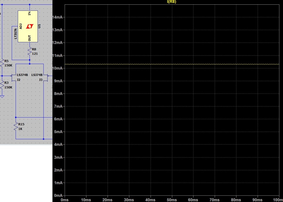

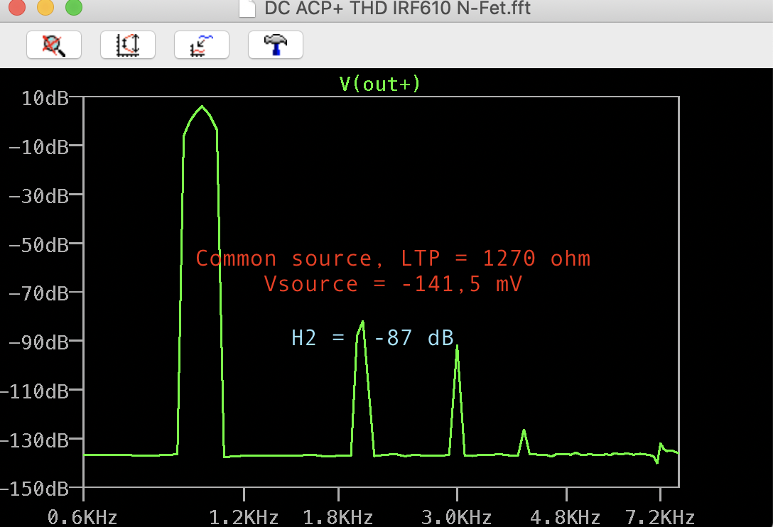

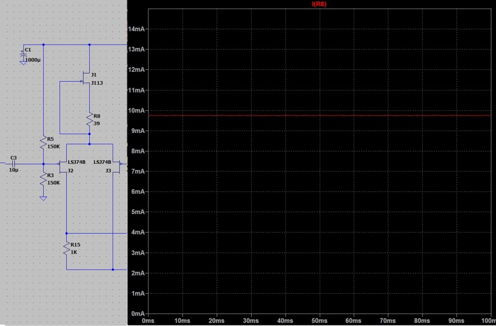

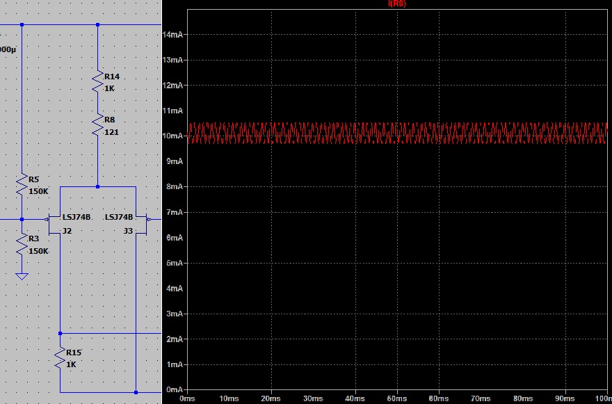

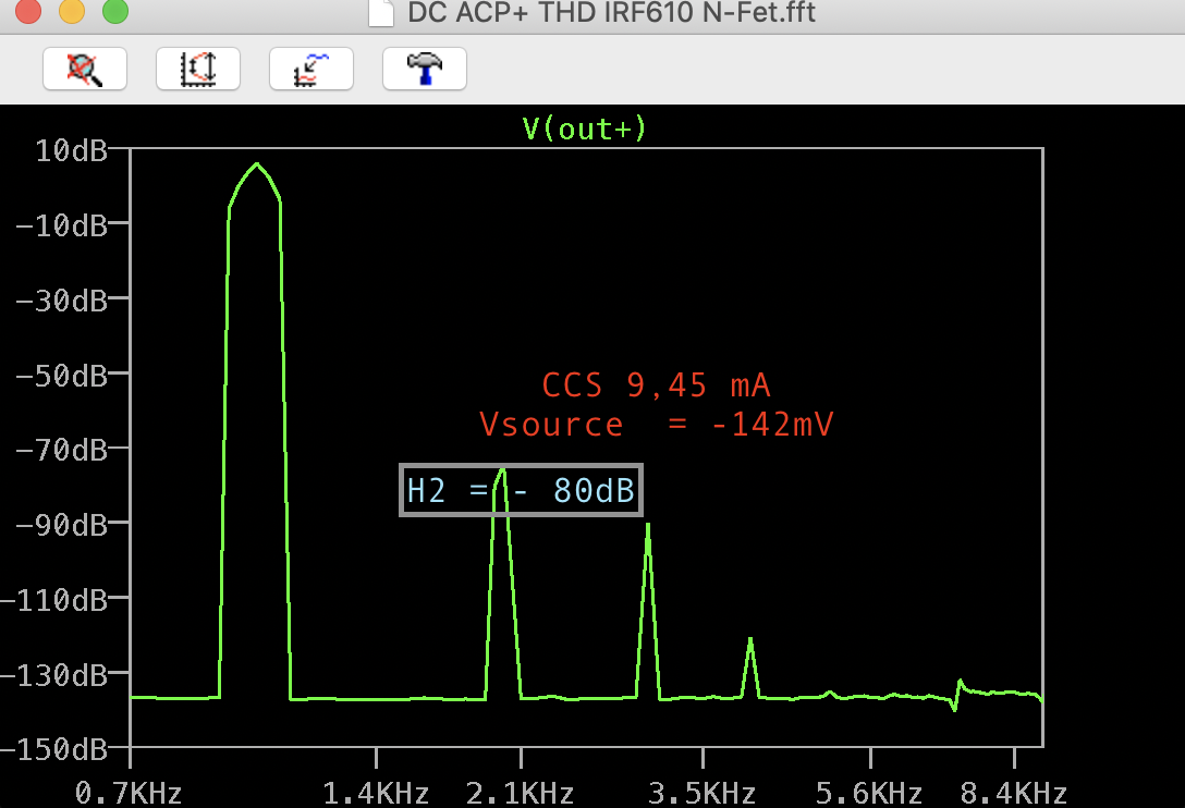

Why not use a single resistor, no CCS at all? Hiraga said that would give lower harmonic distortion, and so it simulates: 87 vs 80 db
![ACP+, LTP 1270 ohm .png ACP+, LTP 1270 ohm .png](https://www.diyaudio.com/community/data/attachments/787/787561-362ea0b7e60a97d3340a1268de05856b.jpg)
![ACP+, CCS 9,45 mA .png ACP+, CCS 9,45 mA .png](https://www.diyaudio.com/community/data/attachments/787/787569-bd02bf09bac7bf9fa6dc13edcd5af696.jpg)
Would there be a bloody difference in hearing?
[I don't know, still trying to get a PCB ; and working on an ACA for headphone right now]
Why not use a single resistor, no CCS at all? Hiraga said that would give lower harmonic distortion, and so it simulates: 87 vs 80 db![]()
I think you had better tell Nelson Pass quickly, that you believe he has made a mistake in the design of ACP+. Otherwise he might make the same mistake again.
Of course not ! I hold him in high esteem.
I am just playing around with what I have at hand.
I hope I'm not the only one here like that.

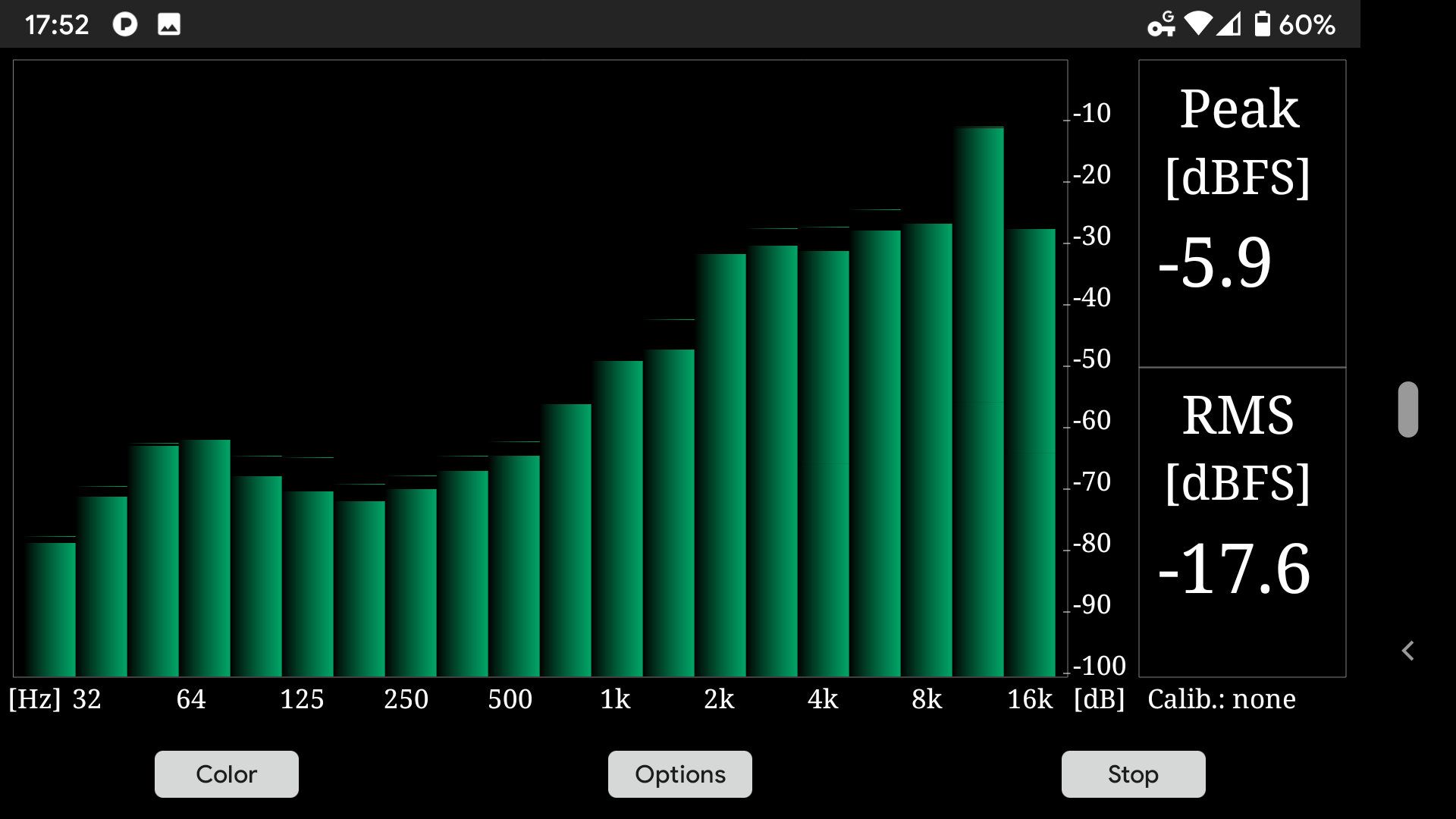

I have a question about what loads the ACP can drive.
I have a MoFo, and I'm experimenting with adding an Edcor XMS10k/150 transformer on the front end to step up the input signal. This works as expected with a Schiit Vali 2, but when driven by the ACP there's no bass. This is quite obvious when listening to music, and I double checked by playing white noise and sampling it with an audio analyzer app on my phone - photos attached.
To complicate things, I notice the transformer I received from an ebay seller (with a high feedback score) doesn't look quite the same as the one in the picture from Edcor - the bobbin on mine is white, while Edcor explicitly calls out theirs as blue. Even if I did end up w/ a counterfeit ($15/ea), I don't think that would explain the performance difference between the two pre-amps. The DC resistance I measure on the two coils is 63R and 490R, with the pre driving the lower one.
I tried adding some resistance (>1000) in front of the transformer to bring the load seen by the ACP back to its preferred 33R, but that didn't seem to make any difference.
Does anybody have any idea what might be going on? I would much prefer to use the ACP over the Schiit.
