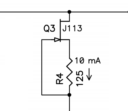

How is the J113 selected for the CCS of the input stage?
When I read the datasheet J113 has a min. Idss = 2.0 mA. Those can't be used as a 10 mA CCS? …..you need one with a bit higher than 10 mA Idss? …..are there many of those among J113 in a batch?
J112 has min. Idss = 5.0 mA so some of those could also be used?

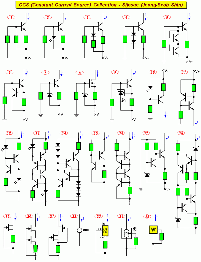

Use J111 or whatever jfet that will do the job.
J111 has Idss of 20mA then you degenerate with source resistance to get 10mA.
Papa is using 125 ohms to degenerate.

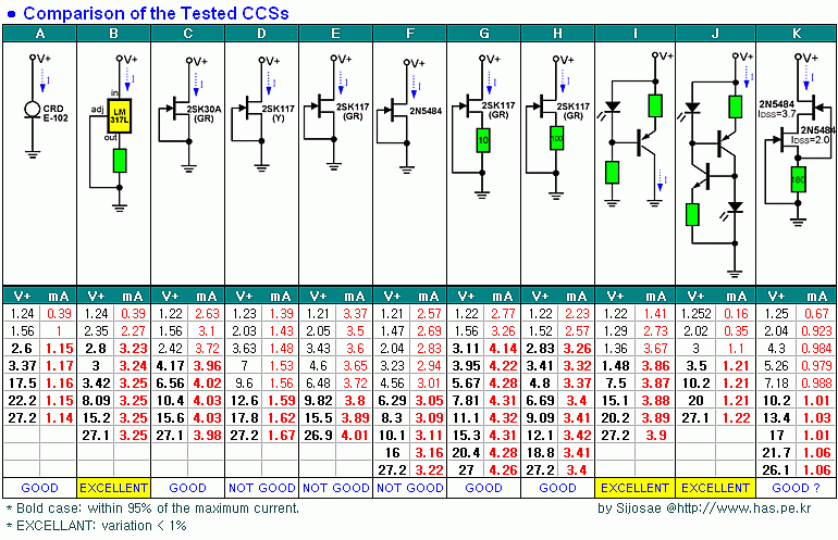

For those who are unwilling or unable to buy a handful of J113s, and make the necessary measurements to choose the right resistor values which create two 10mA current sources ...
I'm curious to know: how much would you pay "punkydawgs" or "fetaudio" another seller, to do the work for you? You pay him money and he sends you two little ziptop envelopes, each envelope contains 1 JFET and 1 resistor. Each envelope creates a 10.0 mA (± 5%) current source?
