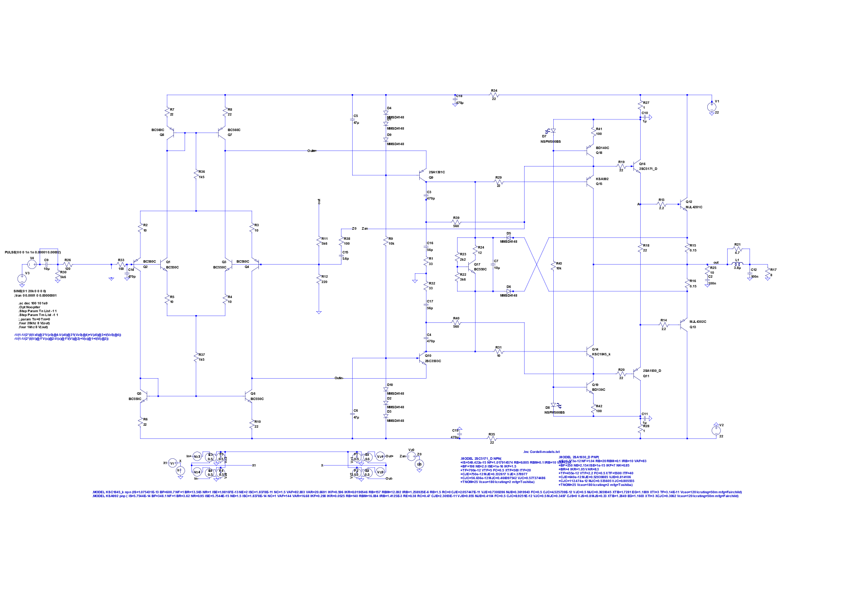

Amp designed during lunch breaks
Like the idea of the Cherry recommendation of running the power rails down the middle of the PCB. That way you can avoid all the sensitive electronics being inbetween the main sources of interference.
That's the kind of stuff I meant, most people just blindly place the rails to match the schematic. NOT optimal
Have to take a closer look. Don't have too much GM to play with...
The extra zeros from the capacitors do interact with the other compensation.
I don't yet have an analytical solution for the optimum, so it's iterative.
I would try to reduce the shunt stuff across the input.
There is no shunt in my own test-bed amp.
I first optimize the main feedback loop zero (from the capacitor).
Then tweak the LTP and Current mirror capacitors to try for whatever improvement I can.
But then re-experiment with the main loop.

Sounds like a plan. Although in this amp it appears to be the shunts on the VAS output that dominate and the main loop compensation seems more like a fine tuning tweak. Maybe I should start again using your methodology and see where I end up.
When you say reduce the shunt stuff across the input do you mean C1 and R1?
I have simulated this and it did not work as well as I expected.
Those expectations were not just hope but based on simple theory, apparently TOO simple.
The unexpected bit was a result of source resistance, not revealed if one just tries an OPS driven from an ideal source.
Yes, but I would try to reduce any shunt compensation, why waste gain?
But sometimes one just has to burn some off, the AD797 seems to work OK😉
Here it may be the shunts on the VAS that you mentioned.
This is an effect of classic Two Pole compensation that is often not considered.
I think it explains why sometimes TPC is hard to beat.

This amp is VERY sensitive to changes in C1 and R1.
When I look at TPC I see a shunt to GND is this a valid way of looking at TPC?
I think we are close to the limit though with this compensation unless some transistors are changed. The LG plot shows a pole at about 20KHz this appears to be a limitation. Most likely the output transistors? Changing the shunt compensation does not improve this.
So I shall try again using your methodology. I believe there is still more to be had from this design.

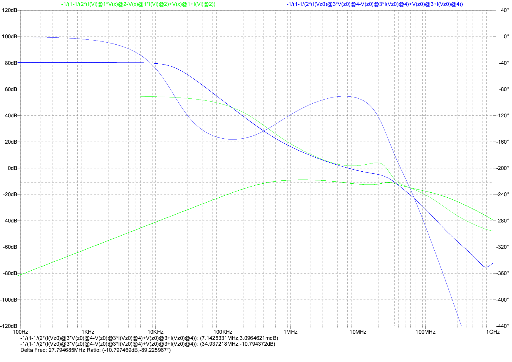

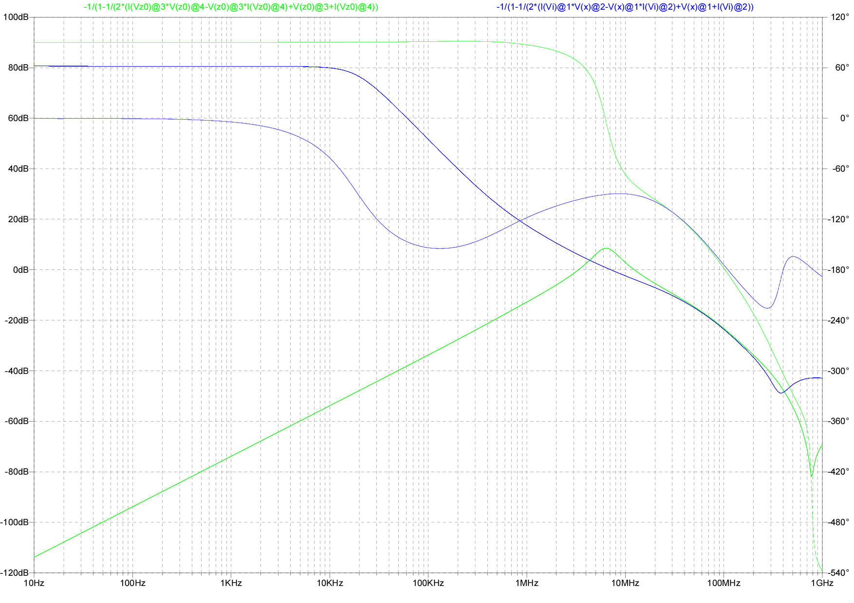

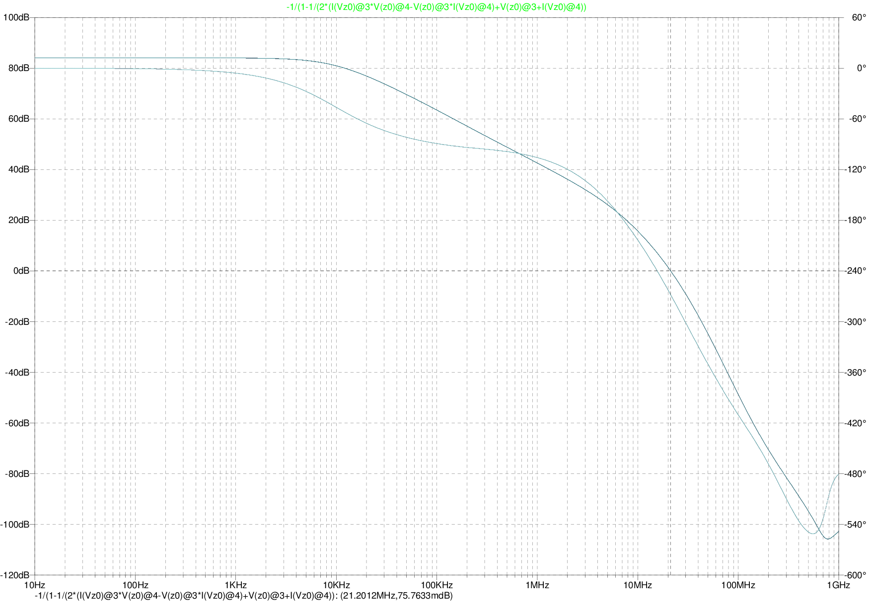

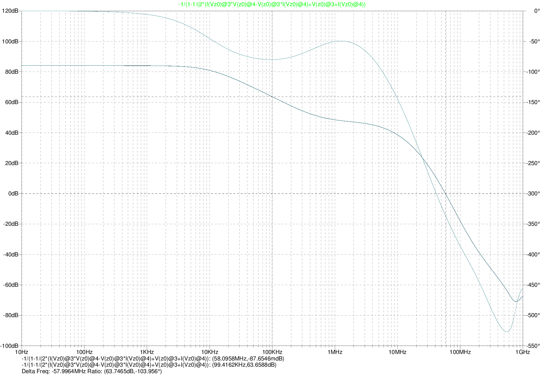

Optimisation - 2nd Attempt
Hi David,
Have started the re-optimisation of this amp. The first stage has been to try and improve the open loop gain. All compensation has been removed. Here are two loop gain plots. One (hopefully) is the open loop gain and the other shows the effect of the capacitor across the feedback resistor. It does not look like this capacitor is the dominant part of the compensation.
Looks like the shunt compensation is the dominant part of the compensation for this amplifier.
Is my logic correct? 😉
Paul
...But is this bootstrapped shunt compensation on the VAS output actually a form of feed forward?
I don't think it is of importance here but you can check.
You can place the balun connections to see if there is any relevant feed-forward.
This would be in series with R39 and R40.
I have tried this on other amps and sometimes been surprised.
Classic Hawksford Error Correction does have major feed-forward.
As far as I can tell the classic analysis is seriously inaccurate because this is not considered.

I think you are correct that the dominant factor in your simulated compensation is the bootstrapped VAS shunt.
Kind of TMC shunt.

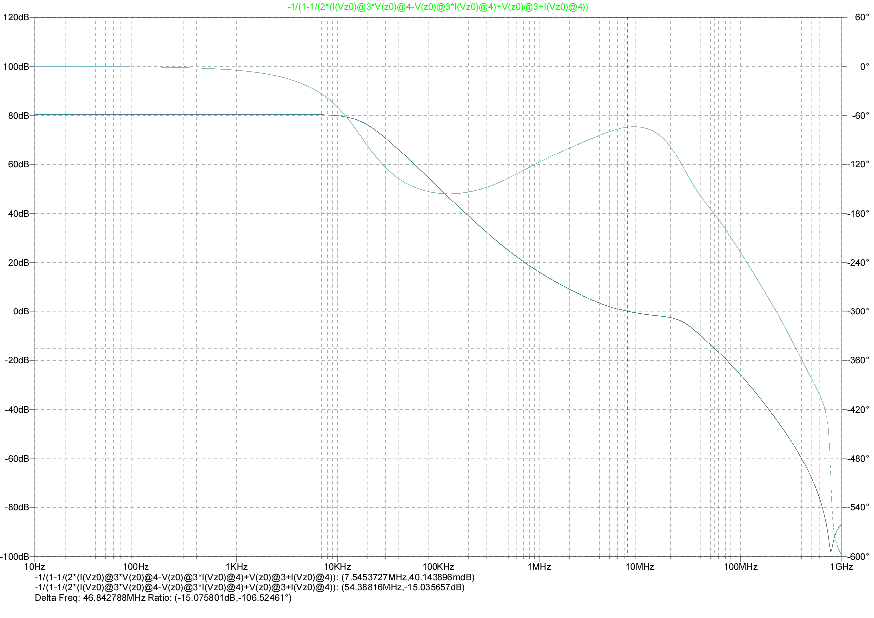

Hi David,
In the interests of science I have tried this on last night's re-optmisation. It looks strange as a compensation system but sims almost too well.
ULGF = 7.1 MHz
PM = 89 degrees
GM = 10.8 dB
See loop gain plot...
Also note the apparently incorrect by normal theory shunt capacitor values... 330pF bootstrapped by 680R from Predriver...??? Off a cascode VAS??? 😕
Is it worth a risk in reality? 😉

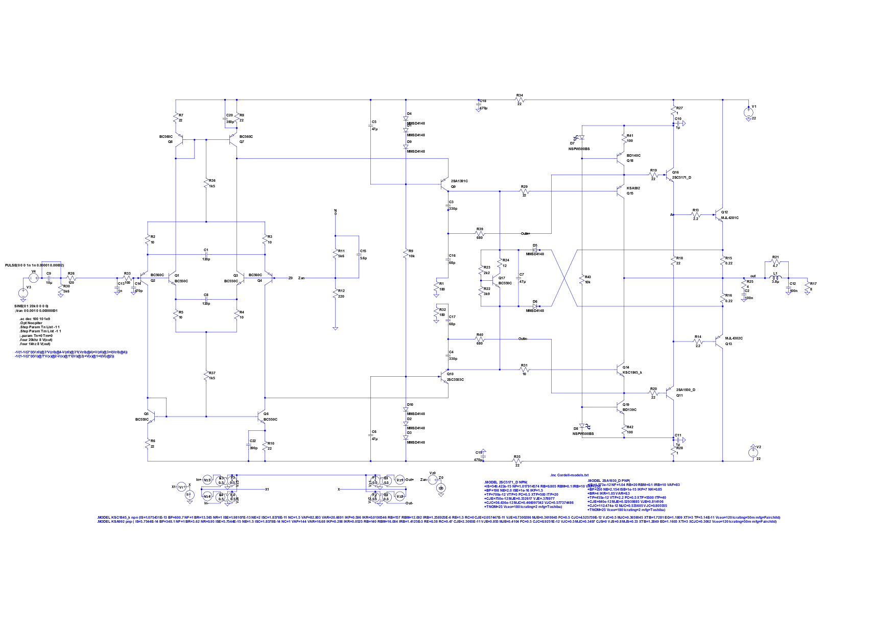

And again we come round to the GFT Probe... 🙂
Suppose it's ineviteable when we both have a common interest in the control loops of amplifiers.
Kind of TMC shunt.
Think it is really just a specialised two pole shunt. I'm thinking this isn't feedforward but just shaping the shunt response to compensate the amplifier (hopefully) effectively.
Have attached the usual various items for your (and others) perusal. 😉
Paul, David - sorry for a "side" question - however, it is somewhat related to the point.
What do you think about the phase response curve "recession" - in this case at around 100-200KHz, pretty significant one (just some 22 degrees above 180 degrees phase "inversion")? In my designs I'm trying to arrange compensation in a way that it keeps the curve rather horizontal before it finally falls to 180 degrees crossing (at 35MHz in this case).
What do you think?
Thank you,
Valery

This is typical for two pole compensation.

Hi Valery,
Side questions are fine in this thread. 🙂
Thank you for taking interest.
My personal thoughts on your question. Please bear in mind I'm still only a relative beginner in amplifier design.
This phase dip is caused by two pole compensation and the depth of the dip depends on how aggresively you use the two pole compensation.
22 degrees is quite tame for me. I find 10 degrees is enough. Even when transfered to prototype.
Sounds, to me, like you are desiging using single pole compensation. Or very tame two pole compensation?

Thank you guys for clarification.
Paul - I use two-pole in some designs. In one of them - phase margin is around 78 degrees, dip goes down to 45 - I have left it as is. In the other one (CFA) - I have tamed it almost completely up close to the margin level.
So, I was curios, if it's really worth taming it... looks like - I can relax 😛
Thanks again,
Valery

...What do you think about the phase response curve "recession" ...
... dip goes down to 45 - I have left it as is. In the other one (CFA) - I have tamed it almost completely up close to ...
As Damir, Paul and Edmond have already written, this phase dip is inherent to Two Pole.
It is not just unavoidable but actually part of the process.
There is a conservation law for total Phase (when expressed in the correct way with the Gain)
So if we want more PM at the Unity Gain Frequency then it must come from somewhere.
So we push down the phase far away to have more to "spend" where it matters.
If you "tamed" this phase dip then you defeat the entire point of two pole compensation.
And the only way to reduce the phase dip is to eliminate the second pole.
So it turns back into ordinary, dominant pole compensation anyway.
The trick is to know how to distribute the phase.
A phase of -180 (or even more*) is quite OK far from the ULGF but more of a problem as it becomes closer.
This is not so clear on a Bode Plot but easier to see on a Nichols Plot because Nichols has lines for equal Phase/Gain trade-off.
I think LTSpice can be made to show Nichols Plot but I haven't done it yet.
Maybe your simulator can?
Best wishes
David
* If the phase in the dip exceeds -180 then there is "conditional stability" in the strict, Nyquist sense of the term.
This sounds bad but can be perfectly acceptable.
It is not really necessary for an Audio amp so I prefer to avoid it.
I do, however, try to have the phase drop down fast as the frequency increases.
This depends on the Q of the two poles.
There is little analysis of this except by Dennis Feucht and his work is not quite accurate, omits effect of output load.
Any help appreciated!
Valery, you can relax. If you let the dip go below 0 degrees then you are then in the realms of conditional stability though.

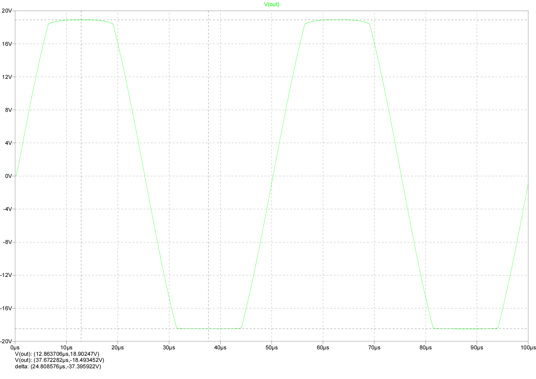

That OPS stage just happened. One thing concerns me is high frequency feed back through the collectors of the pre drivers. Do think a high frequency filter would be worth having. The price being paid is performance though. What do think?
One last bit of fun for today... The MIC version. Can it be done without a proper PCB?
Here it is...
ULGF = 7.5MHz
PM = 106 degrees (I think-plot attached anyway 🙂)
GM = 15 dB
Paul

David,
Could the "MIC" loop be feed forward? It has a gain greater than one at the frequencies that matter.
Hope the V(z0) probe is in the right place?
As you can see I stripped out the front end... Didn't see the need, already had plenty of PM.
Paul

Now it's perfectly clear...many thanks
A pleasure.
You do like circuits with multi-way feedback connections (to the VAS, to the Input and to the OPS) that really make me think😉
But am relaxed about this one because the response in this loop is "textbook".
In particular, the phase looks pleasantly understandable, just simple minimum phase.
We know that feed-forward can potentially produce RHP zeroes, in other words "excess phase", in the strict use of the term.
So if there is no evidence of excess phase then I assume the feed-forward is so small that a simple analysis is fine and the complication of a Middlebrook GFT analysis is not needed.
On your post #48 you showed the shunt VAS loop to look for feed-forward there.
I think there is just a trace of non-minimum phase there, based only on visual estimate.
A second "To Do" is to work out how to plot excess phase in LTSpice.
In this case not critical because the loop gain is always small.
We learn about some loop no matter where you put it.😉
Yeah! My own development example has MIC and no front-end shunt.
So my recommendations naturally tend to lead in that direction.
But I hope you will find that it does perform better on objective metrics.
That would confirm that it's simply a better idea and not just my prejudices that have mislead you.
Best wishes
David
