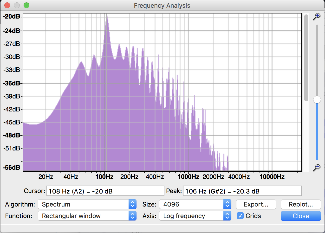

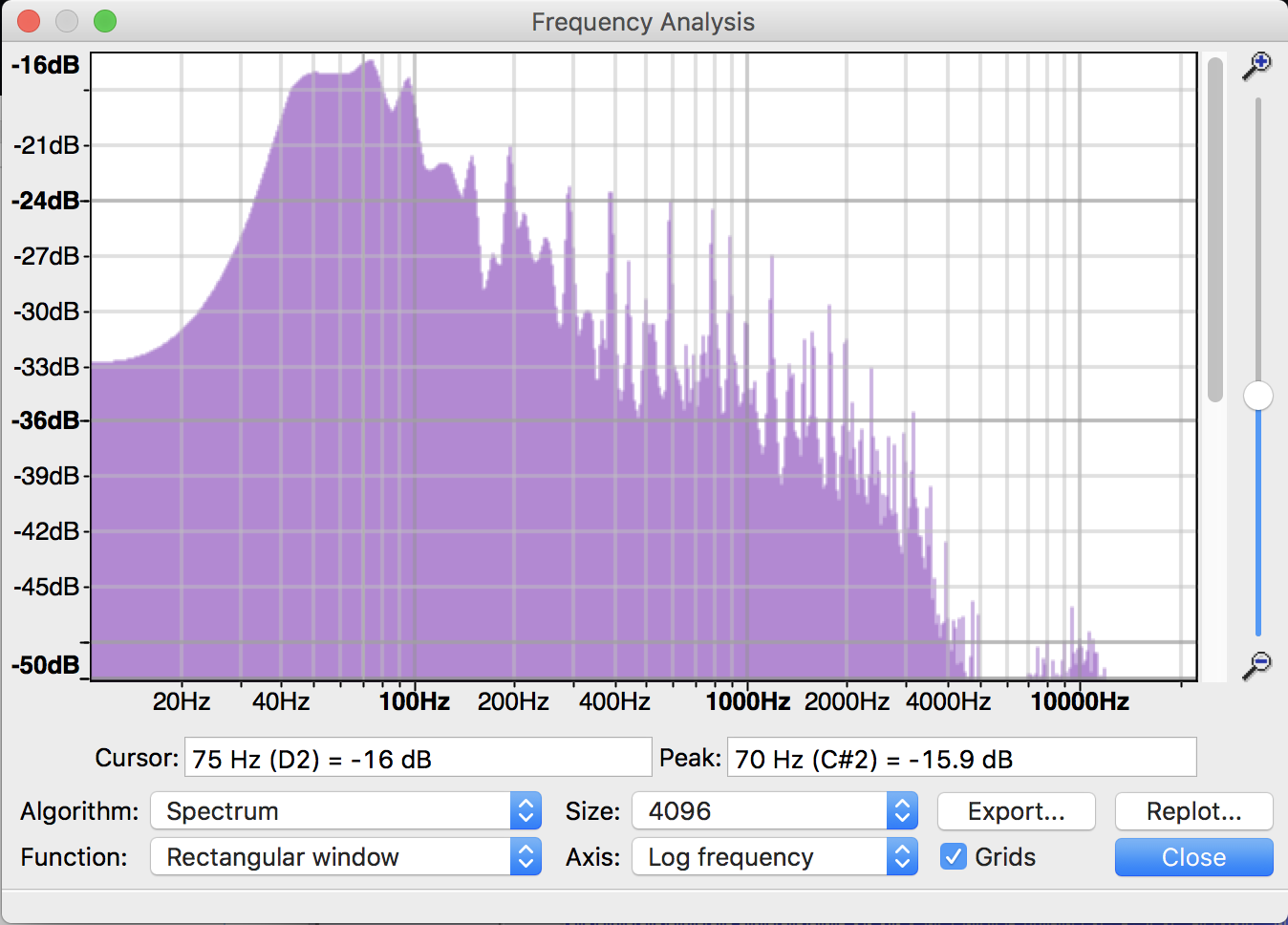

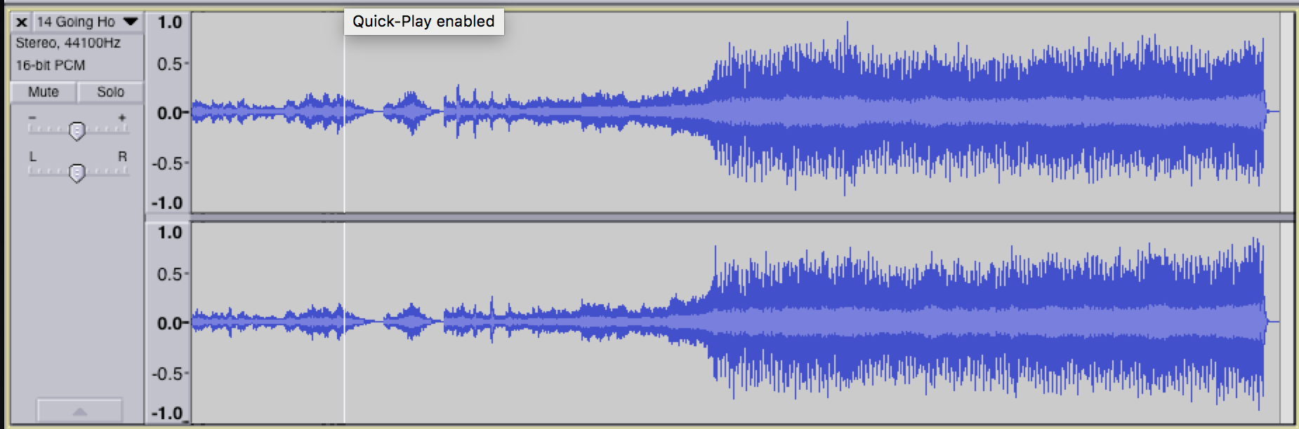

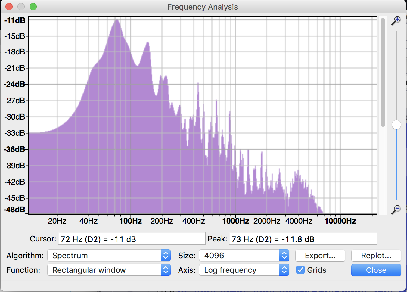

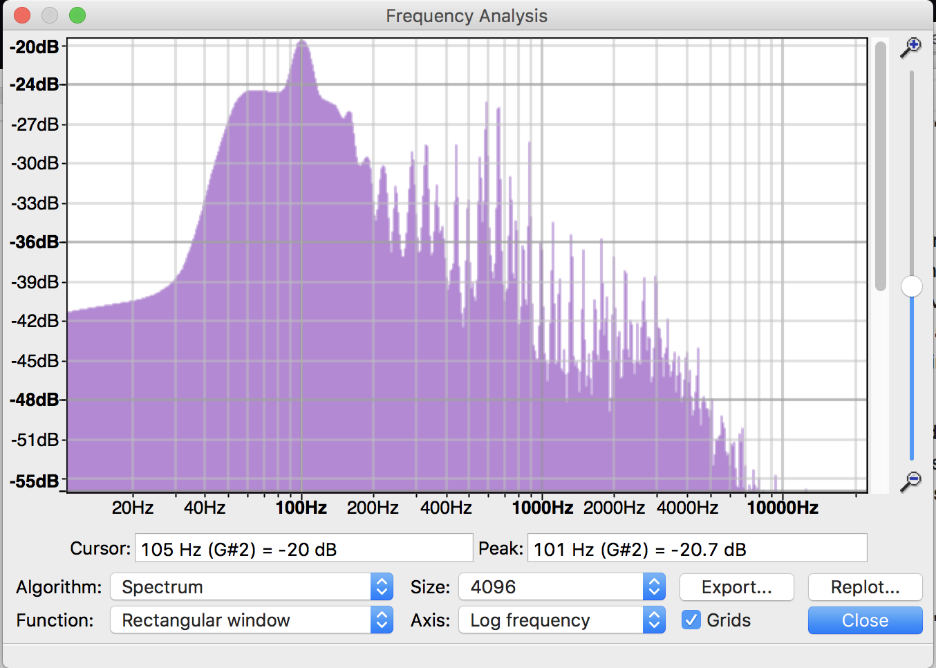

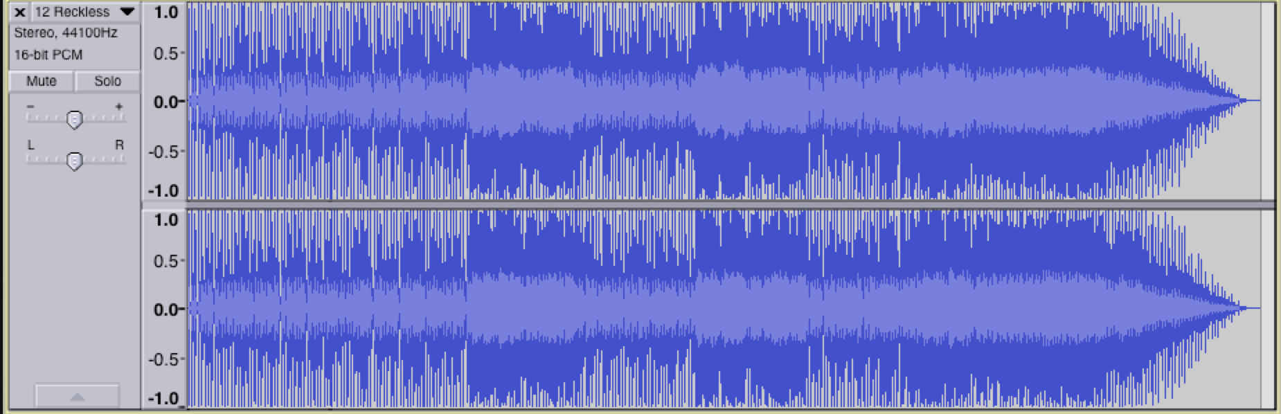

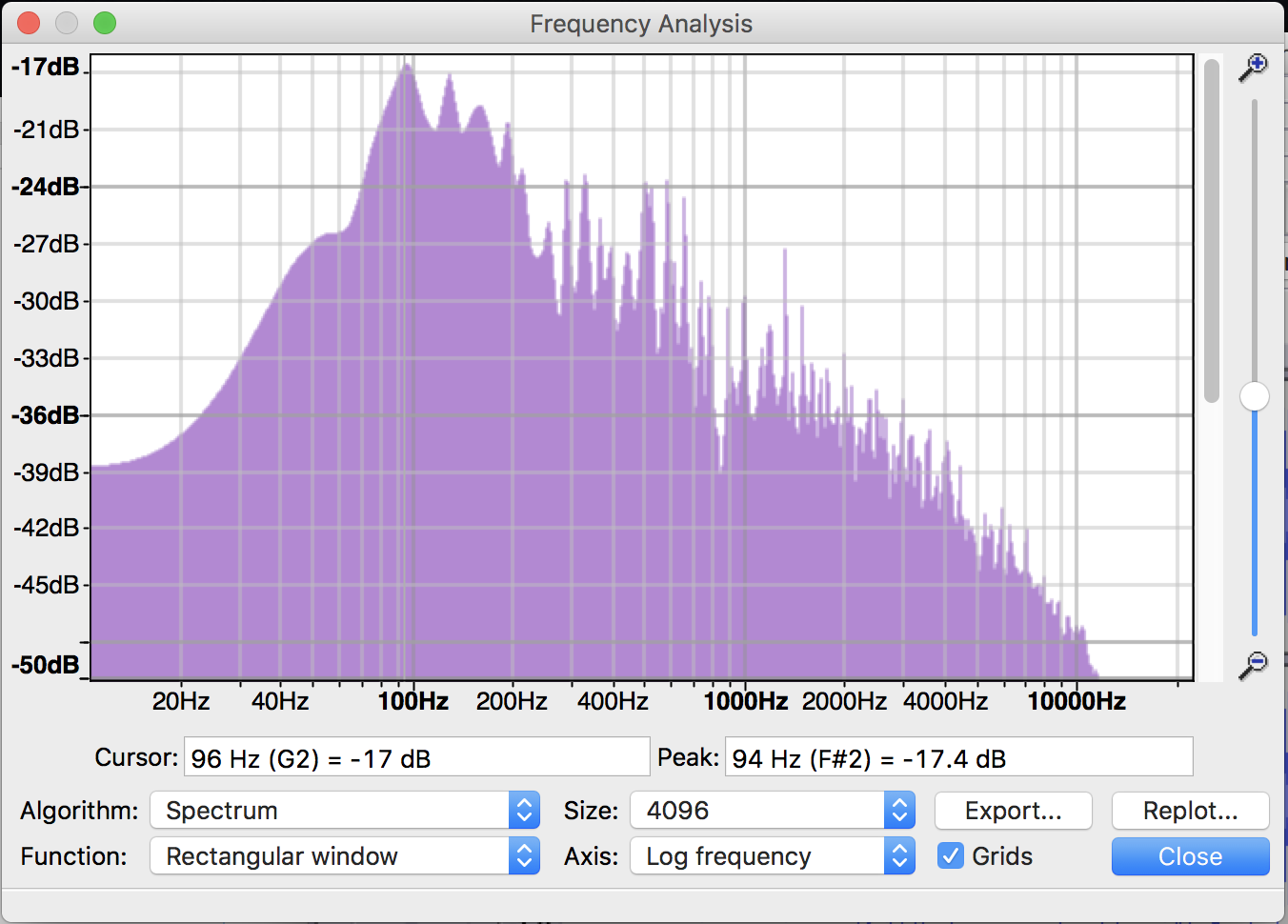

I've just gone through a bunch of my favourite tunes (FLAC copies from CD source) with Audacity, and didn't find a single example where the peaks above 500Hz were above the peaks below 500Hz (24dB/octave filters).
I was trying to be representative of the different styles of music I listen to, so looked at various very different tracks:
Elton John: Benny and the Jets.
Aussie Crawl: Reckless (don't be so).
Alanis Morissette: Hand in my Pocket.
Simon and Garfunkel: American Tune (live).
Mark Knopfler: Going Home.
That said, I have overstated the amount of energy in the bass section - with the exception of live music (nothing at all after 1KHz - no wonder it's good to listen to in the car), the difference between woofer and mid is only about 6dB, not the 10dB I was assuming.
Plots attached.

Interestingly, the tracks that I've found where the 500Hz high pass has absolute peaks close to or equal to the low pass (a good example being my recording of Reckless) are badly mastered to the point of clipping at the source.
My Knopfler stuff appears to be some of the best mastered source material I have.
Ah, here's my domain! :-D I'm a recording engineer by hobby. It may look clipped in your screenshot, but it's probably not (unless you can actually hear the clipping distortion). It's hit hard with a limiter; all the peaks are basically the same volume, which gives it the appearance of being boosted past clipping.

Well... When you consider the midrange unit has the same 10ms power rating, but a 3" voice coil (compared with the 1" tweeter voice coil), it makes me wonder if that's a real power rating, or something they made up.
A "100 watt RMS" rating on a hi-if tweeter is often "100 watts noise power", filtered at some frequency/slope. The average power reaching the tweeter is low. A 1 inch VC can handle about 6 watts of average power. One with a sophisticated motor (i.e. Scan Speak, Morel, etc) can take about 10.
And that difference between 6 and 10 watts is huge when it comes to how loud it will play before the smoke comes out.
OK, so to get back to the original topic... Would an acceptable amp arrangement for these speakers be all P3As? From all the other posts in this forum about the amp, consensus seems to be that it's very good, but maybe slightly harsh on top (with others saying it's not harsh on top, the listener was just used to a duller-sounding top end).
100w to tweeter, 100w to midrange, and... Either 100w to both woofers (2x 8 ohm version in parallel), or 100w each woofer (2x 4 ohm version driven independently).
