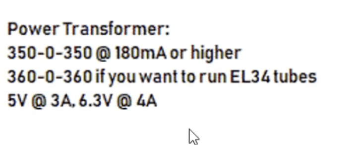

I am sticking with the original design which calls for an output transformer of:
25W, SE OPT - 5K with 43% screen tap
And power transformer of either:
110/120v primary and 760v w/ CT (360-0-360) at 180mA, 5v at 3 amps and 6,3v at 4 amps secondary
110/120v and 760v w/ CT (380-0-380) at 200mA, 5v at 3 amps and 6,3v at 4 amps secondary.

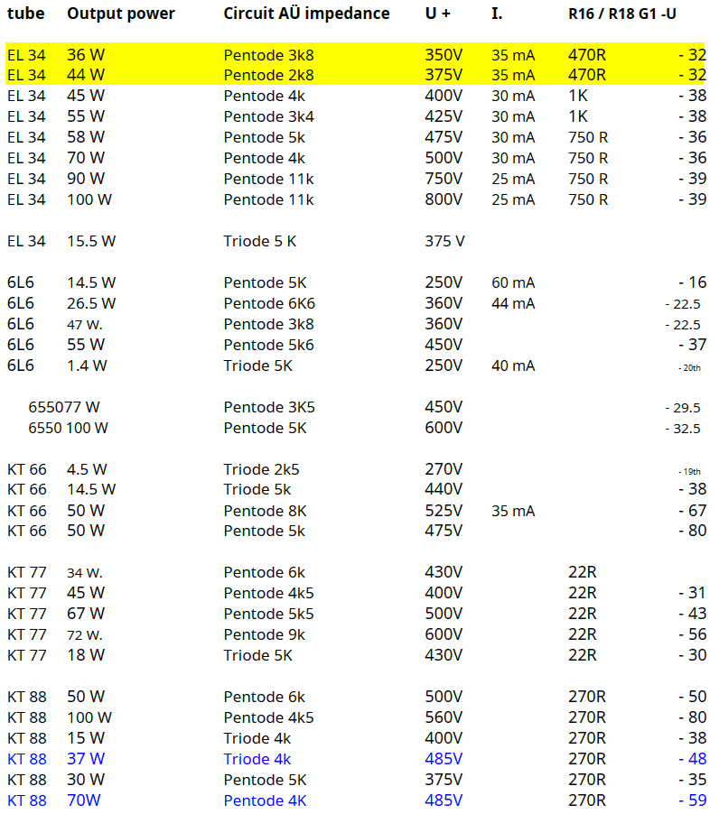

I been doing a lot of research and found multiple sources which say the Kt-88 can be replaced by a EL-34 or EL-84. Turns out the EL tubes are European and absolutely love the sound of the Telefunken tubes in my consoles. Looking into the sound difference, it describes the American sound versus the British/European, I now have words to describe my preference for the latter. Plus, what is the point of the KT-88 if sounds like SS? Even better, they cost less.
As I understand, eight to 10 watts is about right for the system.
As for SET and triode PP, have read a couple sources saying the latter is more dynamic, is this correct?
That's certainly incorrect. Where are you finding this information?I been doing a lot of research and found multiple sources which say the Kt-88 can be replaced by a EL-34 or EL-84.
Definitely not EL84's. In a conservatively biased single ended amp you can certainly run the octal tubes listed in the video.Jeff, a couple of forums plus this:

Analogies:
KT150 . . . Transmission for a 1500 Horsepower dragster, it has to work for 6 seconds
KT88 . . . . Transmission for a 500 Horsepower sports car
EL34 . . . . Transmission for a 300 Horsepower family sedan
EL84 . . . . Transmission for a 120 Horsepower gas saver city cruiser
All those tubes, cars, and all those transmissions, work extremely well when used at the limits they were designed for.
The tubes sound great, and the cars get you to where you are going (well, the dragster is lucky to finish the 1/4 mile).
Many amplifiers use the output tubes at 50% to 100% of their maximum power capabilities.
Some guitar amplifiers use the output tubes at 150% of their maximum power capabilities.
You can use the KT88 in a circuit that is designed for an EL84 (with some adjustment of part values;
And Caution: the KT88 filament is 1.6A, the EL84 0.75A, add another 6.3V filament transformer).
You can Not use the EL84 in a circuit that is designed for optimum KT88 performance.
Some amplifiers are designed to work with anything from an EL84 to a KT88 (different sockets).
Plug and Play.
But those amplifiers will not have optimum performance; for most of those tubes, or even for all of those tubes.
The only way to make an audio amplifier with a single EL84 put out 10 Watts is to use the EL84 in switch-mode of a Class D amplifier.
Note: the output powers in Post # 36 is for Push Pull.
Those tubes will not even get 1/2 of that power in single ended (at least not without being at clipping levels).
Have building and listenting!
