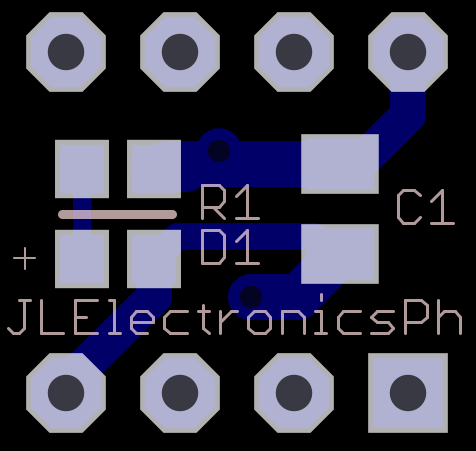

I will include OPTION C - with OPA1656 opamps probably 1st week of November. I designed a SOIC8-DIP8 adapter (with bypass cap and green LED underneath the adapter PCB lol).
Lester, why the need for the bypass cap (possible oscillations? Just noise?). Which op-amp pins?
Regards, Pete
D
Deleted member 148505
Regards, Pete
In my experience when a DIP-8 socket becomes loose after you do opamp rolling, sensitive opamps tend to oscillate (I experienced it with Myref-rev C LM3886 boards) I prefer the opamp to be directly soldered on the PCB.
There's plenty of real estate under the PCB so might as well add a bypass cap and a LED light. Pins 4 and 8. They are not soldered by the factory so you can opt to get the adapter with only OPA1656 installed.
The adapter PCB, the pins, and the DIP-8 socket are all gold plated types to avoid corrosion. Can't settle for less.

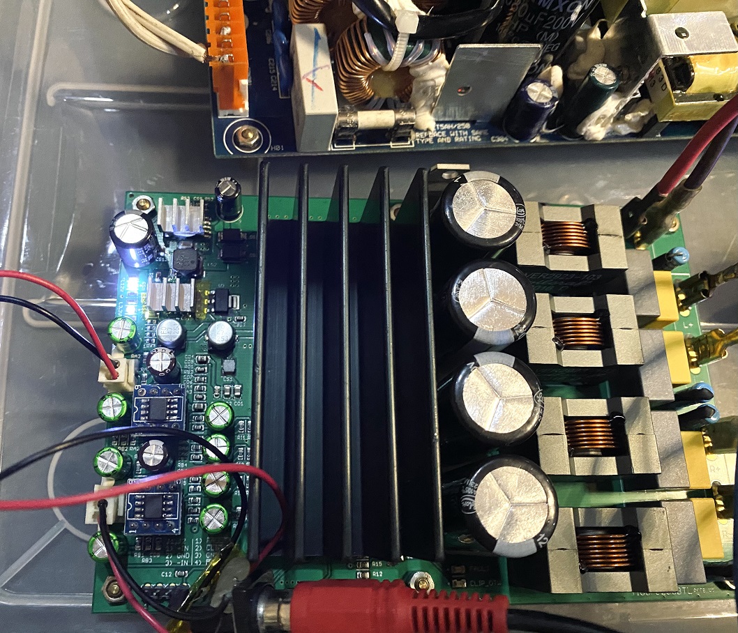

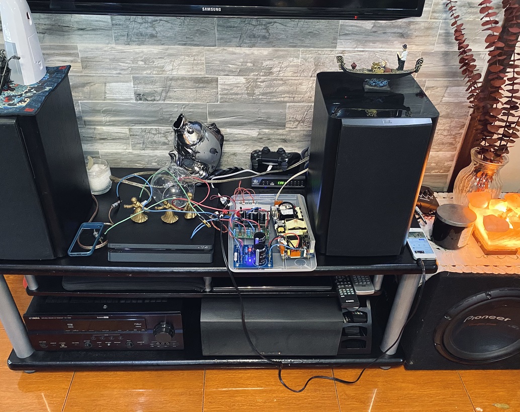

I'm comparing the sound of PFFB and non-PFFB modules.
PFFB with LM4562 is a bit laidback sounding, also has great bass control, I can also hear more voice's echo and noticed some voice separation, I can now identify the timbre of 2 singers blending. I will test it with OPA1656 later.

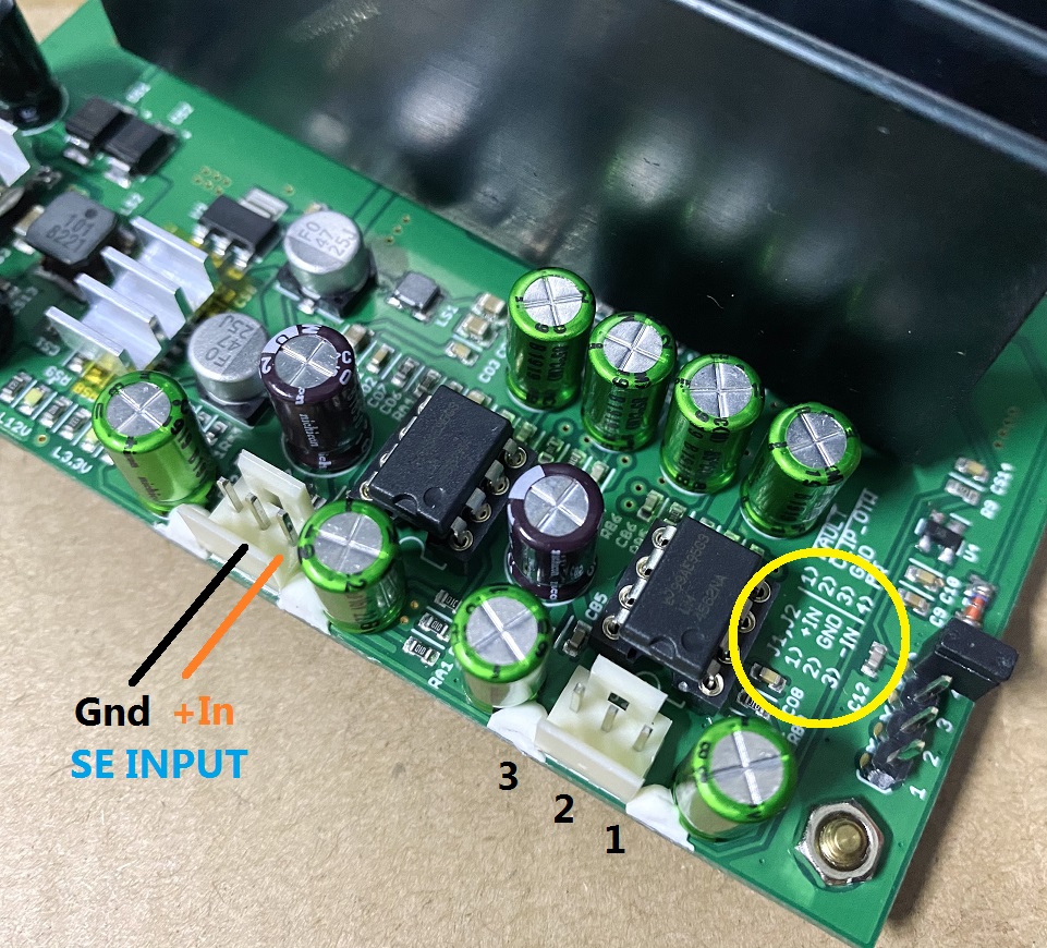

@JLesterP , the option for SE/BAL inputs is selectable via connector pins ?
No it doesn't have a jumper pin for selection, option for SE/BAL inputs is being set by solder jumper under the PCB. (putting a solder blob)
