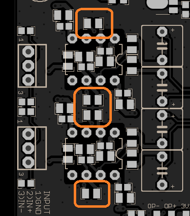

I have changed the input stage design on the upcoming Sylph-D400 (all SOIC ICs, separate gain + buffer stage, 4 layer design on the whole board), now the total gain is 16dB (6.3x voltage gain) so that a 4Vrms input signal can drive the output just below the clipping point. (ETA 3-5mos)
Presently for Sylph-D100, the buffer's gain can be reduced by changing 4pc 0805 resistors. (input stage currently at 3x, multiplied by PFFB gain at 1.367x for a total voltage gain of 4.1x)
I tried to increase the buffer's gain but on listening tests, I detected some "hardness" on the sound, so reduced it to 3x. Once the gain board is available, users can reduce the D100's buffer's gain to 1.46x for a total of (6dB) 2x voltage gain when PFFB is enabled. Or can be completely bypassed altogether.

Wasn't able to measure the IMD increase, but at 5x and higher gains, the THD of the preamp section is already much higher than the PFFB's THD.What did the measurements show with the increased gain on the D100? Did high-order HD and/or IMD increase?
D
Deleted member 148505
I didn't understand the question? In order to optimize the preamp section, it requires at least a 4 layer PCB and SOIC opamps.Hmm... rather than doing the gain on a discrete piece, would it be instead possible to revamp the preamp section on the amp itself to optimize its SINAD performance? Or is the physical proximity to the amp part of the issue?
With the current design of Sylph-D100 and D400, voltage gain of <= 3x for the preamp is a good compromise for SINAD performance.

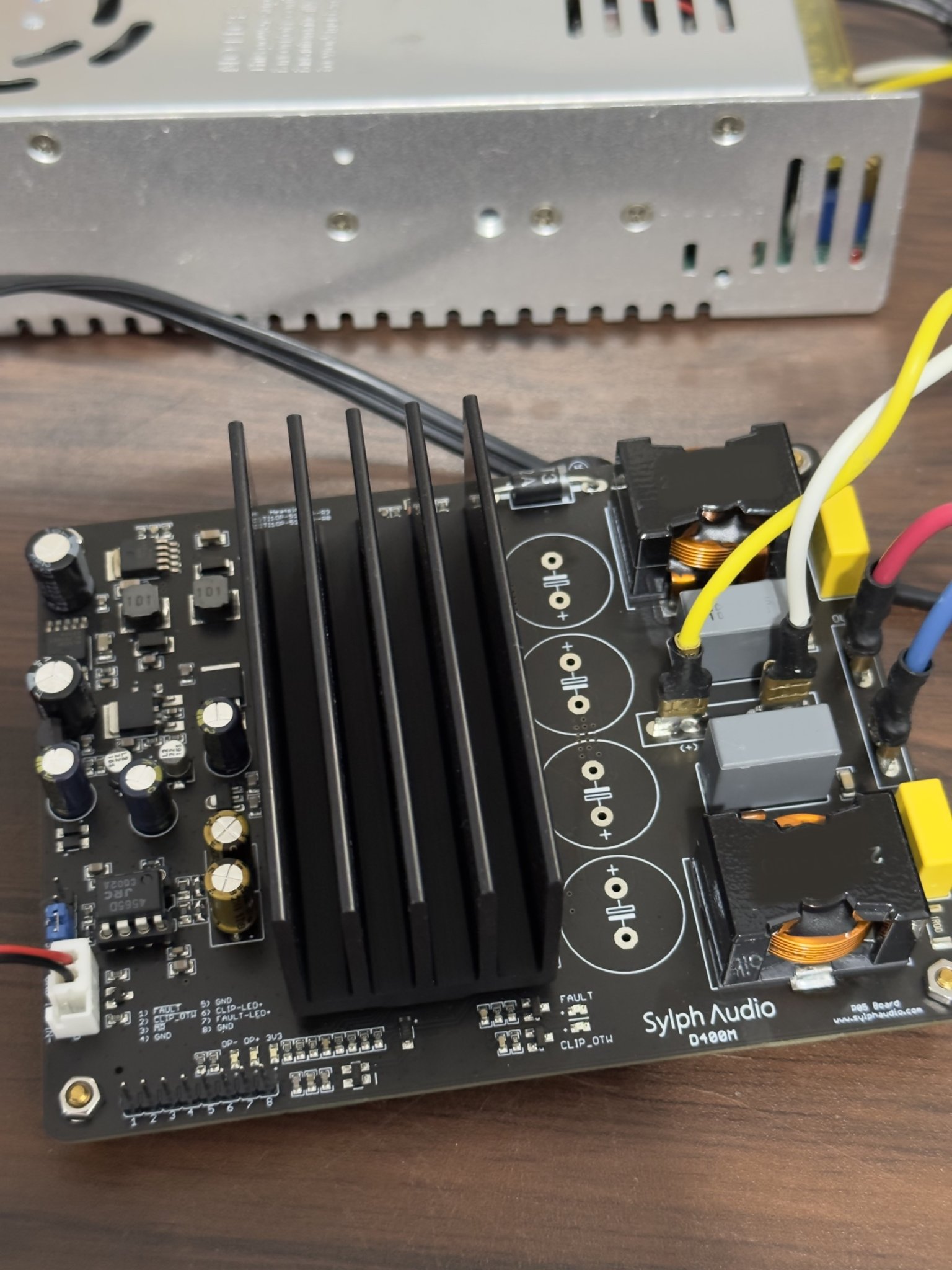

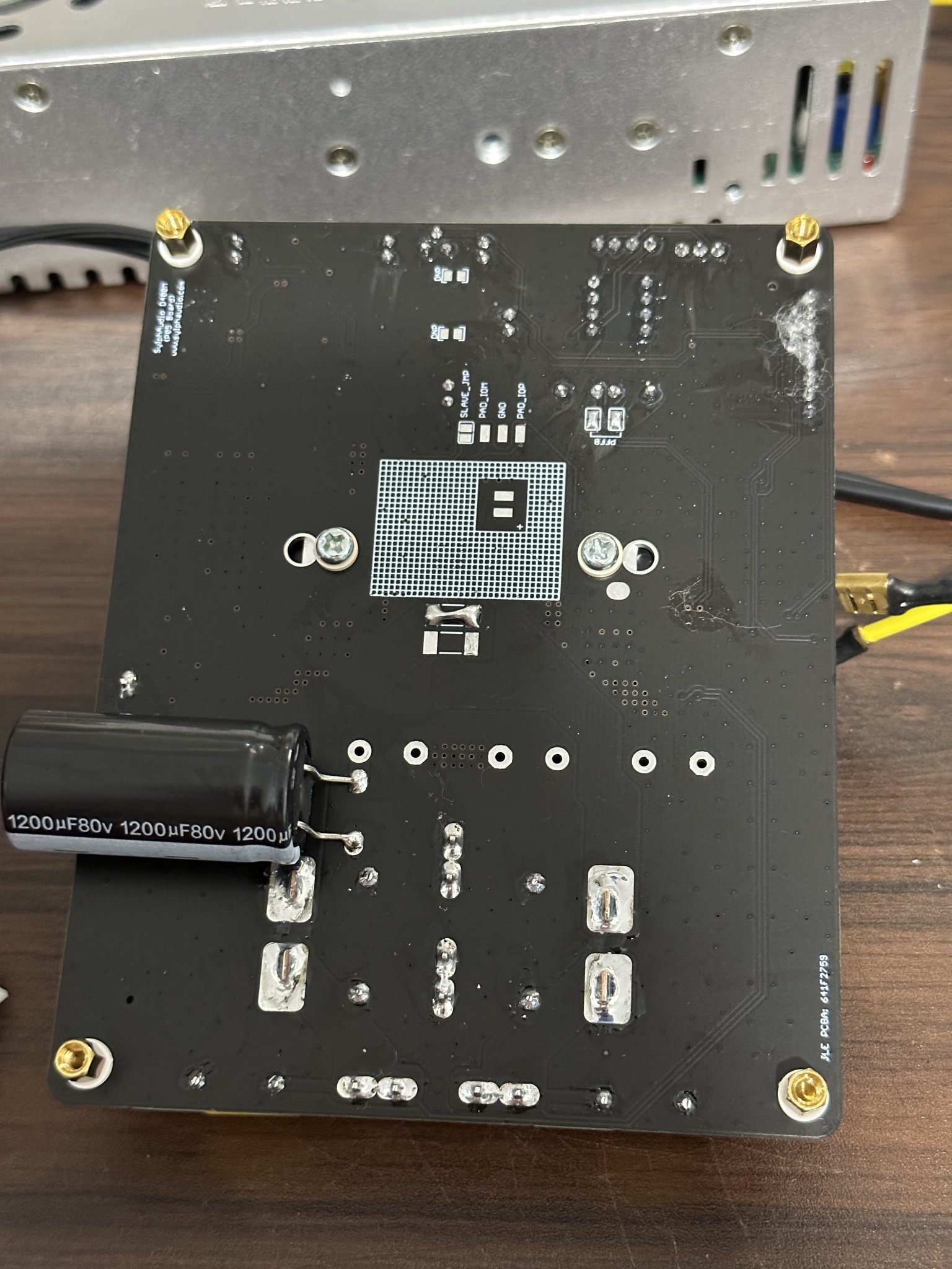

SYLPH-D400
Without heatsink / Without bulk caps option is being tested as well before shipping out. Only the heatsink and bulk caps are required to make it an RTR module.
Compatible heatsink
ATS-TI1OP-519-C1-R3 or
ATS-TI1OP-519-C1-R0
Recommended cap (63V, 18mm diameter, 7.5mm LS)
EEU-FC1J182
JRC4565 is the default opamp going forward.
Compatible heatsink
ATS-TI1OP-519-C1-R0
EEU-FC1J182

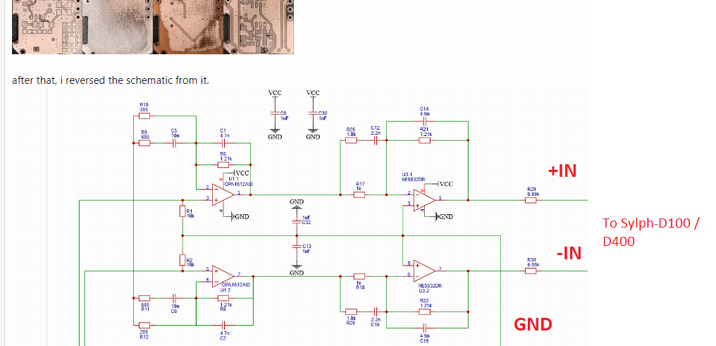

https://www.audiosciencereview.com/...fix-d01-module-replacement-for-everyone.44219
Interesting stuff going on here

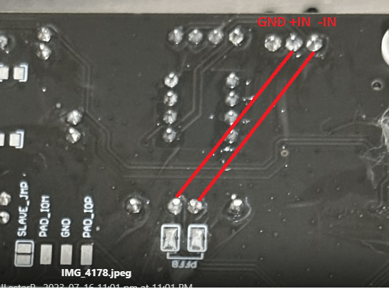

If you have gamerpaddy's module, just bypass the opamp section of D400 or D100 (solder a wire from the input terminals then solder it directly to input coupling caps, attached pic). It will perfectly work. Although you need OPA1612 and good 4 layer layout on an external module to get 106dB SINAD (5W 4R) on both D100 and D400.Interesting stuff going on here
The input section of D100 and D400 have a different implementation, but it should sound the same (if not better). So there's no point of bypassing the input section other than achieving higher SINAD (or higher gains)

correction: gamerpaddy's module uses single supply for the opamps, so it will not work on D100/D400.It will perfectly work
