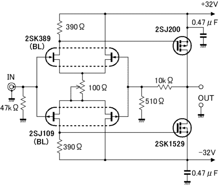

Another amplifier topology from Mr. Jean-Marc Plantefève.
Hi, Argo -
I came up with that topology some time ago, but with feedback taken from the output to the jfet sources.
Hi jam,
I understand then that the Cs are being used to deliberately cause phase shift, which will increase delay. This means that the amplifier will be slower (relatively) to counter loudspeaker induced back emfs and additional reactive loading.

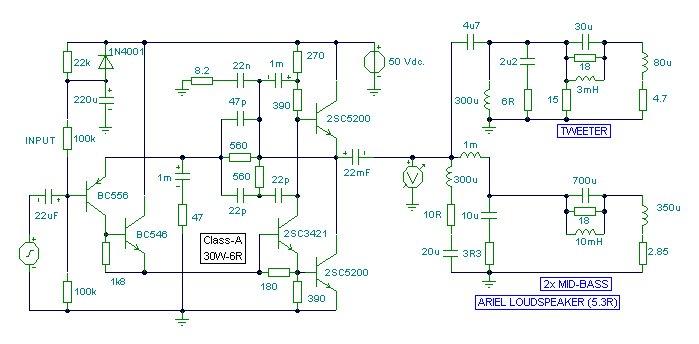

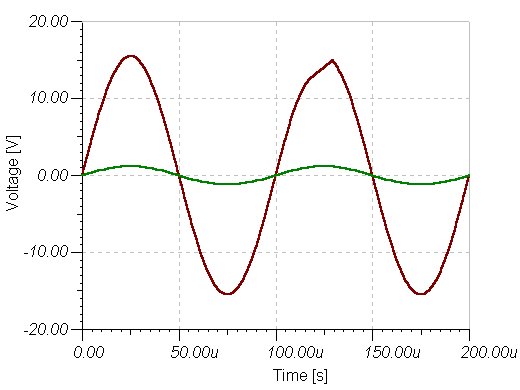

Until the circuit is simulated with the electrical equivalent of a real world loudspeaker it cannot be assumed to be satisfactory just because it tests okay with 8R and maybe a parallel C.
For example

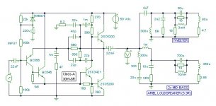

I could recommend the attached class-A JLH 30W-6R derivative for its flat responses and 0.005% thd at af frequencies. It will sound superb and better than non or low NFB types with full range drivers or with more complex hi-fi types at relaxed listening levels, but it will be unable to cope with complex dynamic loudspeaker induced back emfs at enthusiastic listening levels.
As there is only 50nS propagation delay for the NFB loop to fully respond and the response is not inductive, it does not lose control when it distorts. Also attached. This amp is struggling well below its full power output as most class-As do; maybe one of Millwoods mosfet variants would cope better from a power point of view.
The loudspeaker illustrated here can be found on the Web.
It is know to sound clean when driven with valve amps, but rarely so with transistorised 'efforts'.
With this more realistic load different amplifier circuits react badly at different audio frequencies, typically around 55Hz, 2kHz and 10kHz. Some are affected within the first cycle of reproduction, others the second, and those with internal closed loop delay can react like an inductive spring to generate higher frequencies than those that the amplifier drives the speaker with, especially on transients and first cycle sinewaves.
I have concerns for several circuits on this string, and feel that designers should be very careful about believing 8R loaded simulations with or without additional C or L connection. It is loudspeakers we listen to, and loudspeaker equivalents we should be simulating with.
Don't give up on that circuit subwo1, I think it has potential.

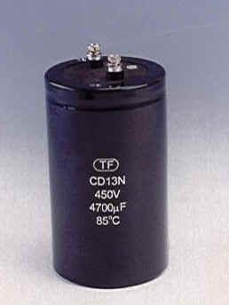

Christer,
DC blocking cap, indeed. Those things should be only be used when necessary besides the impedance of the current feedback network is so low you will need a huge cap..................(like on of these to get a good response)..... It would be like attaching one huge antenna to the feedback circuit.
Jam
Jam
Jam,
Yes, you're right. I didn't remember the gain resistor was that
small. It would probably have to be a servo then, or just let it
freewheel as is obviously intended. I wonder if any of those
who have built the Zen-/Mos-/Buzquito has measured the DC
drift?
Still, 450V is bit highish for a DC blocker, isn't it?
drift?
