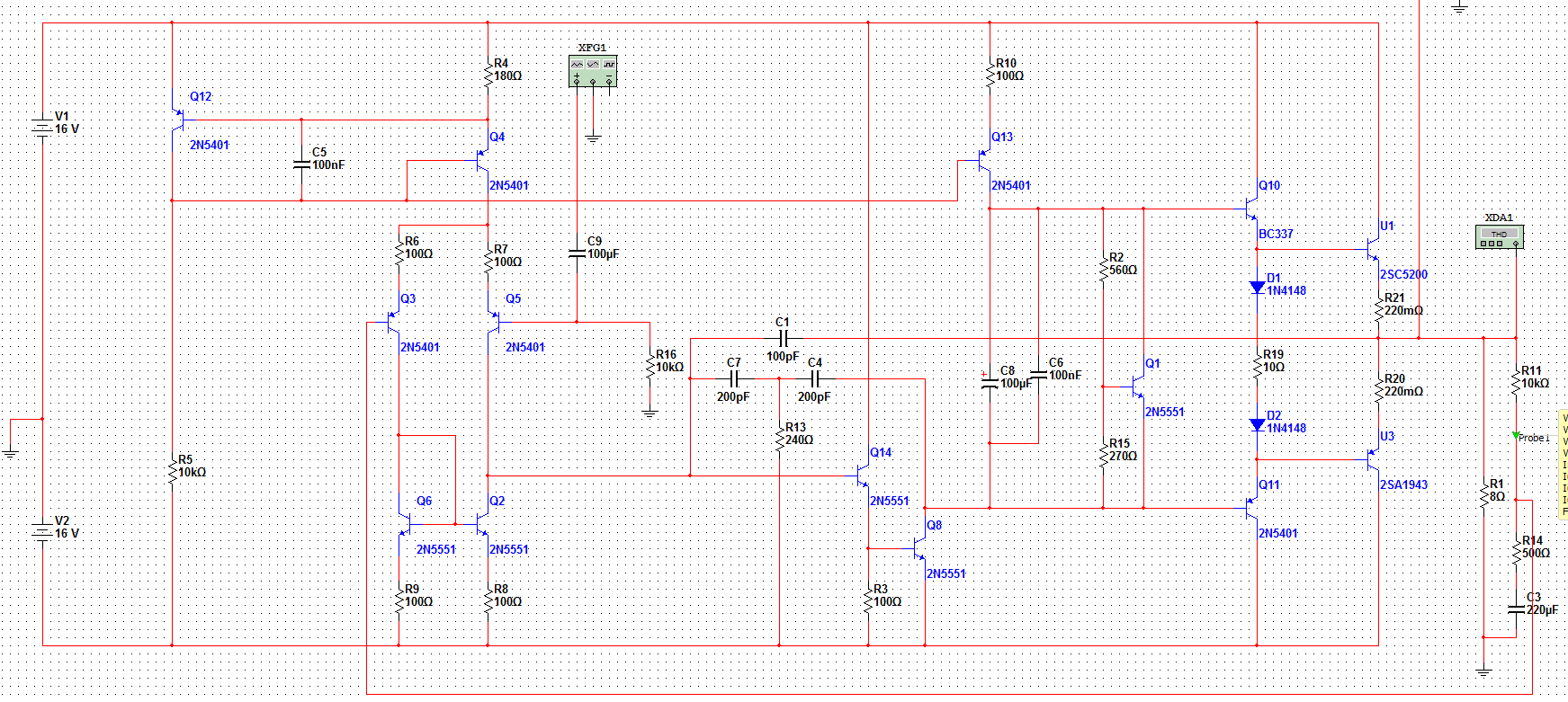

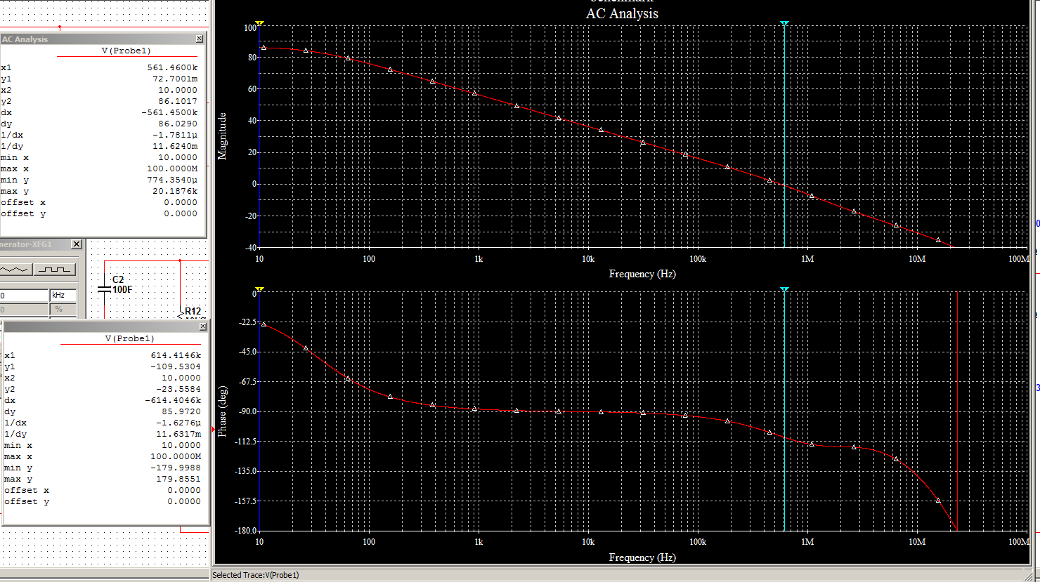

Here is what I was talking about. Please see the attachment.
2-Pole performance
1-Pole like frequency response.
C1 is the outer Miller Capacitor.
Actually, you must come up 2 or more pole at inner loop, so that you can have some extra gain (at lower frequency) for outer loop to do the compensation.
Dear jxdking,Here is what I was talking about. Please see the attachment.
2-Pole performance

Looking at your schematic, I'm not sure whether the feedback via C1 will work as intended. If I get it right, you first set the VAS gain by the two-pole compensation network with C4 and C7. Then you apply a loop around this stage and OPS via C1. I'm wondering whether this will work as intended, if you do not isolate the two "left-hand sides" of feedback networks. They both are connected to the VAS input and will interfere somehow. Additionally, there is no voltage gain between the "right hand sides" of both networks. In my examples, both "left-hand sides" are isolated by a transconductance stage in between which will provide additional gain. Did you probe the loop gains of both loops?

Dear jxdking,
Actually, C1 could be any value, as the maximum ULGF is restricted by 2 pole compensation. It will be stable anyway. At very high frequency, the equivalent Miller Cap value will be (C1+(C4//C7)).
C1 is intended to do Miller Compensation including output stage. That's our goal, isn't it?
1. The tricky part is what the 2 pole compensation is doing here. Why has to be 2 pole configuration. In order to keep output stage stable, the ULGF should be restricted even if C1 is not added. Thus, you have 2 choice.
(1) one choice is traditional miller compensation for inner loop. In this case, it makes outer Miller Cap useless but lower the ULGF.
(2) another choice is 2 pole compensation for inner loop. 2 pole will be 40dB/Oct rolling down, you will get a big hump at low frequency response. At low frequency, you will have lots of extra gain comparing to 1 pole. Thus, you can use outer loop to Compensate the extra gain. C1 will dominate at low frequency. The overall frequency response will look just like 1 pole.
2. You mentioned using extra stage. Yes, you can do that, but it will be more complicated. Here is my rule. The whole amplifier should be stable even if removing all the outer Miller Caps, because the most inner loop should be dominant at high frequency to make sure everything is stable. It will be pretty tricky to achieve that rule with extra stage.
3. After playing around simulation for a while, I find the THD performance is pretty equivalent to TMC compensation. Actually, it should be. The beautiful part is that they can work together. Should I call it Nested Transitional Two Pole Compensation?

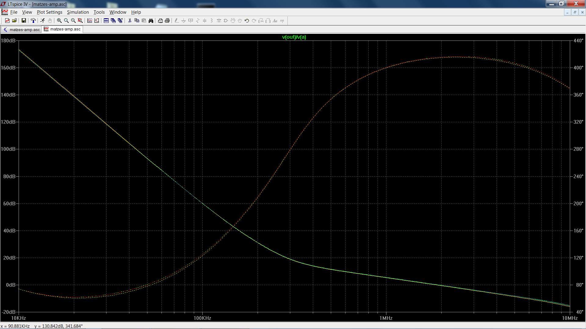

High ULGF, higher-order behaviour
Some slides on minimum phase systems that I found in reasoning about one of David's posts started with the quote:The amplifier matzes-amp.asc that sounds so marvelously, creates negligible THD in simulation and behaves very well in practice e.g. under sqare wave load, has in fact an ULGF of 1.8 MHz and exhibits higher-order behaviour in the loop around the output stage (see pictures below).
Thank you, jcx, for recommending Lurie's book. In the second chapter, Lurie clearly shows how to cope with nested loops. From this it follows how one has to probe the circuit in order to see the most critical parts.
I knew that giant amounts of feedback around VAS and OPS are generated (more than 20dB per loop at 20kHz). But if I had known in advance that the output stage is operated at an ULGF of 1.8MHz with phase margin of 50 to 60 degrees, I never would have started to build this beast on a breadboard. It is a kind of miracle that all works well.
Need to keep thinking why all works that well. The next step will be a trial to mathematically analyse TMC so that one can calculate (in principle) the second-order loop response Damir measures in his TT-TMC amp.
So hopefully the project will at least result in some contribution for better understanding TMC and other schemes with nested feedback.

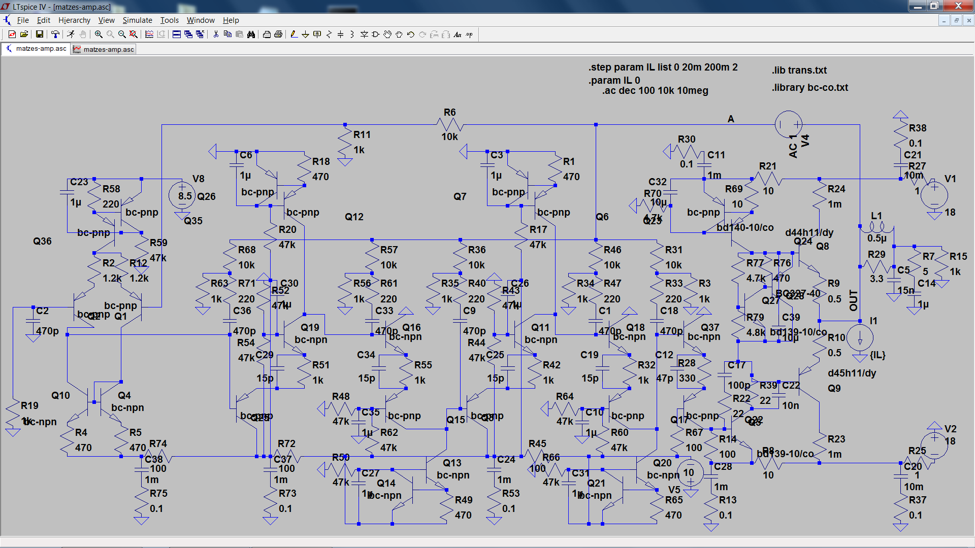

That is the most extreme conditional stability I have seen for an audio amp!
JCX has several times stated that a solid state amp can reach full gain quite quickly so conditional stability is not too much a problem. Your amp is extraordinary proof.
Also the most unreadable schematic! And please use Tian or Vsource technique from now on, your extra inductors and capacitors just complicate.
The other point is that the low ULGF often recommended in books does not reflect improvements in transistors. And many people just repeat some obsolete number they read in the past. So 2 MHz is not so extreme.
I know you have seen Ovidiu's "RF" amp. THAT is extreme.
So we are now in accord about my statements here and in the blog about the way the extra orders have consequences on the phase?
I will be interested to see your TMC analysis, I have also done this and would like to compare and cross check.
Best wishes
David

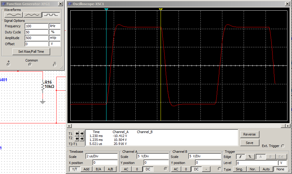

Hi David,
There ist just one thing: If I make a conceptual model of the whole circuit and deliberately reduce the low-pass frequency in the OPS, then I can reduce the critical phase margin to smaller values. (BTW, this parallels somehow the example jcx posted in the Self thread, where he introduced a delay line).
If I then choose a phase margin of e.g. 20 degree, then the square wave responses at the amp output and also in the intermediate loops do ring. But I'm surprised that they do not ring as much as expected. But this really needs further, quantitative, investigation. (You see, I'm still dreaming of an -- at least tiny -- miracle

This is probably the reason that it took me a lot of time to turn it on and off without too much noise. I have seen the techniques for including speaker relays into the feedback loop in Bob's book, so that performance degradation is not an issue anymore. But I was not sure how to apply it to my feedback topology. So I wanted to avoid the relay completely. I have a solution, but it still produces some noise during turn-off.JCX has several times stated that a solid state amp can reach full gain quite quickly so conditional stability is not too much a problem. Your amp is extraordinary proof.
It is that dense as I often need to print things, if I really want to work with them or reason about them.Also the most unreadable schematic!
Nevertheless, it is sort of disappointment. I was dreaming of 300 kHz!The other point is that the low ULGF often recommended in books does not reflect improvements in transistors. And many people just repeat some obsolete number they read in the past. So 2 MHz is not so extreme.

David iz right, most unreadable schematic.
By the way if you state -V(out)/v(a) then it will be easier to see phase margin and gain margin.
BR Damir
With the phase plot, I often have a problem, especially if the phase varies over a very wide range in the plotted frequency range. Will try the '-' trick next time.

Matze
LTspice supports Hierarchical schematics - could package your ccs, "Rush amplifier" as sub circuits since you seem to have the same part values in them as far as I could see
