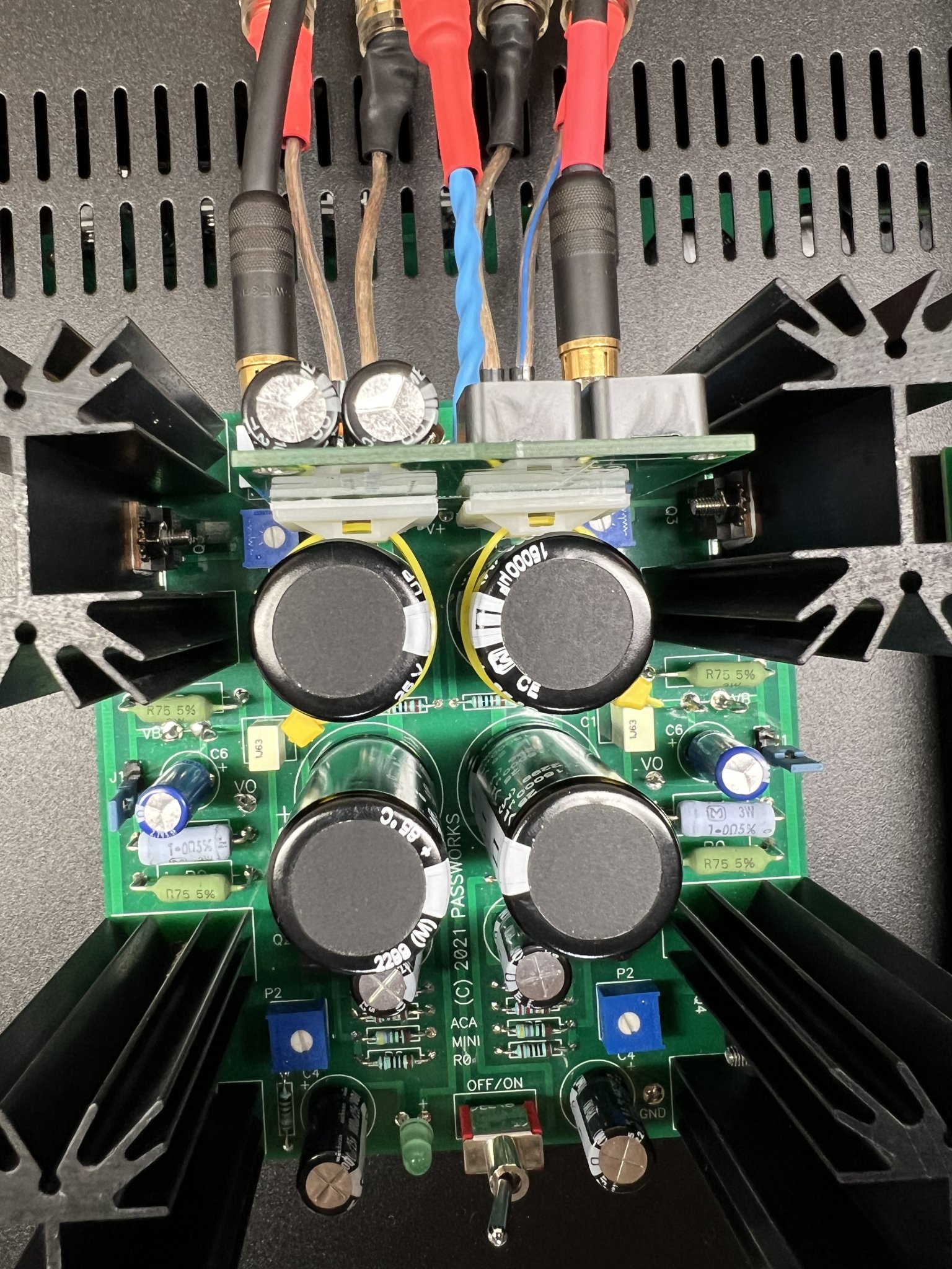

AmyAlice: DC filter for SMPS, using 2 feedthru capacitors + SMD assembly. max 3A & max 48V
I only had a chance to listen for a couple of minutes. Initial impressions are positive and worth putting it front of the ACA Mini.
I did secure the AmyAlice to the caps. You can see what I did in the picture.
I did use a P089ZB with the amp before, and still think that there was an improvement. That just could be new poppa syndrome, but don’t think so.

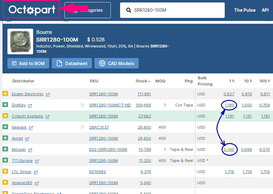

... as Forum readers are well aware, there are lots of new electronic components which are offered ONLY in SMD packages. High volume electronics manufacturing is all-SMD in Y2023, therefore component suppliers meet their customers' needs with all-SMD parts. This is particularly true of new components, which, by the very definition of the word "new", do not exist in legacy thru-hole designs. ... A couple of new, SMD-only components are now available, which enable much better performance (i.e. greater noise attenuation) in SMPS DC filters.
This may explain why members prefer AmyAlice
Joined 2011
