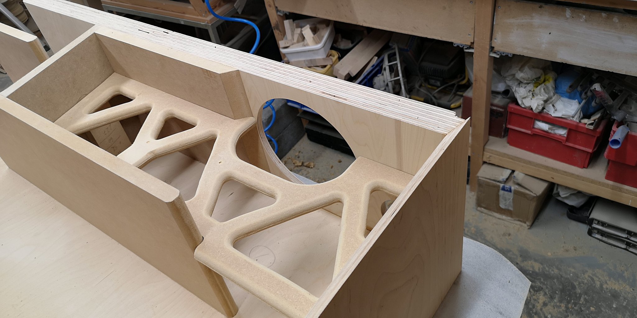

Only used mdf internally. All outer panels are made of 3/4" baltic birch ply. The magnet isn't supported though.

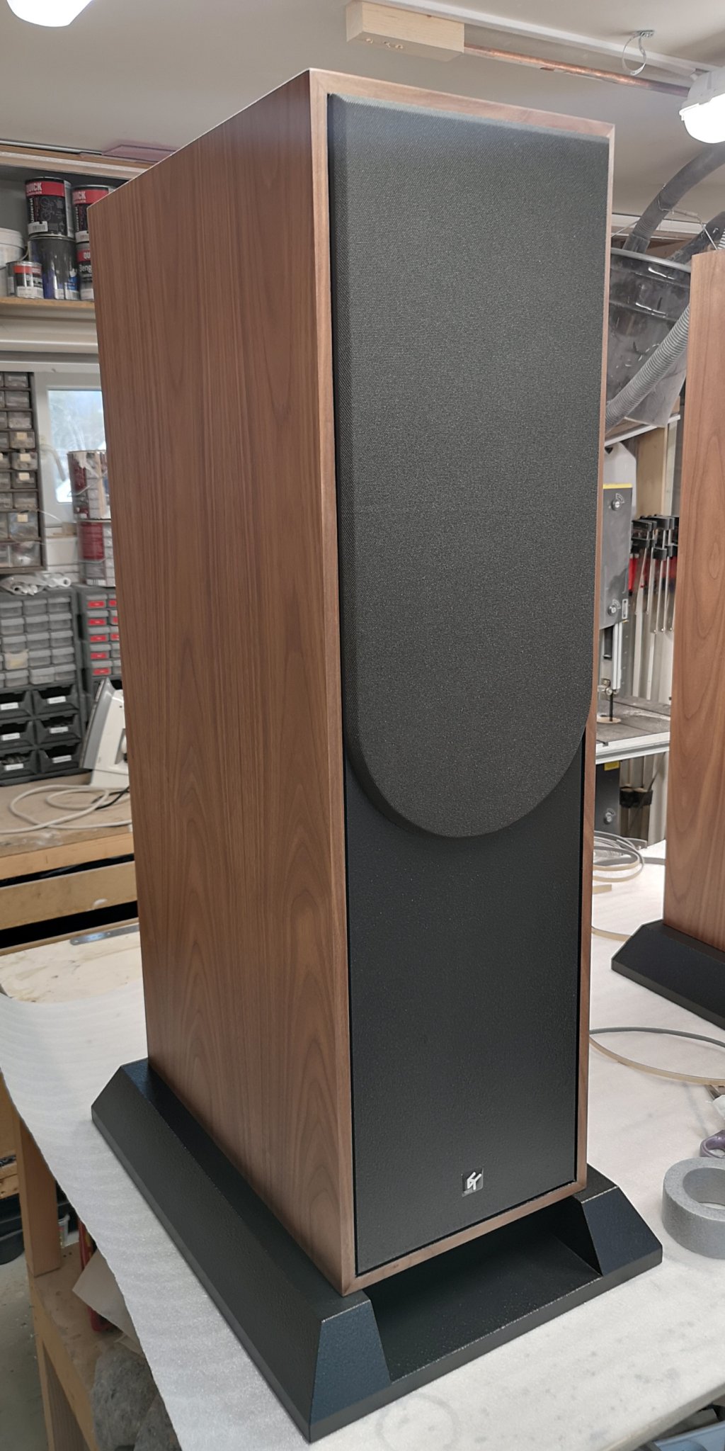

Yes they are now fitted with a single Scanspeak P21WO 20 08. They sound great at low to moderate listening levels with incredibly deep bass. But what I notice is that the woofers seem to loose a little bit control as the volume goes up compared to cabinet I had them in before (55 liters BR).

I would not be surprised if that is caused by panel resonances. According to the drawing the back panel is not braced at all. And the MDF structure does not do much. MDF is dense cardboard but it does not have any structural strength.Yes they are now fitted with a single Scanspeak P21WO 20 08. They sound great at low to moderate listening levels with incredibly deep bass. But what I notice is that the woofers seem to loose a little bit control as the volume goes up compared to cabinet I had them in before (55 liters BR).
Ideal line length is too short (1/4 WL) or too long (1/8 WL) based on a 28 Hz Fs = ~13543/4/28 = ~121", ~13543/2/28 = ~60.5", though fine tuning the vent solves this type of 'problem', but this means maybe enlarging it, so might want to try 'critically' damping it.
All very true, though 3/4" thick at such a narrow width, high aspect ratio isn't a problem IME. Easy enough to add a ~1.5" x 24" vertical riser from scrap, offset at an odd harmonic in both planes to guarantee it doesn't.I would not be surprised if that is caused by panel resonances. According to the drawing the back panel is not braced at all. And the MDF structure does not do much. MDF is dense cardboard but it does not have any structural strength.
It's not shown in the picture but I have 3 bracings running down the backwall. The issue I'm describing is not due to cabinet resonance. The 55 liter speaker I had the woofer in before had just a single brace and the cabinets was made out of 18mm mdf. In those speakers I could hear cabinet resonance when I played loud.
In the MLTL it's like the cabinet is to big. Like the volume is too large to support the woofer. The woofer will bottom out much sooner in the MLTL's compared to the 55l BR. But the volume in the MLTL's are close to 90 liters.

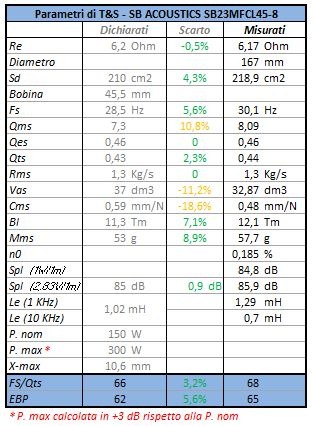

Dibirama measured the SB Acoustics woofers here: https://www.dibirama.it/home-page/sub-woofer/822-sb-acoustics-sb23mfcl45-8.html
Don't get me wrong, I love the bass these speakers produce. Very articulate and refined, you can very easily follow bass notes going very low. In that regard they remind me somewhat of the Bill Fitzmaurice horn subwoofers I used to have.

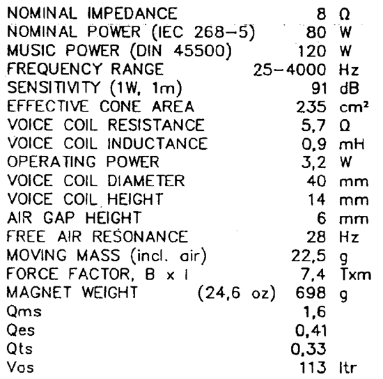

Resonance is the same, Q is fairly different, Equivalent Volume is dramatically different. idoubt the small difference in Q will equal out the huge V[subas[/sub] difference.
My guess is that the driver is choked for volume. D’Appolito had the same probelm with Thor. No bass.
Fs // 28 // 28.5
Q[subts[/sub] // 0.33 // 0.43
V[subas[/sub] // 115 // 37
