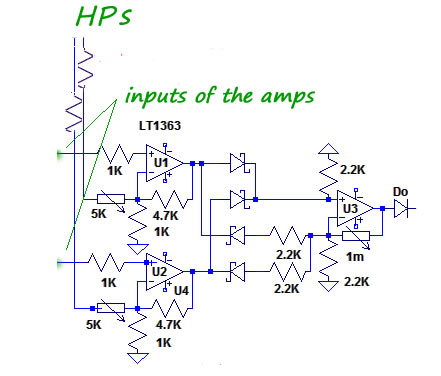

Apart the fact that it detect all kind of problems, reason why i call-it ultimate, this idea brings a big advantage.
It fire the protection quasi instant (µs), with not the additional long delay needed by the integrator stages that usual protection circuits use, by habit, to detect DC.
Instant even in case of short circuit, and before your powe amp devices suffer. For the same reason, it can protect your fragile tweeters against very low DC levels.
This thread is opened to be a cooperative one; All of you who want to collaborate, bring ameliorations, printed board designs, experience returns etc... are highly welcomed.

Separate relay drivers for left and right channels might allow the amp to finish a gig/concert with degraded sound - one channel.
Some amps, like the CS800s and PV 1.3k amps I am working on, have variable gain to allow for different inputs. The detection circuit couldn't cope with that without modification.

You are right, mr Marsh, of course. (Thanks for your interest).Such an idea (comparator) can be applied using the amps own internal error correction port, as well. amplify and rectify it and drive relay/disconnect.
Of course i had tough to that.
The major advantage would be we do not need to tune any level to compensate the gain factor of the amp.
There are several reasons why i chosed my solution.
- The virtual point where the two signals (input and feedback) are mixed together in the amp is very sensitive to any parasitic cap. (Like in the bus of a mixing console). Cabling a wire there to go to the protection board can deteriorate the amp performance or stability. Specially if your amp goes up to several Mhz.
- To find this point can be difficult for people with little electronic understanding.
- We loose the protection against DC in the input, as long as the amp can amplify-it before clipping.
-The last reason is, as i mentioned-it, i wanted this circuit to fit any existing amp, without any internal modification.
On a new amp project, it would be easy to add a single transistor, like an emitter follower directly on the board, to isolate the amp from any influence of this cable, saving the op Amp comparators. But, again, we lose the DC protection of the input. It would be OK for an input cap protected amp.
As the circuit is unique for the two channels, it will cut the 2 channels in the same time. You are right. Better for an home amp. Easy to separate in two, if you prefer.Separate relay drivers for left and right channels might allow the amp to finish a gig/concert with degraded sound - one channel.

How can your Pic detect amp HF oscillations dangerous for your tweeters ?
I would like to add that this protection can detect any amp clipping and fire at the first kick drum, depending of the margin you set. Tune-it according to your needs.

As the comparator is supposed to subtract one signal to the other, it is obvious that any phase difference introduced by the Op amp will create errors. Reason why you need a very fast Op amp. But, if your power amp itself is not ultra fast, he will create some phase rotation at HF by itself. So, the difference will not be a big issue.For the comparator can we use another op amps e.g. TL072
In my home amp (ultra fast), i used TL074 op amps, with an little increased security margin before protection fires, and it works good enough since decades.
