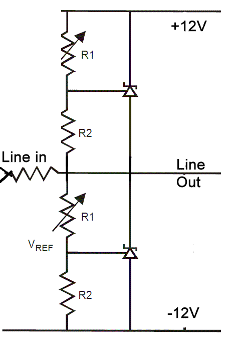

To get rid of the clipping problem, i propose a solution. The problem i that, when the incoming amp level is too high, it can fire the protection, because the amp clips and, so there is a difference between the input and output signal in it. can be nice for home, bad for PA. The idea is to clip the signal just under this point, before it incomes in the amp.
Using this very simple circuit, see attached)
The upper LM431 is tuned by his R1 to limit the negative amplitude of the input signal. The bottom LM431 to limit the positive input signals. both will need to be tuned , according to your amp power capability, just before its maximal excursion.
One channel shown.
+- full voltage (short circuit of a power transistor) can destroy instant your boomer's coil if the coil hit the back magnet plate. Too, fragile tweeters can be destroyed by this transient . They even can be destroyed by clippings.Its worth a try.
A speaker wont blow up immediately if you apply full B+ or B-.
It should take a low frequency OK.
Its a matter of catching it before it gets to the point where the DC is starting to fry the voice coil which is probably about a second.
This fast protection can be tuned according to your system roughness.
