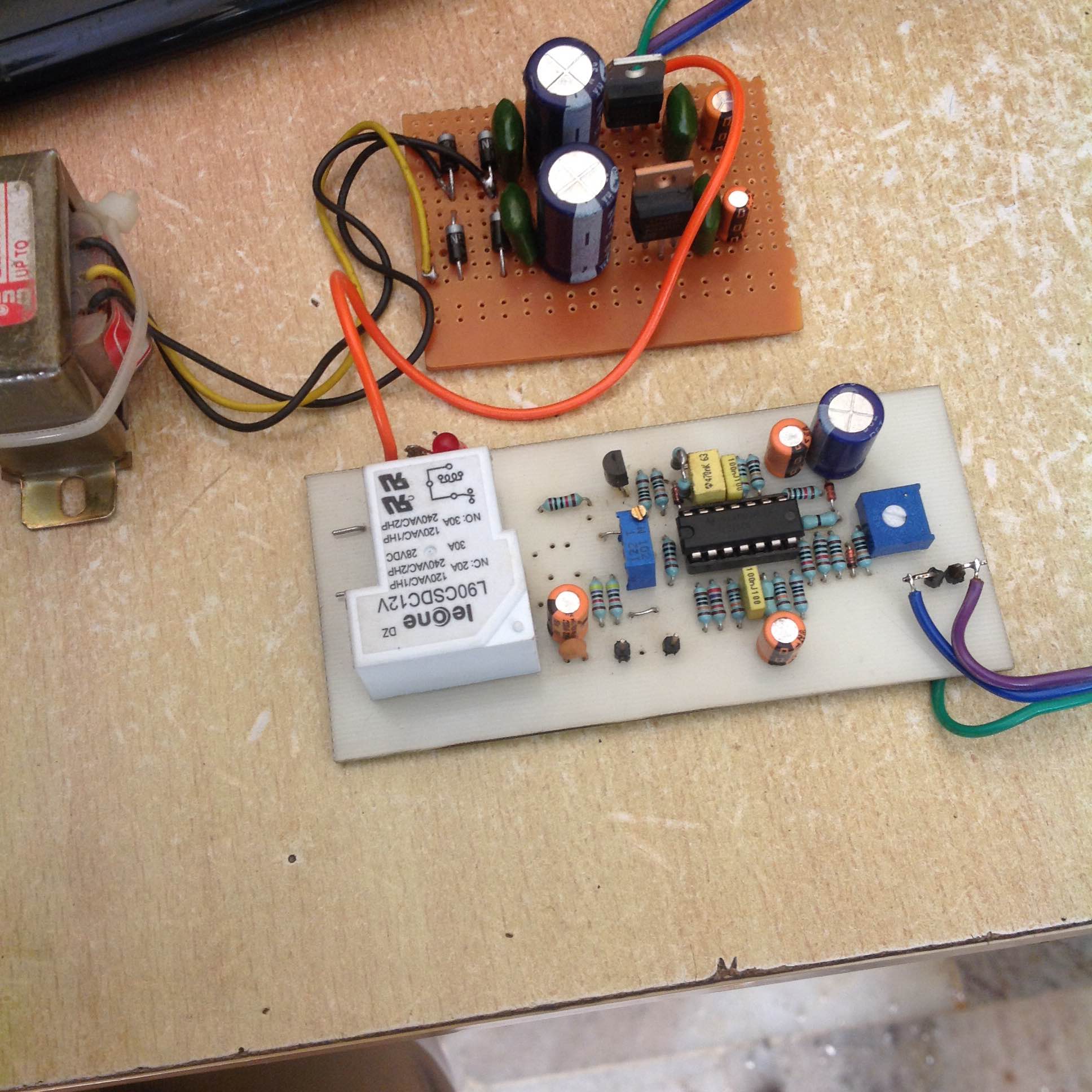

Hello Andrew T
greetings fist of all which is better a latch to hold on the protection
or when the speaker wires are shorted protection works but relay goes on
and off i have tested another dc and short circuit protection on high power
PA amps same result on shorting speaker wires relay goes on or off is that
right i think its not ok because large currents on relay contacts can spoil
contacts these all are simple dc and overload protections with low cost
components at least expensive transistors and speakers are saved THATS
the main goal i think

It is supposed to have a 2 second delay after the trouble has ended before the relay re-connect the speakers.you could activate the delay timer each time it triggers.
Or activate a latch to hold the protection.

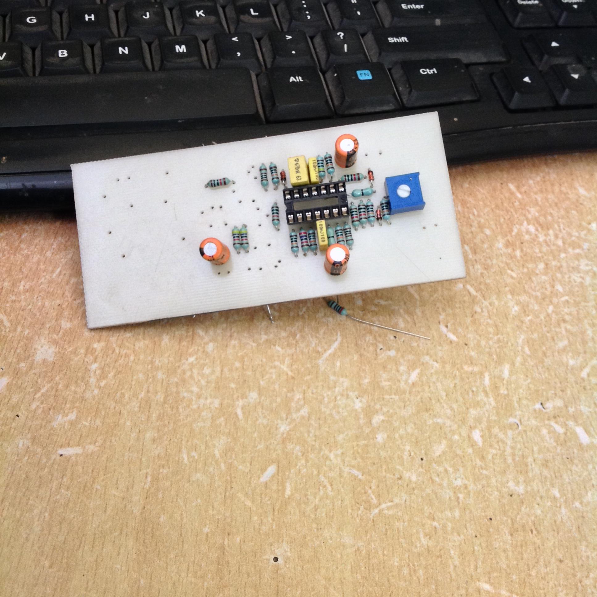

"The 470µF provide the "Power ON" delay of 6 seconds, while the 2MΩ and 2K resistances are in charge of setting a threshold in such a way that the protection will not fire with little voltage errors noises, and offset of the previous OPAs. On the other side, the diode the resistance and the 0.33µF cap allow a fast switching and a slow recovery (2s)"
Of course. Short circuits of speakers wires are not supposed to happens, so, it is the main target of this protection: protect your speakers in case of amp failure. And the protection will stay fired as long as the offset will be present.is DC protection included in circuit also
I thought everything has been explained.
You can adjust sensitivity for the protection fire in less than 10ms at 35mV of offset ;-)
if you are interested, I have made a version with protection not recovering itself after activation, but with a "reset button".sorry you could not watch the vedio on FB will post vedio
on youtube i thnk next step is to add solidstate mosfet relay
Just the add of 4 resistances, a diode and a CD4027B.

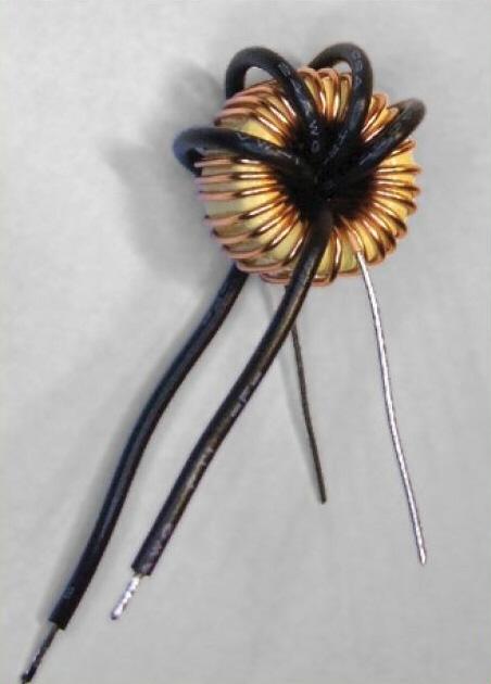

Hello Esperado
greetings yes i am interested with the protection not recovering
itself after protection please can you post schematic just tested
overload current protection with yellow core CT current sensor
QSC PL380 amplifier uses this technique with success just 1 ic
2 trs few resistaces and caps for stereo overload protection
