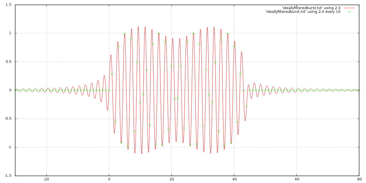

I see two descriptions of the same problem in your post, one description in the time domain and one description in the frequency domain.
In any case, what is still missing is the effect of the anti-aliasing filter. No-one would sample audio signals without first band-limiting them with an anti-aliasing filter. When this is a nearly ideal filter that just removes everything above 22050 Hz and leaves everything below it unscathed, you get long ultrasonic pre- and post-ringing, because an ideal filter has a sinc-shaped impulse response. After sampling and reconstruction with an ideal sinc-shaped impulse response, you get the same waveform as at the output of the anti-aliasing filter. For example, with a 20 kHz tone burst and 44.1 kHz sample rate, an ideal anti-aliasing filter would change the waveform of the tone burst into the red waveform in the attachment, sampling would change it into the green waveform and reconstruction would change it back into the red waveform.
It is possible to reduce the ringing if you are willing to accept treble loss. For example, with a relatively smooth low-pass filter of which the stop band starts at a lower frequency than the transition bands of any of the other filters in the signal chain. Peter Garde dubbed that an apodization filter.

If you sample a single 20khz sine wave, it doesn't need any anti-aliasing filter. You sample this frequency at 44.1khz and it generates 24khz image frequency. To eliminate this image 24khz ultrasound, to this day what I knew, is to filter by digital or analog means. The third way is mine, which is superior to what you are proposing. All I want to understand, why we need to get ride of this ultrasound to get it sounding right? I firmly believe the waves on the output of the DAC above 11khz are spaced mostly at 22khz interval with less and less defect as it approaches the Nyquist. May be the ear doesn't demodulate as the FFT to get the below Nyquist components unless the ultasounds once filtered it is becoming demodulated. This how I explain at this point of my understanding. This problem is there since 40 years and only one month that I am dealing with. Corona period looks to last at least a year more, so I have lot of time to think about solutions.
What I want to say that even the signal before sampling is exempt of ultrasound, the sampler does create them, that is required from the DAC to filter them. My mission is not to record but playback only what the CD producer have sold to me. If it is recorded with resonances, I can do nothing about it, but I need to avoid adding resonances because I want to make it better.
That's just the point: assuming that during recording, the signal was somehow band-limited to below 22050 Hz, which it had to be to prevent aliasing, reconstructing the signal by passing it through an ideal low-pass at 22050 Hz is not going to add any pre- or post-ringing. It just reconstructs the band-limited waveform that was sampled.
Nonetheless, you could try to remove ultrasonic pre- and/or post-ringing that was already there at the anti-aliasing filter's output by using an apodizing filter as reconstruction filter - which will reduce treble.
I don't understand why you are talking about ant-aliasing, it concerns the recording. The pre and post resonances are not ultrasonic but the signals frequency perfectly audible, this is due to the nature of the digital filter.
You try to reproduce what was recorded, don't you? Then it's important to know that the recorded signal had a bandwidth limitation.
Time domain: the impulse response of an ideal low pass filter at 22050 Hz is sin(2*pi*22050 Hz*t)/(2*pi*22050 Hz*t) for t not equal to 0, 1 for t = 0. Most people would regard 22050 Hz ringing as ultrasonic.
Frequency domain: all an ideal low-pass filter at 22050 Hz does is to remove everything above 22050 Hz. Hence, the ringing is due to the absence of the components above 22050 Hz. Most people would regard these as ultrasonic.
Marcel, do these filters in each side of the process need to be symmetrical in order to work perfectly?
They need to have a sin(2 pi fN t)/(2 pi fN t)-shaped impulse response for perfect anti-alias filtering and perfect reconstruction, and that response is symmetrical. fN is the Nyquist frequency, which is half the sample frequency. When the bandwidth at the recording side was limited with some other type of filter, you can still reconstruct what came out of that filter by using a filter with a sin(2 pi fN t)/(2 pi fN t)-shaped impulse response on the DAC side.
