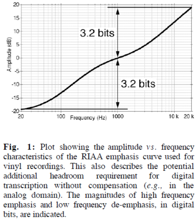

"Setting aside the benefits of word length recovery in the bass because of digital compensation, as proven above: if truncation does occur, bass resolution truncation represents a more desirable alternative to resolution truncation in the midrange and treble; further, the perception of any “disadvantage” to word length truncation in the bass is unfounded, because of being more than compensated by the feature of digital resolution enhancement in the treble.
6. CONCLUSION
Digitally implemented de-emphasis filtering, used for playback of vinyl LP recordings, enhances the digital word length at low frequencies, similar to the reconstruction filters used for the playback of one-bit digital audio streams. The reconstructive properties of digital de-emphasis filtering, as shown here, in conjunction with the characteristics of most program material, will cause a typical overall bass resolution truncation of only one bit or less, significantly lower than the nearly 7 bits predicted by a casual analysis of digitally realized frequency emphasis playback compensation.
Exceptional, uncommonly encountered program material may cause a worst case bass truncation of approximately three bits, which is negligible considering the 24 bit resolution capability of modern analog to digital converters. In cases where bass word length truncation does occur, the disadvantage is balanced by the complementary enhancement of digital resolution, due to treble preemphasis, in the frequency range where human hearing is at its most sensitive.

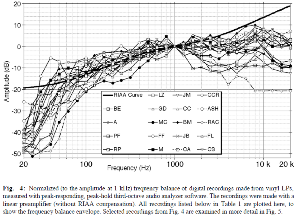

Another technique for checking on levels is to take a very dynamic recording and apply inverse RIAA I would think that would give a good answer on how much allowance you need for crest factor increase. Another thing to remember is that ticks and pops do not see pre-emphasis so they don't figure into this and in fact it is worth studying pre vs post RIAA removal but there is only so much time.

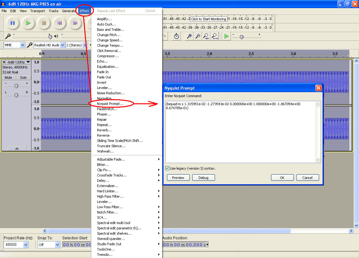

Right Scott. I had good results following Website of Wayne Stegall - Digital Phono Equalization (your suggestion)and note Audacity's RIAA filter is linear phase you can use the Nyquist prompt to do a proper minimum phase IIR RIAA
Just type the following:
(biquad-m s 1.315951e-02 -1.273543e-02 0.000000e+00 1.000000e+00 -1.867054e+00 8.674785e-01)
George
George
Don't forget the coefficients are different for each sampling rate, Bob Orban's are exact and the whole list is in my article as well as two biquad one's that get to micro-dB's of accuracy if you're obsessive like the Channel D guys.

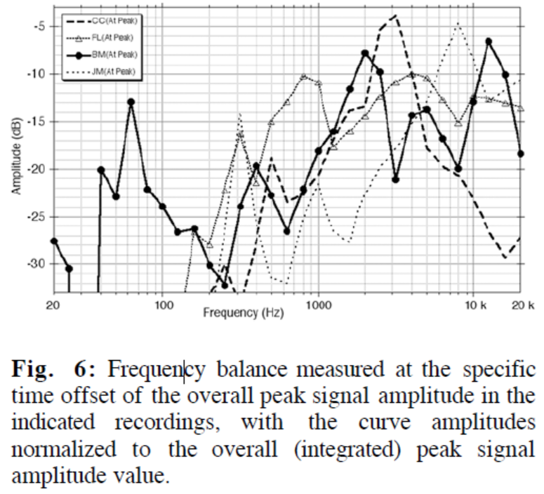

Fig. 6 shows the peak frequency balance measured at the specific location (in time) of the peak amplitude of those recordings which were found to exhibit greater degrees of high frequency emphasis (as shown in Figs. 4 and 5).
The plot is scaled to show the uppermost 30 dB of amplitude, and the curves were normalized to the overall peak level of the recording (because their coherent sum determines the peak level). Generally, for recordings exhibiting greater high frequency emphasis, the overall program peak correlated with a peak in high frequency content.

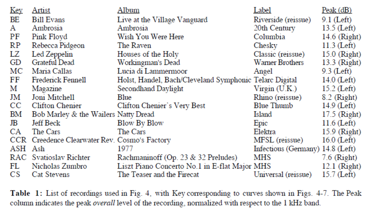

BM, Bob Marley & the Wailers, Natty Dread, Island, 17.5 (Right)
The Bob Marley and the Wailers recording is unique in that the program peak level simultaneously contains significant amounts of energy in more than one frequency region: low bass (in the 63 Hz, third octave band), midrange (2 kHz) and treble (12.5 kHz). The Liszt piano concerto also was unusual in that the emphasis of the high frequency balance at the program peak position is at a lower frequency (4 kHz), compared to that for the entire recording (16 kHz, Fig. 5).
Most of the other recordings also have significant high frequency content at the signal peak, but exhibit only one prominent frequency peak in the signal at the location of the overall signal peak, as shown, for example:
Clifton Chenier (3.15 kHz),
Joni Mitchell (8 kHz),
Led Zeppelin (10 kHz),
Pink Floyd (10-12.5 kHz);
and those not shown in Fig. 6: Magazine (6.3-8 kHz), Ash (8 kHz),
Creedence Clearwater Revival (10 kHz).
This supports the validity of the peak responding / peak hold analysis presented above; all peaks in Figs. 4 and 5 represent instantaneous values at particular frequencies at different times in the recording and don’t necessarily sum coherently and simultaneously; otherwise, the result might be more akin to noise, not music.
