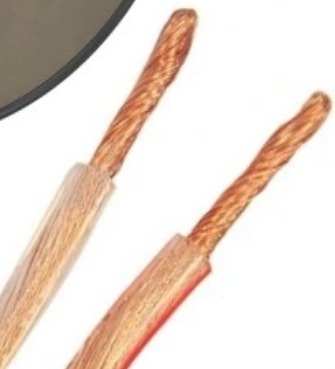

10m of 2 x 2.5mm of shielded high oxygen-free copper cables costs the equivalent of 3.9USD. Well?

The picture you provide is unshielded, high strandcount zip cable with PVC insulation.
The price you quote seems low given copper pricing, but I haven't looked recently. What you can find online now is amazing.
From a long term reliability point, that insulation outgasses chlorine so will eventually turn the copper green. Meaning replace it every couple of years.

If you say so...:)
Marked CCA

At 4$/10m, I can replace them every few months. Ice cream is more expensive. :)
By the way, some cables I have are more than 10 years old, none had turned green. None had got cracked.
But, if you want to waste money, I can't stop you.
CCA stands for copper clad aluminum. Only worry would be you might have to bump up the AWG a bit for the lower conductivity of the core.
Edit: a warning to anybody who does motion control stuff like CNC routers or 3D printers. Do not even think of putting CCA into a drag chain (sometimes called cable chain) as aluminum does not flex very well, it will fatigue much faster than copper. I do not know if CCA can be drag chain rated. Many DIYers upgrade their 3D printers like the Ender 3's with cable chains, I would hate to see anybody have a fire because of a poor choice in wire.
I am glad you mentioned CCA, thank you.
The cables I use are over 25 years old, and many are from the late 70's. If any degrade, I'll take them out of service. Till then, they stay. At work, I had to specify zero halogen cabling both for long term reliability due to chlorine outgassing as well as for elimination of hydrochloric acid should any cable catch fire.
The price you mentioned was interesting, it seemed low for pure copper wire. But the picture does not show shielding as mentioned.

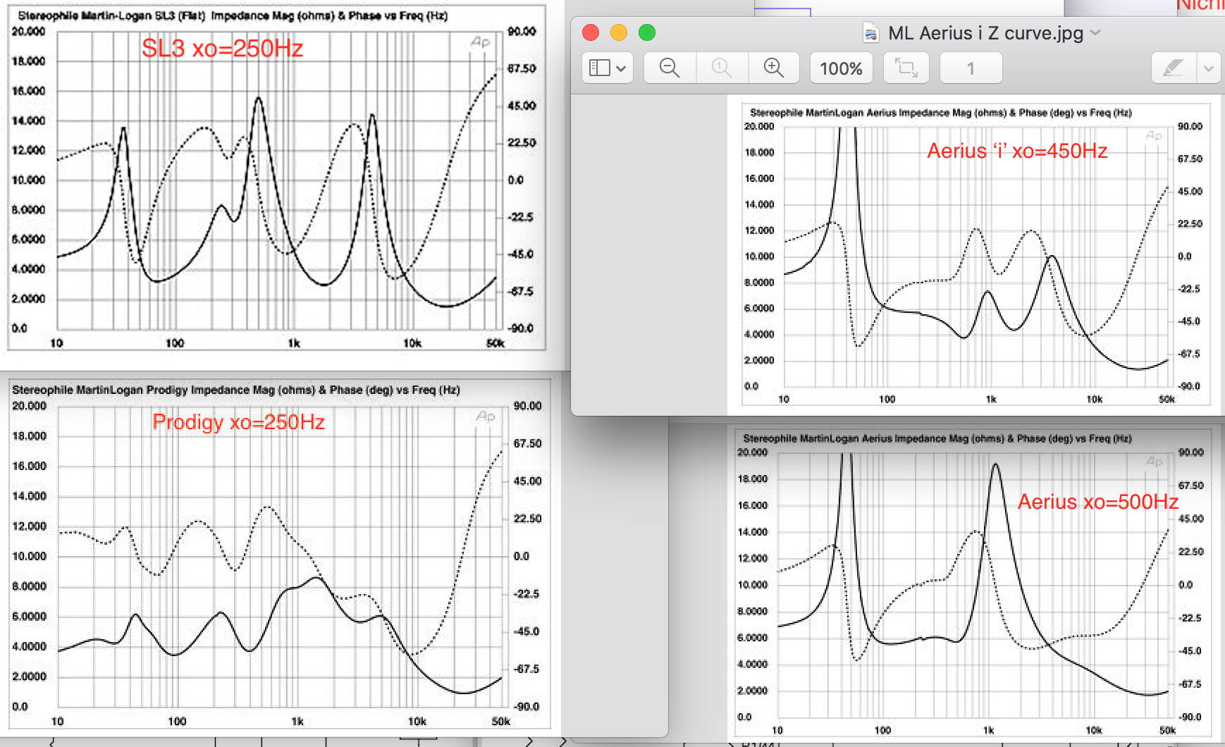

JNeutron,
Would you expand on the "25 ohms" recommendation?
Is it instructive to look at an impedance sweep for the loudspeaker which one is making cables for?
I attached a random collection of Z sweeps from Stereophile for discussion...
I chose it as a middle of the road solution. With normal zip, the RFZ is about 120 to 150 ohms, higher is typical of landscaping light wire with really thick insulation spacing the conductors.
High RFZ wire with a 4 ohm speaker makes for long settling times, 10 to 20 microseconds possible.. Low RFZ cable has too much capacitance for when the load lets go at high frequencies.
By using 4 lighter gauge zips independently twisted, you reduce the settling times of the wire/load combination without worrying about excessive capacitance. Trying to go much lower takes too much wire, and I don't think there's much to be gained.
4 twisted pairs is more practical than all those cat5e 24 pair solutions, and no stability worries.
edit: BTW, my choice of 25 ohm RFZ has nothing to do with frequency response, but everything to do with soundstage imaging.
I was looking at the so-called speaker cables in the net, and got that image from a seller's web page.
What I use is black TLYp 2x2.5mm. The price today is at 1.86$/m (equivalent). These TYLp cables can be used connect speakers. There are also 2x3.5mm, but too thick. There's also TLgYp 2x2,5mm, but the cover is semi transparent, but I like to use black cables. Same price. These are pure copper woven cables (cores twisted from soft copper wires) from a well known manufacturer. I have a 200W amp today, but I never use it more than 15%. I agree that cables crack in time, but it is easy to replace them, without a heartache.
