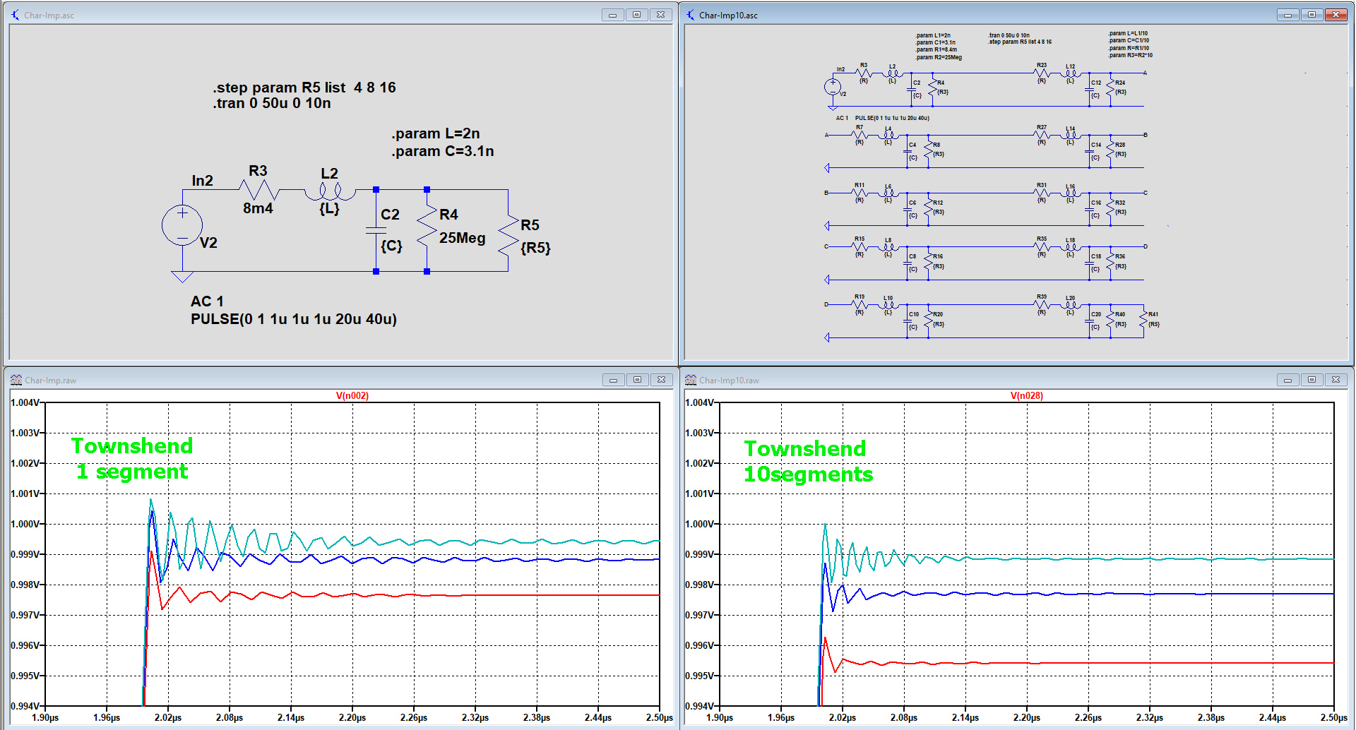

Suddenly I realised that when comparing the step response for the Townshend cable with 1 segment versus 10 segments, I should have reduced all components with a factor 10 to end with the same LRC for both.
What I did was adding 10 equal segments, meaning effectively that I made the cable 10 times as long.
For the Char Imp this makes no difference, but for a step response it does.
In the image below I have corrected this, where I still have to mention that I can't find whether the specs that Townshend provides are per foot, per meter or for their shortest cable which is 2 meter.
Anyhow, with their figures you see the step response for resp. 4, 8 and 16 Ohm for one segment and for 10 segments, where you see a faster settling time but also a larger attenuation as with one segment.

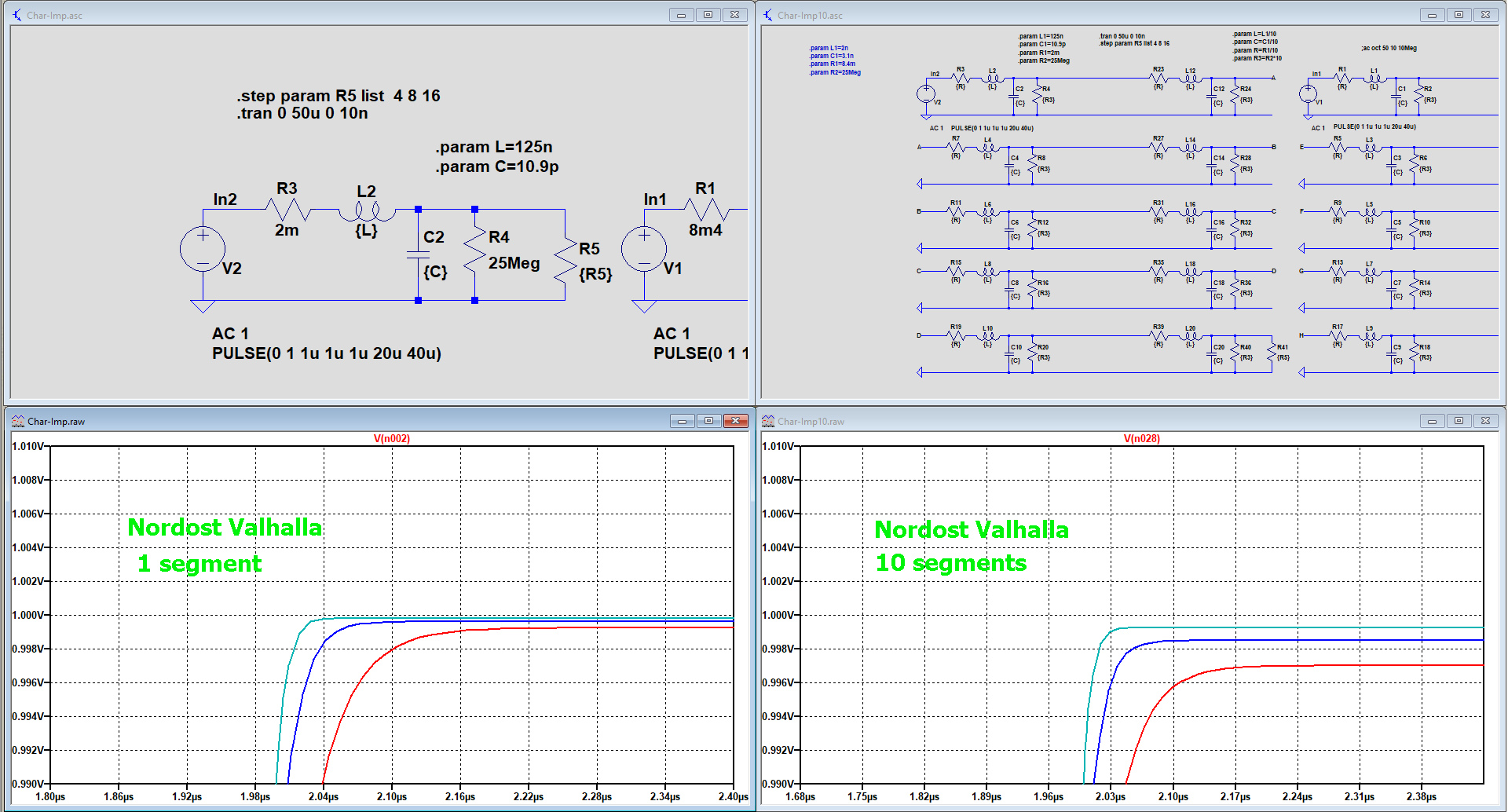

Now I did the same for the earlier mentioned Nordost Valhalla cable, also for 4, 8 and 16 Ohm
If settling time being an important feature for an LS cable, this cable behaves excellent.
Apart from somewhat more attenuation, the version with 10 segments responds almost identical to the 1 segment version.
At audio frequencies the step response is a first order low pas filter determined by the R and the L, where the C plays no role.

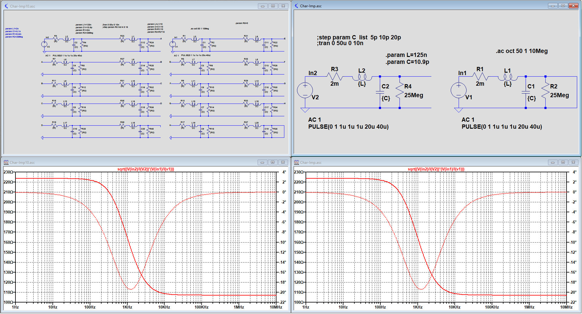

It does make a difference for the characteristic impedance: although you can stack any number of elementary, identical LPFs and get a consistent Zo (which surprised me as a small miracle), you cannot change the lump size and still get an identical result. Miracles have limits.
I showed it in one of the previous sims I posted.
For audio, it is purely academic of course, but it matters from a theoretical POV.

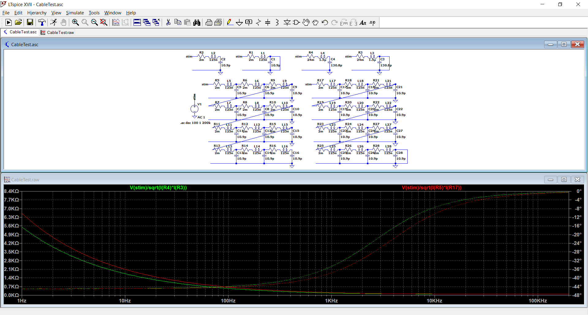

The green trace is the impedance of the lumped version; the red trace shows the values split in 12 segments.
The theory of TL applies when the elements are infinitesimally small, but it diverges with discrete, lumped elements.

Hi Elvee,
I was puzzled why the step response images showed more attenuation with 10 segments as with just one segment.
The answer is simple: an inductor has a standard series resistance of 1 mOhm.
After having corrected that to be the same between both versions, there is no difference in attenuation.
Applying that also to the transmission line equation, either by making this series resistance zero or giving the 10 segmented version a series resistance of 0.1 mOhm, results in exactly the same Char Imp figure.
See below for all series resistance set at zero.
