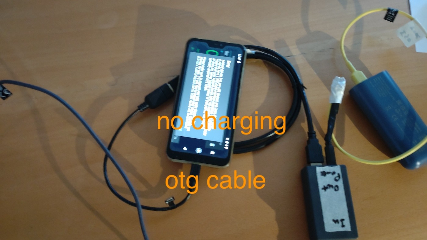

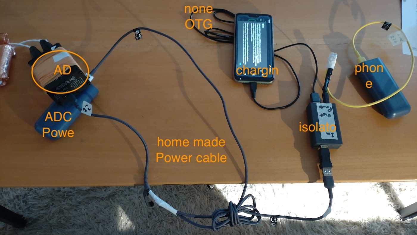

- I have a working recording system using an OTG cable between the ADC and the phone.
- In order not to drain the phone from power feeding the ADC, I have made an y-split cable to connect a IKEA USB battery bank - it works good.
- Using an ordinary USB-A to USB-micro (phone), the phone is charging from a battery bank (an other IKEA unit)
- Using an OTG cable, the phone is not charged.

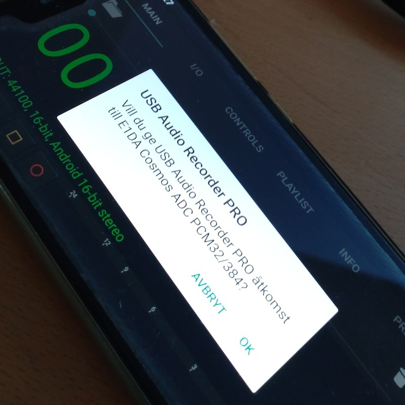

- In none of the two cases above with the isolator do I get any signal transferred. The phone app says in both cases: "No USB recording device detected".
- Isolator: https://www.altor.co/products/test-equipment/usb-isolator
- ADC: Cosmos
- Software: USB Audio Recorder Pro 1.61.0
- Phone: Mi A2 lite (Android 10)

That worked ;-)
Almost - for some reason 16b and 32b recording seems fine but when set to 24b (all for 384ksps), the VU meters go to the roof with some slight movement while red... strange!!
Now how to power feed the Mobile for long recording sessions... an other y-split USB-C_USBmicro cable!?

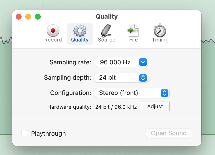

I check with what I have... the native audio setting application Audio/Midi lists 24b as an option.
and my DAW, Amadeus Pro - both seem to accept that 24b can be negotiated and set. The Amadeus has a Quality pane with a button that says Adjust hw as I understand it .. once pressed it changes form 16b to 24 as requested, took a second but it change to and acknowledged 24b.

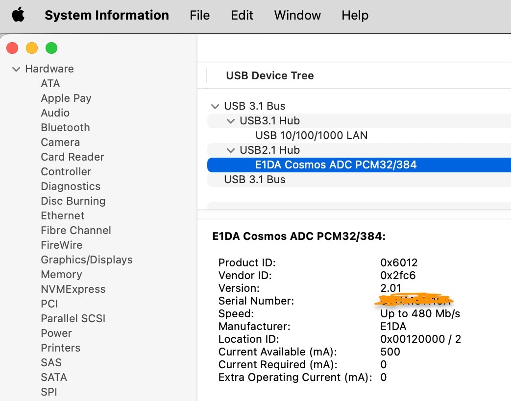

Checking the device in under System Info gave.... but no bit info...
To me it seems like the ADC offer 24b - I will try to enter that command to see what it gives...

It may seem but we have no idea what goes between the device and these screens. The ultimate information is the actual USB configuration. Either directly, as e.g. listed by lsusb -v in linux (using the userspace libusb library), or reported by linux usb-audio driver in the stream0 file (e.g. https://alsa-devel.alsa-project.narkive.com/OJHvIzOP/correction-audiophile-usb-stream0-output )
There are more libusb-based USB viewers, maybe even for mac. You can try some.
