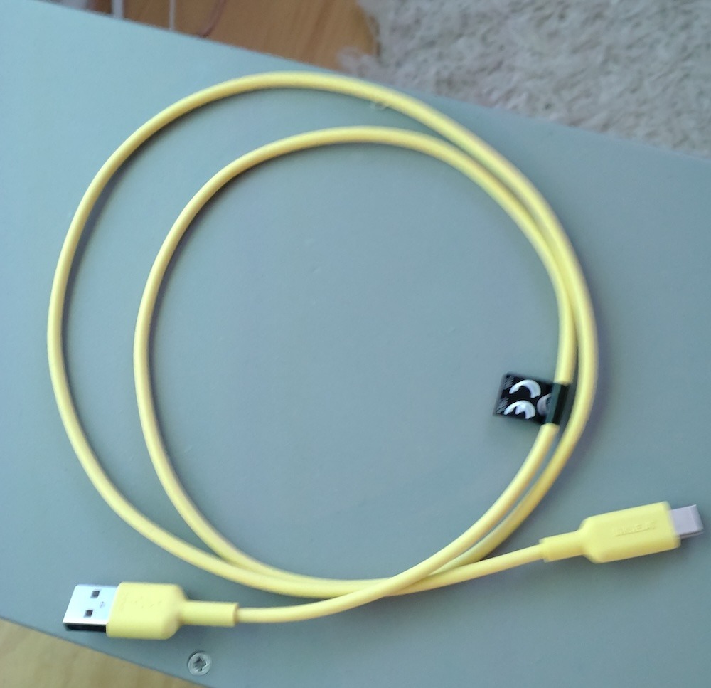

Actually should the device fail to switch from fullspeed to highspeed, the effects may be like those reported. Checking the actual device speed in linux is with 'lsusb -t', no idea if it works on OSX too but you can try.Well then your isolation chain does not seem to work correctly, at high speeds.

USB checks parity bit for each USB frame. If the frame is corrupted, it's dropped - causing missing data in the stream. I have had a few bad cables which caused currupted -> dropped packets. Since your device requests/sends packets every 125us (bInterval = 1), some dropped packets do not cause total loss of the stream, but an audible corruption.

Okey, so here comes the resolution of the case...
I just changed this one cable and everything works like a charm.

Here it is... never thought there could be such a difference with a USB cable... such low speed also... well, well...
Replaced by another no fancy black one from I don't know where....

- Yellow IKEA USB-A / USB-micro is no good.
