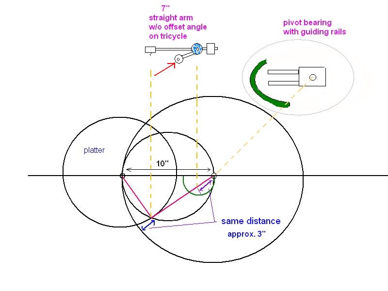

The above is a diagram of the working of the Thales arm. Now, if I eliminate the arm from M to C completely, what is left is the triangle inside the semi-circle that C is always tangent to A. The hitch is that we have to come up with a design to allow the distance between to B to C to change about couple inches. In this case, there's no need for any pivot or bearing at the headshell area at all, just a straight wand. We can have a fixed arm length and the arm's base sit on some linear motion bearing or a tricycle platform that can move front and back and the middle wheel to steer the tricycle in a curved track that allows the arm to be tangent to A at all time. Essentially an assembly that allows pivoting and linear motion at the same time.
Look at picture below and I hope this makes sense.
Arm in motion
![5.gif](https://www.6moons.com/industryfeatures/thales/5.gif)

However, just to indulge you for a second, I have thought of something along similar line is to create a gliding armboard that allows a conventional pivot arm to work as is but to servo correct the microscopic out of tangent arcs via motor and sensors. There are linear motion guides and bushings out there that have no slops that are quiet and smooth such as products from THK. Not all pivot arms are good candidates to be mounted on such motorized gliding armboard because some arms have offset headshells that are not suitable for this operation and arms with J-shaped or S-shaped armwands make matters worse. But the worse is the kind with offset bearings at the pivot point. Looking through available modern tonearms to find a good candidate for such experiment, one must find an arm with straight wand, no offset headshell, and no offset bearings. And the best arm I can think of right now is the Clearaudio Satisfy arm because it has a rotatable headshell, straight armwand, no offset bearings. And one can easily defeat the antiskating mechanism. The arm itself is visually quite elegant looking too.
I think the rotatable headshell allows for experimenting with adding a pivot point about the stylus to turn it into an RS Labs RS-A1 type of arm. Just a thought.

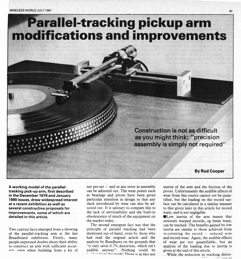

Looks like someone in 1981 Wireless World was thinking along similar lines. I wish I can find the complete article.

I need to do some more research on these mechanical issues with this type of arm, will post some drawings after some more thinking.![headbash :headbash: :headbash:](https://files.diyaudio.com/forums/images/smilies/headbash.gif)

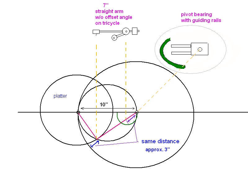

What I have in mind recently is along similar line. If you look at the Thales semi-circle, the headshell need not to be offset if we can change the effective length simultaneously moving across the arc. In any pivot arm, the swinging is a radius of a circle and we don't want to do that. If we can come up with a mechanism that change the length the cartridge can remain tangent drawing a line to the spindle. Let's say we have an armature that's 10" from the mounting to the spindle to form an 10" effective length arm but the armwand that carries the cartridge is only about 7" so we have about 3" sliding to do and this can be achieve via guiding rails for forward motion and swinging motion in essentially a tricycle platform where the armtube sits. Please look at the crude drawing and I hope it gets the idea across.
It might look complicated by it's actually quite simple. One can implement all the pivot arm concepts we learn in the past into this and the tricky part is the linear motion bearing, the tricycle mechanism. I am constantly thinking ways to reduce parts count and mass. The advantage of this over the Thales tonearm is that there's no pivoting headshell and no bearing near the cartridge, no vibration. Geometrically less ambiguous. Low vertical mass since the arm is only 7" long. Horizontal mass is a touch higher than typical pivot arm and it's similar to the Dynavector. The downside is that we have to rely on linear bearing which can result in high friction. An all pivot approach is doable if we use a parallelogram but that requires many pivot bearings and linkages - I will have to think about that for another project. Since I don't have a small lathe for me to experiment with physical objects, I just have to continue to headbang myself. Sometimes it hurts my brain, but as a masochist it can be quite fun.
