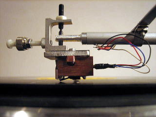

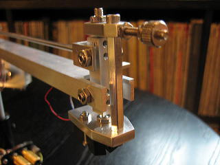

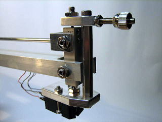

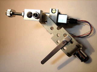

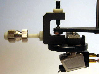

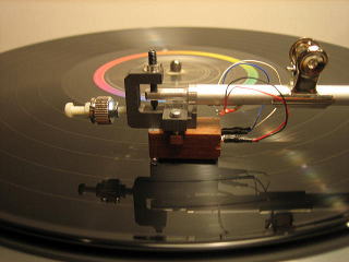

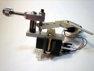

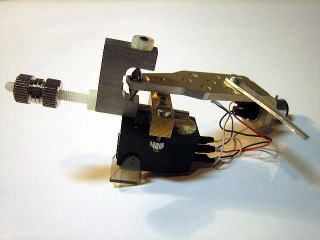

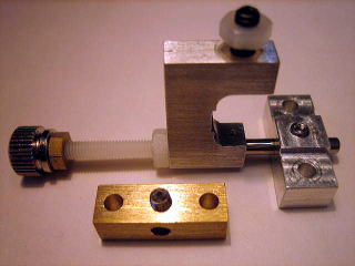

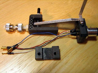

Here's another idea, horizontally it has three pivot points which is a lot and may be difficult to make it work. The idea is to keep the split plane concept like the Dynavector but imagine the arm is extendable just like the one of two lines in the Thales triangle. But the guiding requires moving arm base with a magnet tracking, not touching, a steel rail below to keep the cartridge in tangent.
The red guiding arm is similar to what I proposed earlier with the tuning fork idea. Sorry again for the crude drawing.
I am working on another idea that can will reduce the pivots.
![28t99vq.jpg](/community/proxy.php?image=http%3A%2F%2Fi45.tinypic.com%2F28t99vq.jpg&hash=0b54d990292ace1ccbb5b0886762b797)

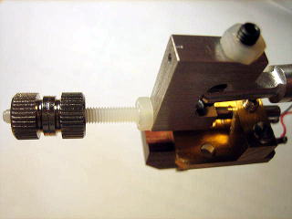

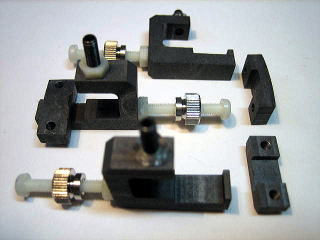

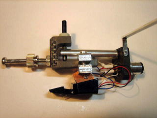

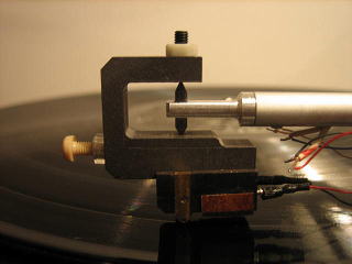

Hi again!
And thanks for pointing out the thread on the italian forum above. I just like to point out that I wasn't aware of it and had no intention to copy anyone without permission. In fact I got permission from Micha Huber to show that arm. And I had conceived it quite some time ago(together with various other solutions for pivoted linear tracking arms), mainly to combine the positive traits of the RS Labs arm with the zero tracing error offered by the Thales arm. I'll never be a commercial product, only built to find out if the added complexity outweighs the theoretical benefits. Which brings me to the "sound" of this arm.
Extremely tight and well controlled bass, mainly due to an effect that hasn't been discussed here. The arm-cartridge resonance frequency in the horizontal plane is nearly undectable if the thread tension(restoring force), combined with the inertia of the pivoting headshell+cartridge leads to an fres exactly at or near the fres with a fixed headshell. It acts as an anti-resonator.
Since the arm is so short(185mm eff. l.), energy storage/armwand resonances are very low. Image placement and specifity is exemplary. Build one and you'll hear how well it works.
Hope those italian DIYers get to read this as I don't speak or write italian. Don't want them to think I presented myself as the inventor of the Thales principle. Quite the opposite. Micha Huber deserves a lot of praise for his out of the box thinking.
All the best,
Frank
All the best,
Frank
berlinta:"Which brings me to the "sound" of this arm. Extremely tight and well controlled bass, mainly due to an effect that hasn't been discussed here. The arm-cartridge resonance frequency in the horizontal plane is nearly undectable if the thread tension(restoring force), combined with the inertia of the pivoting headshell+cartridge leads to an fres exactly at or near the fres with a fixed headshell. It acts as an anti-resonator. Since the arm is so short(185mm eff. l.), energy storage/armwand resonances are very low. Image placement and specifity is exemplary. Build one and you'll hear how well it works."
Thanks for sharing your experience, Frank! I forgot to ask how well does it handle warped records since the armtube is so short and there's constant lateral force to the right which I imagine to be stronger than usual for it to guide within the Thales circle. I am looking into my pile of spare arms and parts for a good candidate for this experiment. I imagine an arm with no built in antiskating mechanism would work, like the Audio Technica ATP-12T, which unfortunately I sold last year. I have a Kenwood KD-770D that has a straight armtube with no offset angle that just might work...
I also wonder if unipivot is a good or bad idea for this type of design. Your arm is essentially a unipivot design so I guess it will work. The pivot point of the string will act as stabilizing the unipivot provided the height is matched to the main arm's pivot point.
Hi again,
Warps appeared to be no problem. After all the arm is still many times longer than, say, a Souther, Revox or (part)Dynavector arm and the actual vertical pivot point is quite close to record level(unlike above mentioned arms)
Unipivots are (almost) as suitable as gimballed arms for the Thales thread assembly. Mainly due to the fact that the thread exerts very little force! The headshell bearing(s) need(s) to be of the highest quality. An additional skating compensation mechanism is beneficial since one can dial in a combination of (positive OR negative!)"conventional" antiskating force and restoring/antiskating force resulting from the hanging weight. Ideally if the hanging weight was chosen to compensate the skating force, the restoring force(the "tangential pull") should suffice too.
BUT!!! (ha, there's no free lunch..
Changing VTA by raising or lowering the arm bearing is likewise problematic.
For a commercial product, the above spells DESASTER. Thank goodness we're surrounded by likeminded nuts
Wiring is the next problem. After looking at the pictures of the short arm, you can imagine that one doesn't want any "spring" connecting the headshell with the armwand.
Yup, there are easier ways to play a record, they're just not as much fun...
Frank
