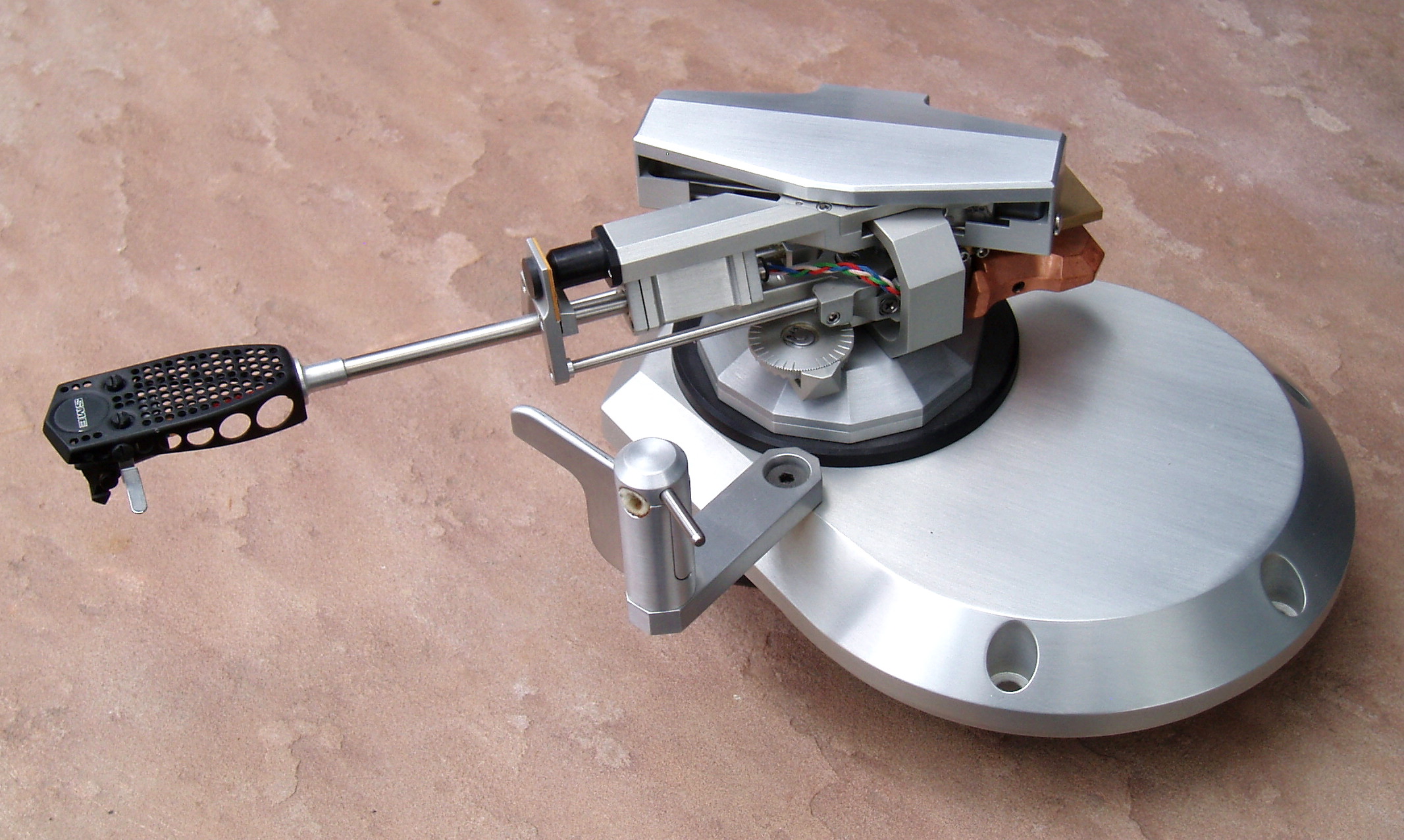

In the early eighties I patented a tone arm as you suggest.
It was a sliding, pivoting, tangential arm. My patent covered a purely
mechanical version and a motorized version. I built a prototype of the
motorized version, which functioned fine. Because of the fact that CDs
came on the market about this time, I decided not to build the mechanical
version of that arm. Three years ago I found out that vinyl was still very
much alive and I decided to resurrect my tone arm and give it another try.
The first arm was designed on the drawing board, while the one I'm working on now was designed with CAD software which I had learned in
the meantime.
The arm is straight, no offset. Its length is 7.950" and its pivot is attached to a carriage which rolls on a track which is 1.550" long.
The track's centerline is in line with the center of turn table platter.

I've been out of the loop on this thread. Wow, Straight Tracker, that's a fascinating tonearm! Please tells us more about this and elaborate on the mechanism. Is the one in the picture a mechanical arm or a motorized one? I notice there's no pivot at the headshell, (good idea) so I take it to keep tangency, the armwand has to be able to lengthen and shorten according to pivoting of the arm to stay in the geometry of the Thales semi-circle. My complaint of the other arm is that the pivot is at the headshell and that might create too much vibration so close to the cartridge and the added mass. By shifting the extra pivot closer to the armbase can be beneficial but require more complication in the design. I'm glad someone has done it and made it work! More pictures please!

My patent covered a motorized version and a version that was driven by friction. The one in the picture is the motorized version. The one I'm building now is driven by friction. The motorized one uses an Airpax 15 degree stepping motor. The arm is dynamically balanced an its pivots are mounted on a carriage which travels on a track whose centerline runs through the center spindle of the turntable. The track is only 1.550" long! the track is located in an overhead housing which makes the arm look mechanically busy. I started to make an improved version in the late eighties but abandoned it because it still had the overhead track. Lately I was able, with the help of CAD, to relocate the track into the base of the tonearm. It looks quite acceptable now.
My aim is to create the perfect tangential tonearm and not nessecarily the simplest. What I would like to do, is create a new Thread on this Tonearm because I have done a lot of research over the years and I have a complete photographic history which I would like to share.

It is very hard to explain things properly in short blurbs. Actually my Patent has expired many years ago. The tonearm in the photo uses no side forces to make it track. There is an optical sensor made by Hewlett-Packard that controls the position of the arm. The version I'm building now, relies on friction in line with the centerline of the tonearm! Since I haven't finished it the idea remains a theory.
Tomorrow morning my Wife is going to scan additional photos etc. which I will post in a new thread. I think it will be much clearer then as to how the tonearm works.
I have looked into measuring distance with a laser, but found it to be very expensive. A company by the name of Keyence makes them. When I start my new thread, it will become apparent that the method I use to maintain position is quite effectve.

Can we see some other pictures of that arm!
Thx
Regards zeoN_Rider
I'm working on it as we speak.
I'm having a problem with uploading PDF files. Being new at this, I don't seem to be able to reduce the file size enough for uploading.
