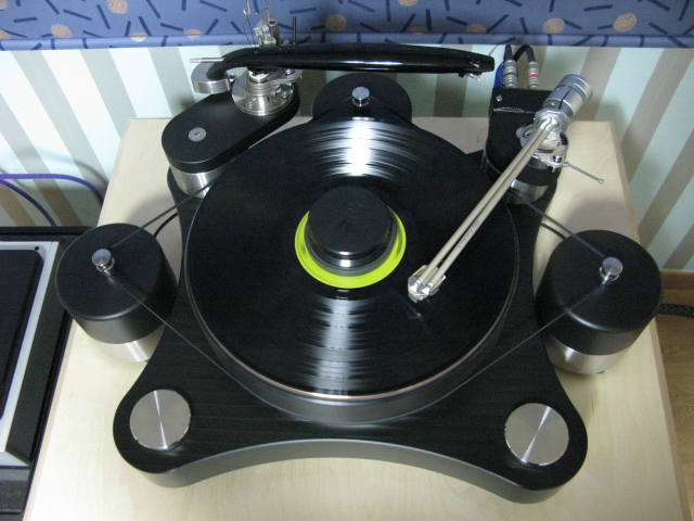

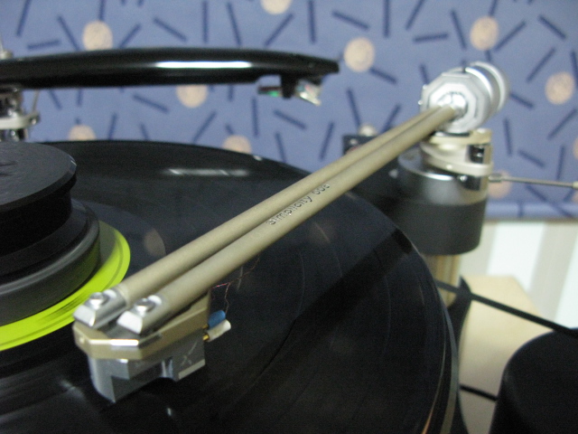

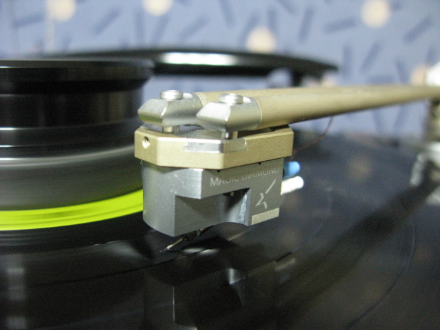

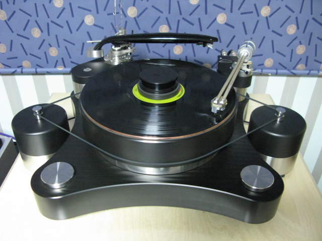

Thales Simplicity tonearm pix
More nice pictures of Thales Simplicity tonearm. I think I like this arm even more than the flagship model.
__________________________________________
