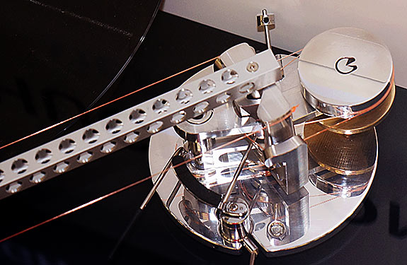

PLT = Pivoting Linear Tracker.
I've been playing with this concept a while, here's one of my efforts. As you can see this is a proof of concept prototype made with bamboo sticks and scavenged bearings. I would have used better bits for the next version if I hadn't come up with a different design which I like much more.
I blue-tacked a pointer to the headshell at 90 degrees to the cantilever. It points directly over the spindle at 60mm radius:
And also at 150mm radius, and all points in between to within 0.1mm.
BTW the data on these pic files says they are over three years old, so obviously I'm not going anywhere with them. Anyone who wants to use the ideas can.

Arms that move on rails do indeed follow the original cutter path perfectly, but that's not the whole story. The entire arm mass (counterweight, pivot housing, arm & pickup) must be moved as well. Since the arm stays perpendicular to a radius, how can its pickup move inward across the record? The answer is, "it can't." The spiral groove pulls the stylus (cantilever) out of position and the mass is dragged by it. This is very bad for the record and stylus, not to mention the sound. "Air-bearings" remove rail friction, but the mass must still be handled.
Based on my readings of Poul Ladegaard, the above is nothing more than a common misconception. But since this is a pivoting tonearm thread (and I love it so much), let's pretend that linear trackers have some kind of inherent issue.
