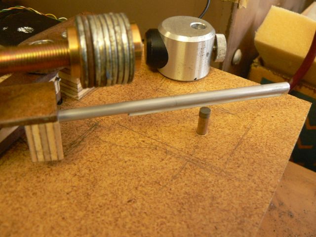

magnet B
DD,
Thanks for prompting me to revisit the magnet point idea. I swapped a small magnet and ferrous wire attractor for the Heim joint and it shows real promise. Even this quick lash up sailed through the first side of "Time Out" with almost no problems and I liked the sound - very delicate and detailed.
The magnet induced torque on the guide tube is a major concern. The pivot arm has to be built very carefully to eliminate slack that allows the tube to drop toward the magnet. Given that, the magnet could be brought closer to the attractor to firmly lock the guide tube in place.
Mark's design in #510 was one I had in mind when I started this project, but I had it backwards: I was thinking of two uprights and one guide, which won't work because friction increases as the angle changes.
Mark: I really like the idea of the solenoid guide/damper, but I think it's beyond me.
I like Simon York's design and I think it might be possible to extend it so a unipivot Birch arm would be possible, which would eliminate four bearings and lighten the load on the remaining two. The magnet guide probably won't work with the unipivot, but with all the other guide possibilities, the trade off might be worth it.
The problem with the magnetic guide is that the tracking error varies with the friction of the stylus. The magnet introduces a new eigenfrequency as well, since the coupling between the magnet and the guiding rod is not stiff.

I expected the loose coupling between the guide and the magnet to introduce tracking error distortion or resonances (eigenfrequencies - what a great term. I had to look it up) especially bass notes or piano chords, and was surprised to not hear either. I know that's subjective and measurement might show something different.

I made a quick attempt at the over/under magnet arrangement DD suggested and - to quote Mark Kelly - "ran afoul of Earnshaw." With an absolutely rigid mount for the guide rod, it might be possible, but probably not worth the effort.
alighiszem: After the dual magnet experiment, I went back to the Heim joint. Starting with the first cut, it was obvious the dynamics had improved significantly so you're correct that tight coupling at the B point is essential. Kind of a shame about Earnshaw and the dynamics. I had hopes the frictionless guide.
