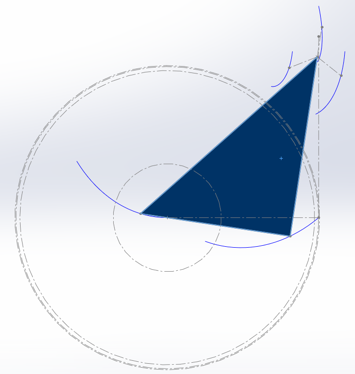

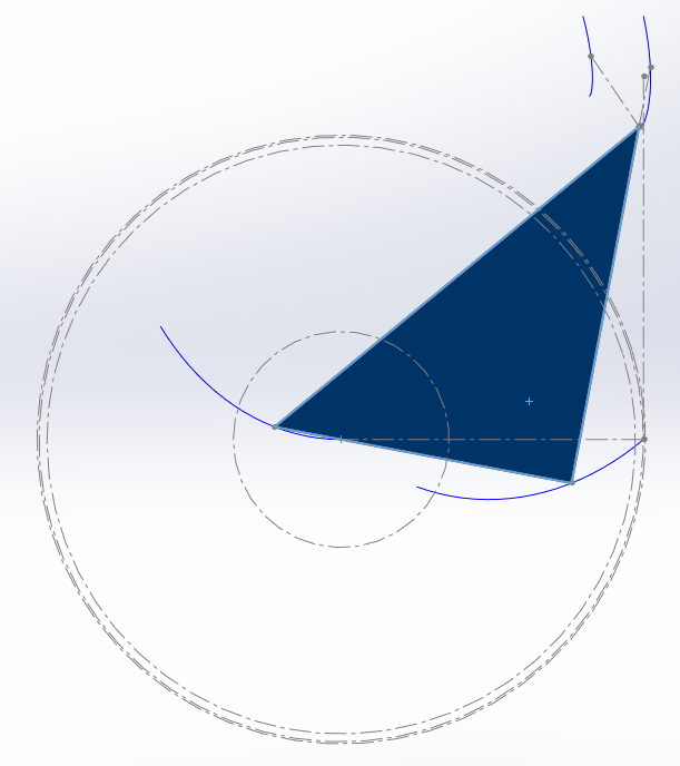

I think for simplicity sake, you can try a tricycle like carriage on three curved tracks. The placement and angle of the rollers are critical in guiding the armwand moving tangentially. In this you won't need horizontal bearing, only vertical bearings for up and down movement. If ball bearings are used they should be U-groove or V-groove to roll on curved tracks. Obviously the placements of the three separate curved tracks are important. The 3 tracks can be submerged in oil or fluid for lubrication and damping. All of this can be achieved passively without any servo. (This harks back to Straight Tracker's invention). You can even try Vee-jewel bearings to reduce friction like some project.
Yeah I like the 3 track idea. You could go balls to the wall and use mag-lev now because of the constraints you can get from 3 contacts. All three carriages are magnetically constrained from bellow and the inner edge of tracks and with a sapphire v-roller on the outer edge. Rock solid and very very low friction, and no servo.
I've completed the math for the tricycle curves. There's are no tangency errors on them.
The direction of the tricycle arms can be translated in any direction and can form any triangle and it will still work, but this looks nice.
Stylus drag pulls the tricycle along nicely as it's all downhill (they share vectors), might be a bit of a problem with records playing from the inside out as the motive force would have to come from the angular contact.

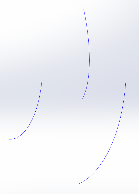

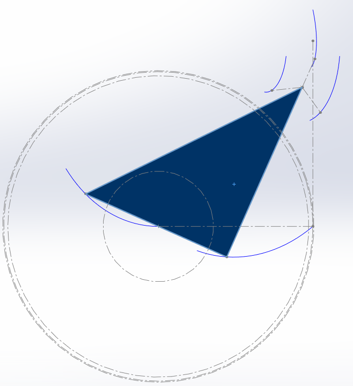

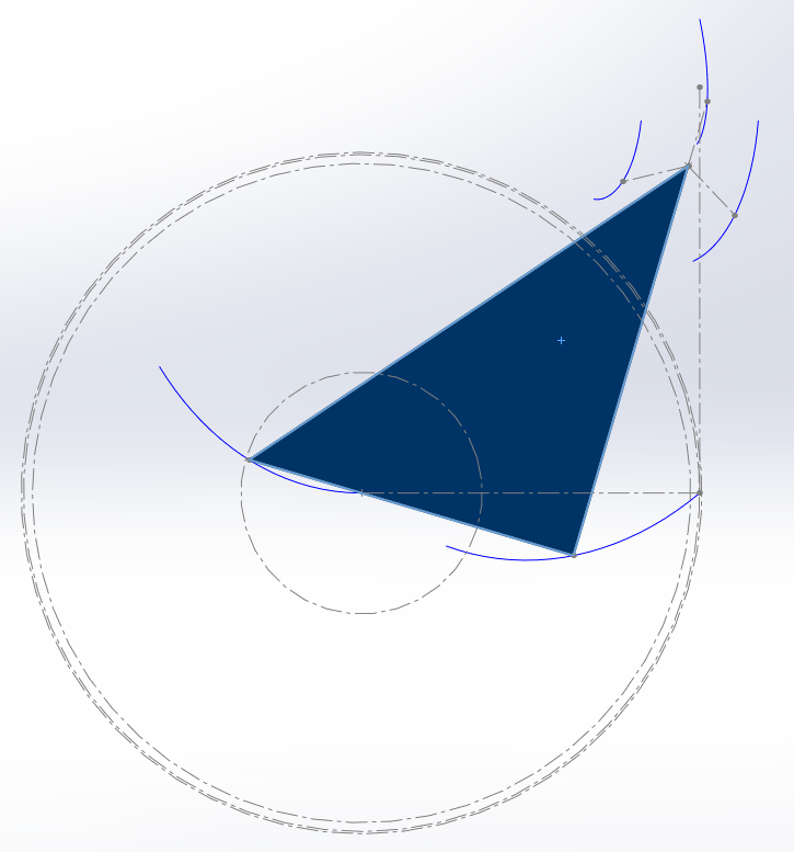

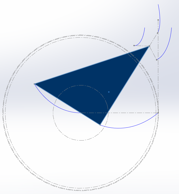

I've completed the math for the tricycle curves. There's are no tangency errors on them.The direction of the tricycle arms can be translated in any direction and can form any triangle and it will still work, but this looks nice. Stylus drag pulls the tricycle along nicely as it's all downhill (they share vectors)
Excellent work! The tricycle idea was suggested years ago in post #19 and #21. It was a crude concept back then and I hadn't refined the idea until recently. Your placement of the 3 points are better and simpler. I just love your graphic skills!
I abandoned the idea due to my stubbornness about not using linear motion bearings and (after all, this is a thread about pivoting genre) thought a parallel tracker would do the same. But you're right about the shared vectors that the stylus drag force pulling the tricycle is much smaller than a parallel tracker. I think this has a lot going for it and easier to use ergonomically as it works just like any pivot arm. The main armwand is similar length to most 9" pivot arms and, for DIYers, it can be salvaged from broken arms and be repurposed to attach it to the tricycle, as long as you take out the 23° offset angle at the bearing. And yes, you can even use magnet to lessen the mass.
The key is to create the 3 curved tracks precisely and make the tricycle moving smoothly with low friction. I'll leave that to the more creative and resourceful members here.
People who spend time playing inside out records probably don't care about tangency. 😀

The overshoot is constrained by no horizontal bearings coupled to the rigid triangle of the carriage. The geometry solves true for any point in the groove with 3 points on the guide curves. For there to be any overshoot, that triangle will need to deform. I have a preliminary mechanical model where 3 jewel wheels, mounted on that rigid triangle, trace those guide curves. The contact points of the jewel wheels form the rigid triangle.
In simulation I can already see this effect, if I apply a constant force in the -y direction, the wheels bind onto the guide curves. The carriage only starts moving if I change the force vector to the tonearm vector.
I haven't measured it yet but suspect that the bind force on the wheels increases with the deviation of the two vectors linearly.
I do not yet fully understand the effects of the bind force on the wheels, but will have a clear picture once simulations are completed.
It certainly won't be a easy to build, and simulation to successfully implemented not guaranteed.

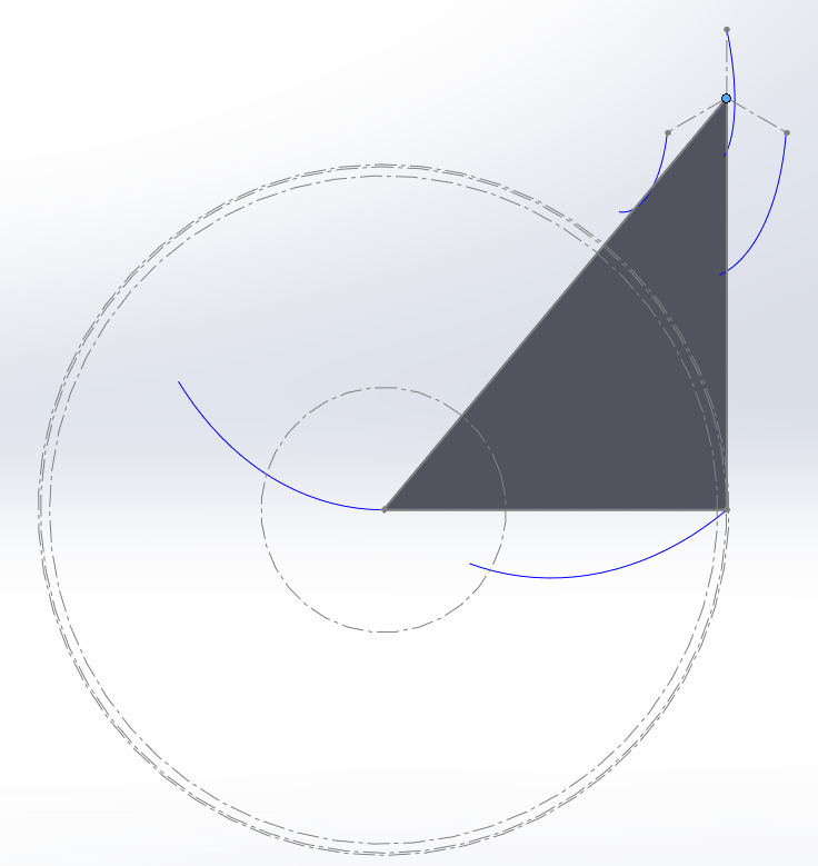

While looking for other triangles that would still solve, I found that removing one of the curves, translating one curve to form a right angle triangle with the stylus as the third point works fine.
This would be easier to built as the sharp curve on the innermost curve was problematic.
On the other hand, overshoot looks like a bigger a problem now, but the arm length can be reduced by another 30 mm.

What if the wheels are angled 45° toward the curves instead of vertical, provided the curves are round rods and the wheels have U-grooves?
That does look simpler and easier to build but in your drawing all the tonearm mass is concentrated in the front point/wheel. Is there a graph that places the arm location at the center of the triangle so mass is equally distributed?
The 3 points 2 curve approach reminds me of some curved linear slides.
I'm thinking 90 Deg wheel running a knife edge along the side of the curve, but your idea would be easier and cheaper. Bending a rod accurately will be a mission though.

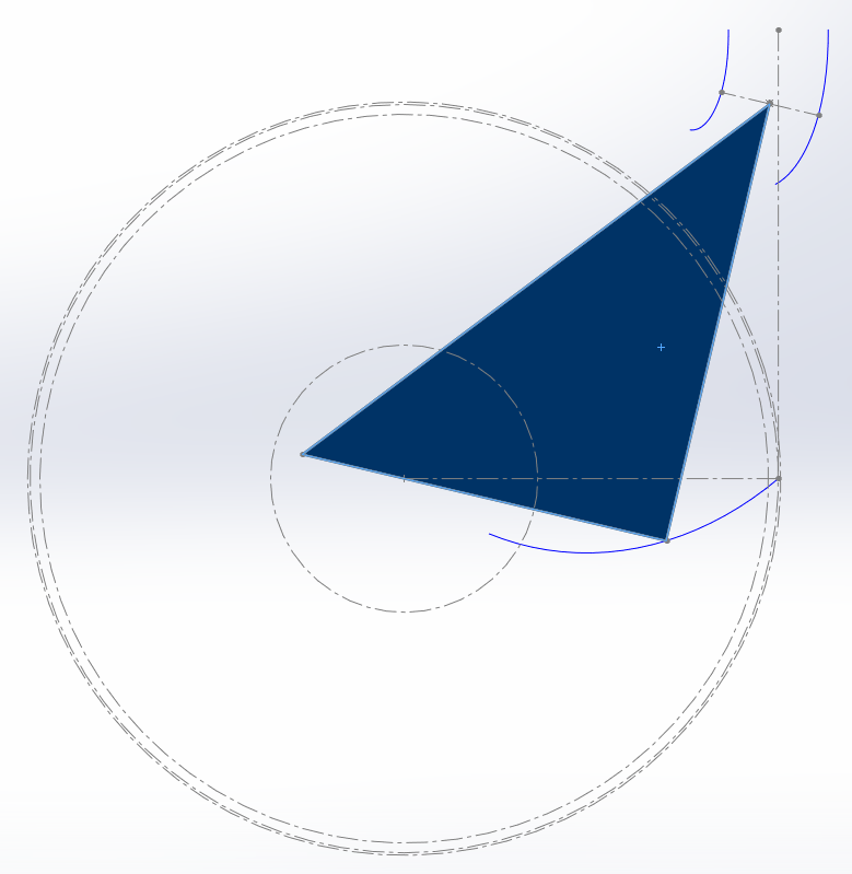

Yes, those curves can be placed anywhere, it will make the arms a little bit longer, closer to a 9". I'll cook something up.
Yep, that's what I'd like to do but with 90 deg wheels and magnetic lift.
The tracks can then be lasercut to +-0.25 micron.
To be honest, as a DIYer I prefer the arm to be 9" so I can repurpose existing conventional 9" arms. If arm length is a concern, the curves assembly can be placed ABOVE the arm (yes, a hanging tonearm) and even cantilever slightly over into some record area and you can have an armwand no more than 5 or 6 inches.
Obviously if you want the vertical pivot point located at the record height outside of the (12" type) platter size, then the arm must be longer than 6 inches. With your graphic and geometric skill you can play around with all the permutations and find the optimum geometry.
Something like this?
Unless I'm not seeing correctly, looks like you're missing the third point/wheel of the triangle...
