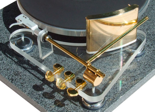

Schuchtronic tangential tonearm 2017
Looks like Schuchtronic completely dispense the pivot headshell tonearm and created another "string" tonearm with a different concept. Very unique and nothing quite like it! Check out the two YouTube videos below:

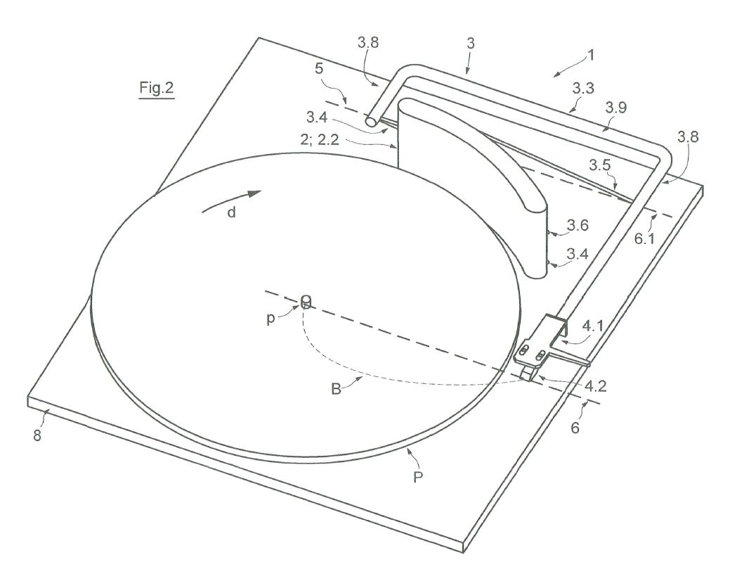

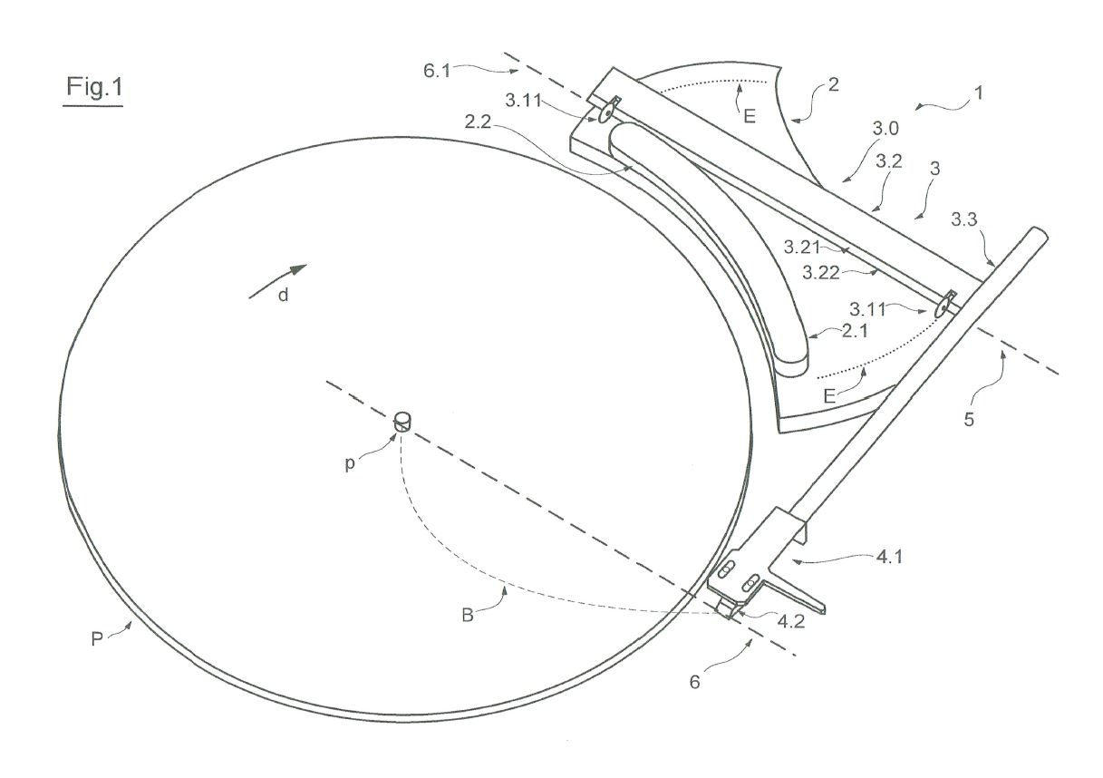

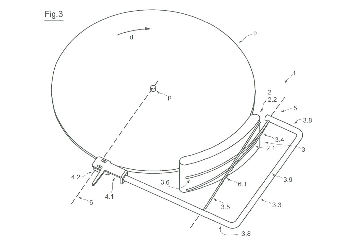

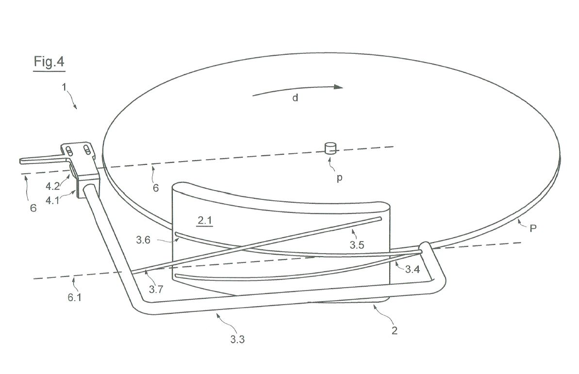

I looked at the YouTube videos and the patent. Don’t know German but you can get the gist of how it works from the patent drawings. It does appear to be different. Figure 1 is an implementation with rollers (3.11) and is good for visualizing the concept. Stylus trajectory would be determined by the curve characteristic of (2.2).
Figures 2, 3 and 4 look like the production model, except that the production model appears to have an added refinement in that the rear rod rests directly on the curved ‘wall’ (2) and does not rely on string tension alone to restrain fore/aft movement of the entire arm.

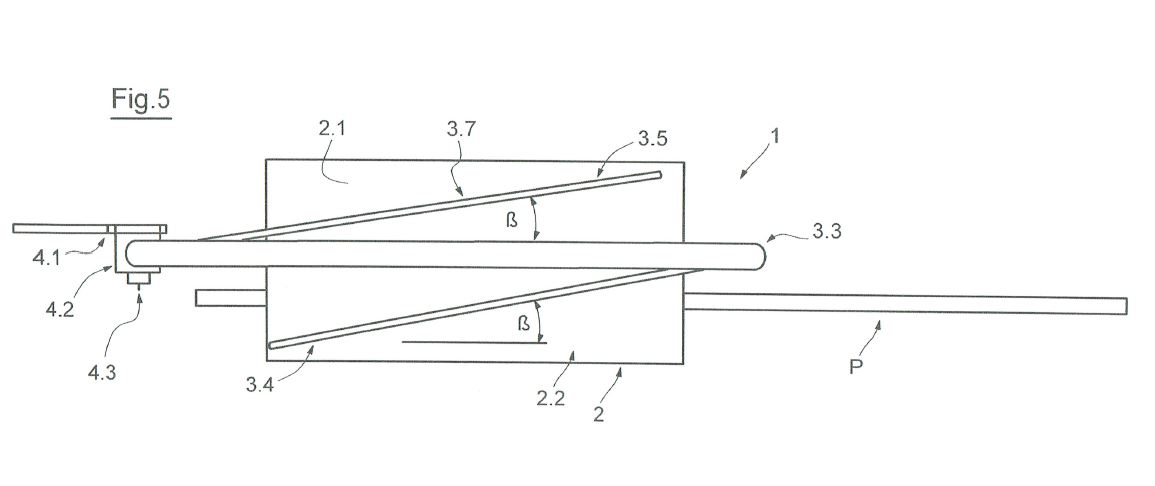

Figure 5 was the ‘light bulb turning on’ showing how the vertical pivot was implemented. The vertical pivot axis is between the left end of string (3.7) and the right end of string (3.4). The relative tension of these would determine pivot height and cartridge azimuth. The tension of these two strings holds the back rod against the curved surface of ‘wall’ (2), and forms a pseudo horizontal pivot that ‘rolls’ along the backside of (2). There is a third string adjustment in the post #1191 photo that I haven’t figured out yet. Anyone?
I have concerns about strings (3.7) and (3.4) under tension vibrating as in a guitar or piano, but there is something that concerns me more. Note that the effective offset angle of the arm varies considerably across the disc playing area as the arm’s vertical pivot ‘rolls’ on the curved wall. Just eyeballing the dimensions in the photograph, the effective offset angle at the outer grooves looks like it could be something on the order of 40 degrees, which would make for some horrendous skating forces and cantilever stress. Does anyone see anti-skate compensation anywhere? I don't.

I thought at first sight that the gold/brass curved piece was a hipflask!
...and toned arm.

A couple of thoughts about the Schuchtronic and Guha arms: The Schuchtronic is so goofy/unique that I really hope it works despite one or two theoretical problems. From a DIY perspective, how can anybody not get a kick out of guitar string tuners repurposed despite concerns about string resonances?
The double bearing arm in Fig. 1 is clever, but will probably have binding issues between the bearings sides and the groove sides. That can be mitigated with very precise wheels and grooves, but that puts the construction well outside most DIY. I'd liked to have been around when Daniel Schuch realized he might be able to achieve the same design with strings. In both designs, he seems to have used an elliptical arc - Schroeder - instead of a circular arc - Birch - which might lead to nearly perfect tangency. I share Ray K's concern about the offset. I wonder if there might be a virtual pivot that alleviates that problem.
Without string 3.6, the whole thing will collapse. It provides the second leg of the triangle that supports the outside end of that segment of the arm.
