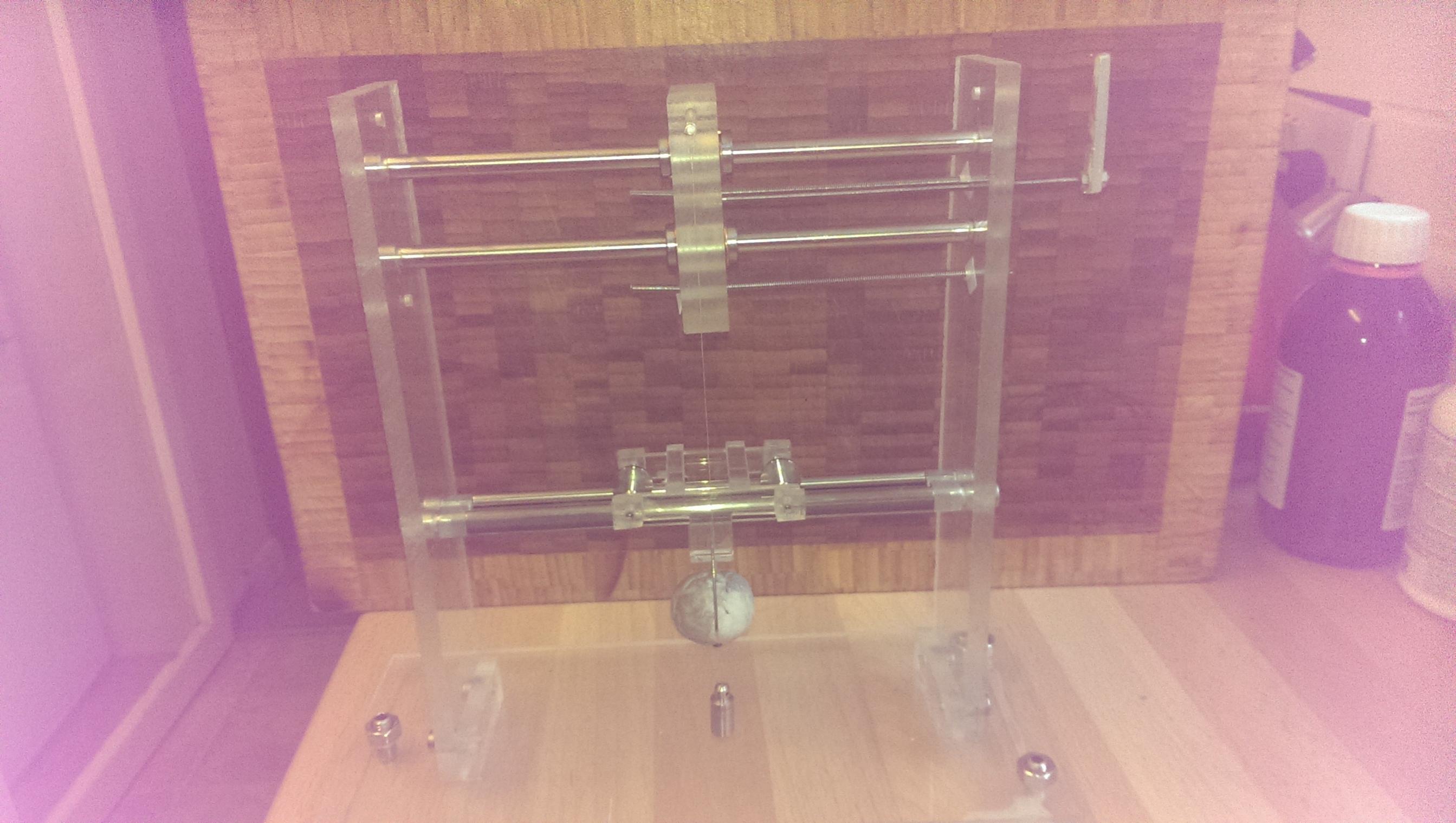

It might be worth your while to build a measurement rig to enable you to accurately determine the side force required to move the arm. This is what I did when developing the bearings for my arm. As my arm is a linear tracker the rig will be different than you would require but the same basic principle can be used. Unfortunately my camera was playing up when I took this picture but it should give you the general idea.
Like your previous rig it uses a pendulum. The pendulum is hung from a slider that runs on a couple of linear bearings that are pretensioned with a couple of springs to prevent slop. The slider is moved by turning the handle seen in the top right of the picture. The handle is attached to an M3 threaded rod so that one revolution moves the slider by 0.5mm. The thread of the pendulum is made from a couple of strands from a piece of dental floss and has a 6g weight at its end.
For my tests I used a mock up carriage that had the same mass and bearing spacing as my actual carriage. The string of the pendulum contacted a rod protruding from the mock up carriage at exactly the same location as the stylus would be. The drop was about 150mm.

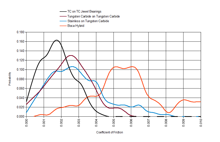

One full rotation of the handle equates to about 0.2mN of side force. Start with the string just touching the rod then slowly wind the handle until the carriage moves. A bit of trigonometry and you can calculate the exact side force and the coefficient of friction of each bearing. I repeated this process about three hundred times for each bearing type. Time consuming. From this I could plot a graph of c.o.f. against probability. This told me not only average friction but also the mode (the most common friction) and the consistency of the bearing. Ideally you want low friction that doesn't vary much.
The graph below shows some of the bearings tested. A taller peek further to the left shows a more consistent lower friction bearing.
These are of course for a linear arm so are not applicable to your arm but gives an idea of my development process. I hope that this is of use to you.
Niffy

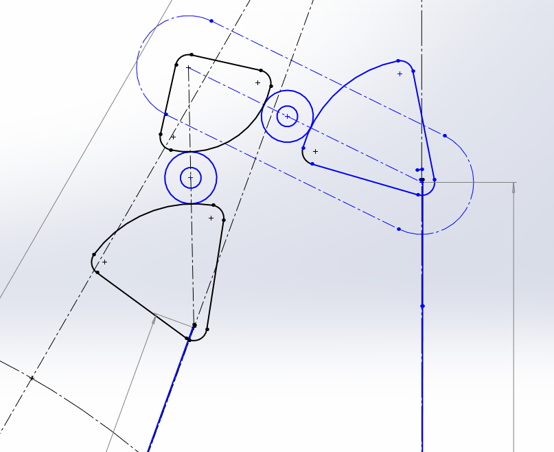

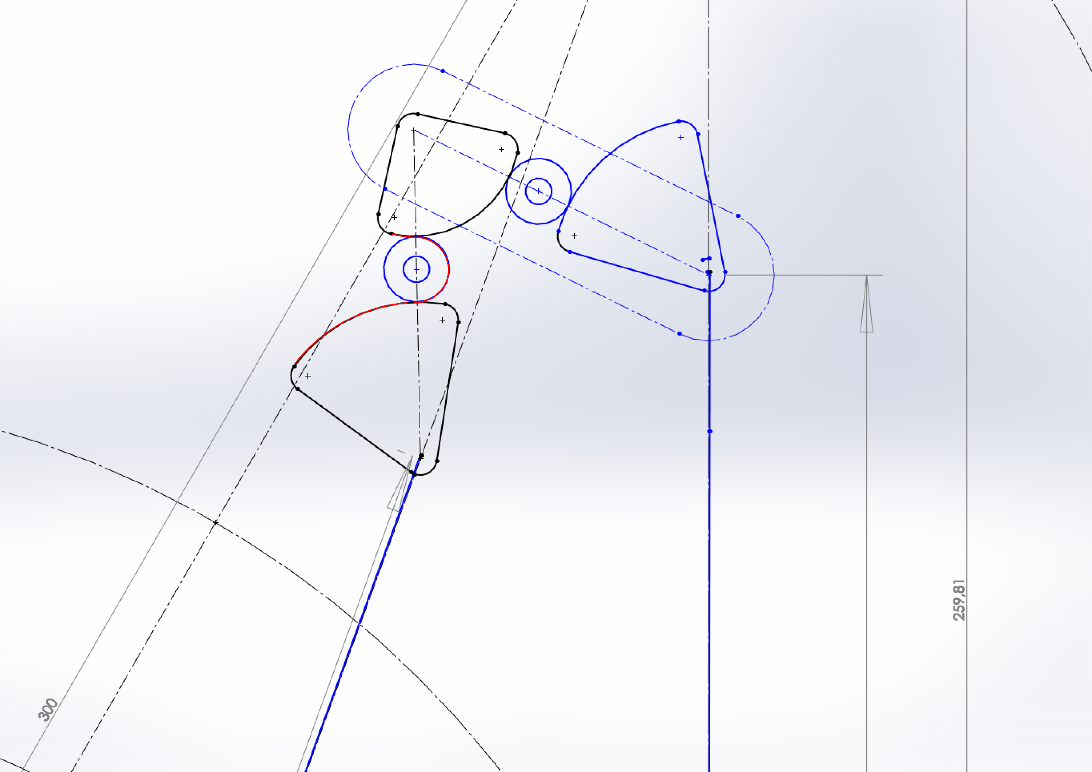

What about something like this?
attachment.php
2 Cams, one fixed, idler and the other cam on Sapphire rod and cylinder bearings. The idler is 10mm Sapphire cylinder.
Hiten's idea for the Rolamite tickled my fancy because of cost, very low friction and ease, start and end belt positions below.

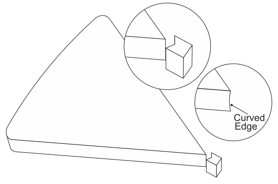

The Guitar Puck shaped Pulley can have vertical knife edge bearing to lower the friction. See pic attached. The Ribbon/Belt will hold the pulley against the knife edge bearing. The Knife edge will be little curved (Shown little exaggerated) to further reduce the friction.
Regards
Very nice Hiten.
That would be much better than another rolling or sliding element and that leaves only the crank and cam as such.
That should be manageable.
If the crank is counterweighted a dual pivot and jewel cup bearing could be used.
Somewhat complicated though.
I like that warps might be less of an issues here.
Hi 2wice, what is the reason of the idler wheel? I can not understand, it turns the right way with just two (attachment)
Hi Niffy: between those two wheels or cames there is no relative motion, so (almost) no friction, as for the belt. Instead there is the risk of slippage and non-uniform contact (eccentricity, deformations of the materials & so on) which is absolutely to avoid. The gears could be perfect, with perfect LPs, perfectly centered (no reverse backlash)

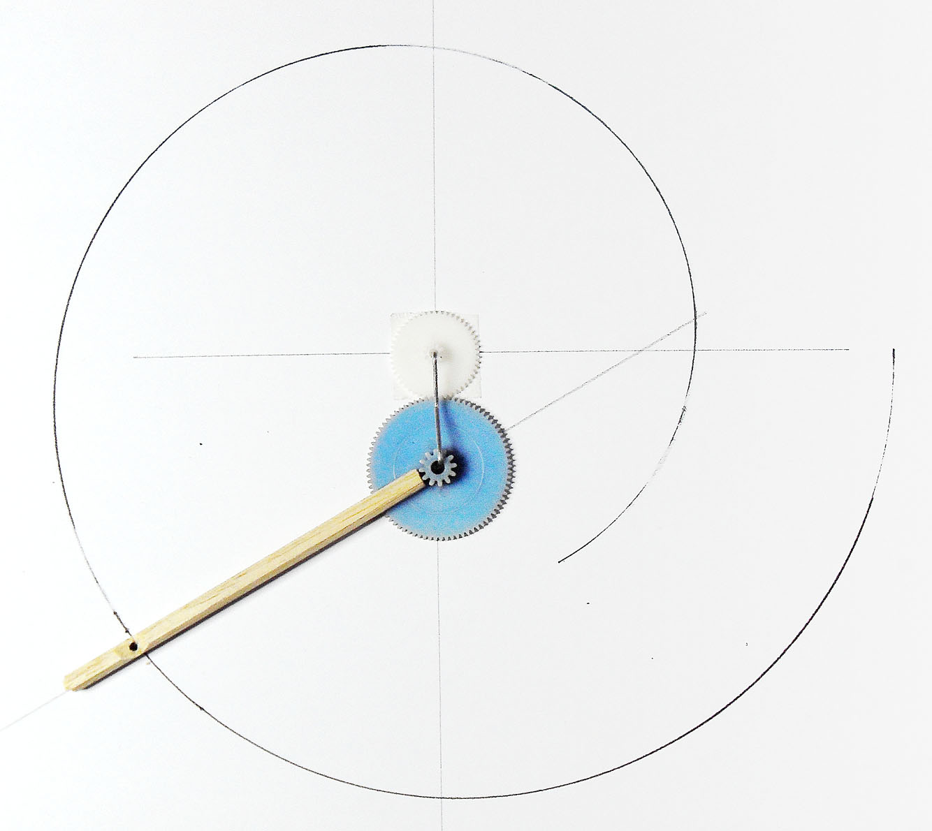

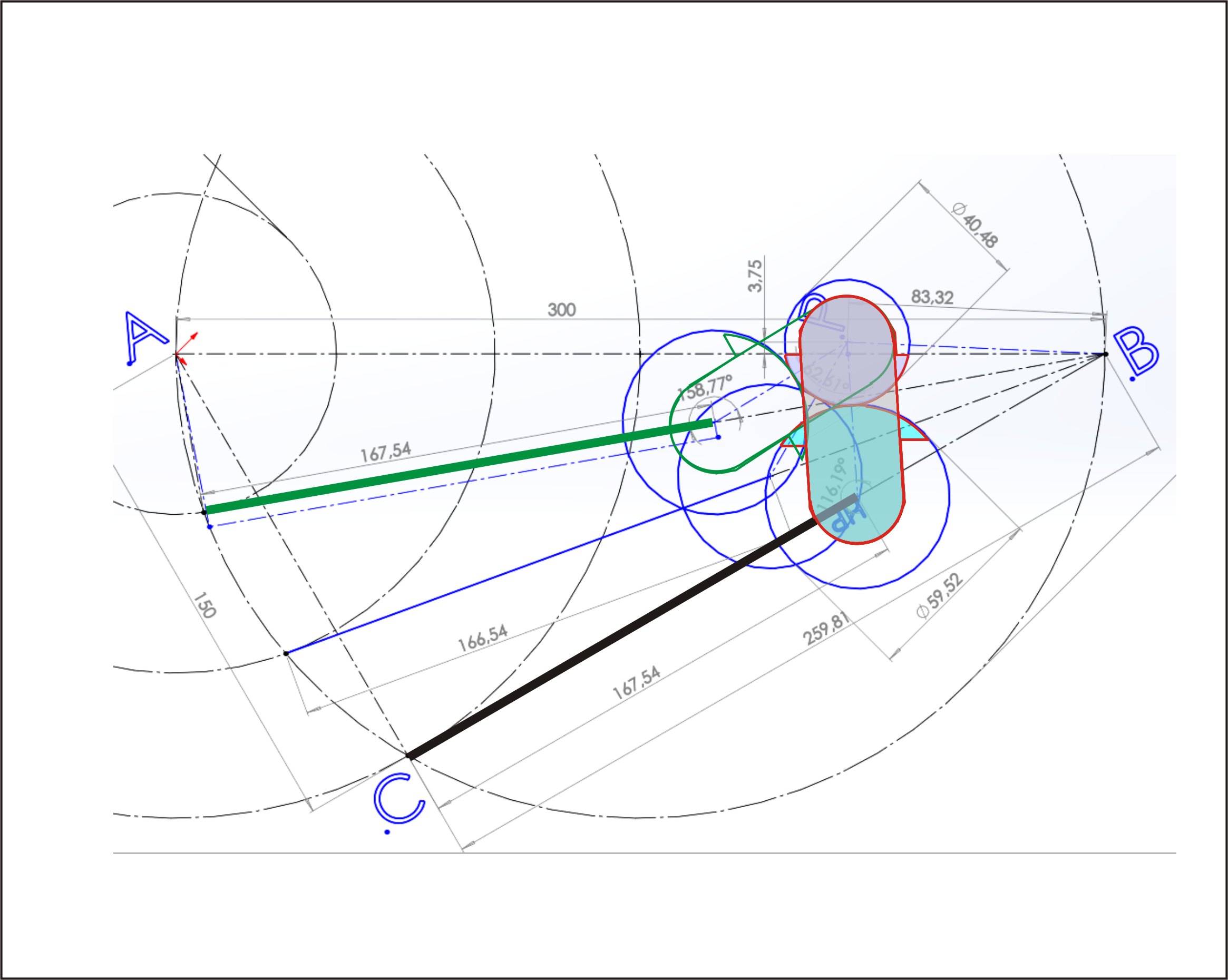

No one playing with vectors? I'll have to switch on my lathe..

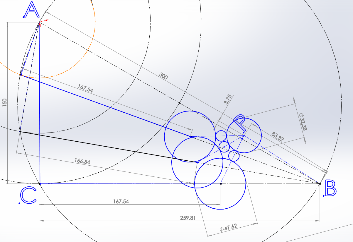

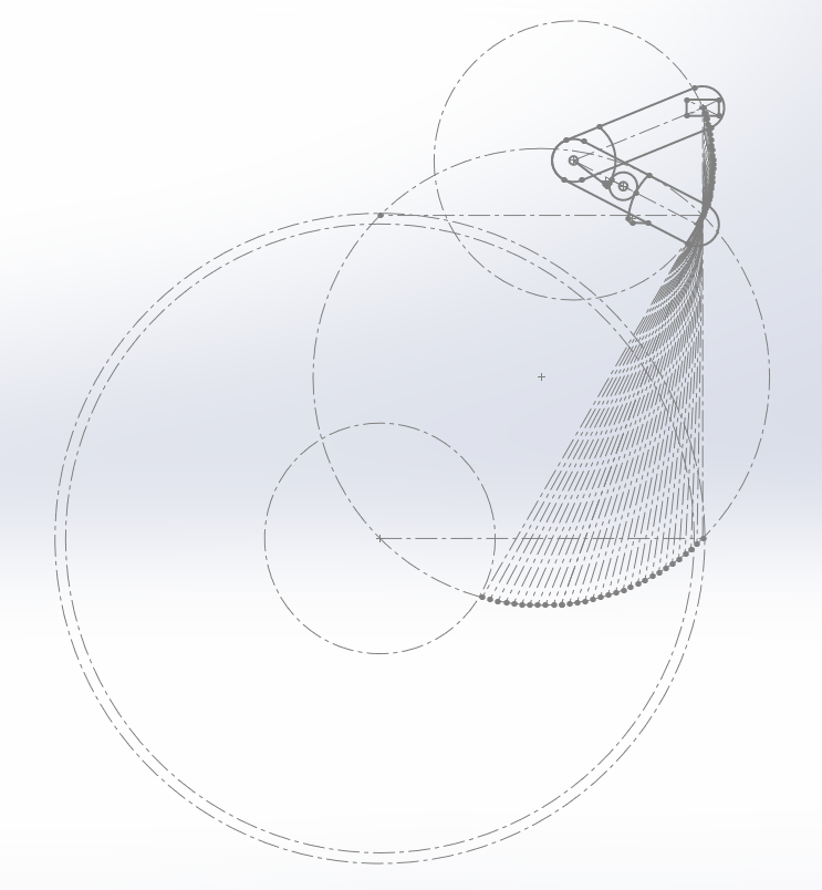

Tried to fit the cam + strap mechanism to my August 2017 drawings and it fits OK.
3 nulls, 0° to 0.4° to 0° to (-1.1°) - 0°
Can reduce the -1.1° at the expense of increasing the 0.4° error slightly and only 2 nulls then.
Should be able to get sub 1.° errors across the record by using some offsets and reducing the moving crank length somewhat.
Bottom bar + cam is fixed, top crank cam & idler rotates in Rolamite config.
You can reduce the tracking error by increasing the moving crank length, but this looks manageable.
