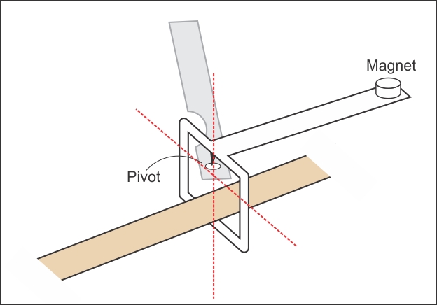

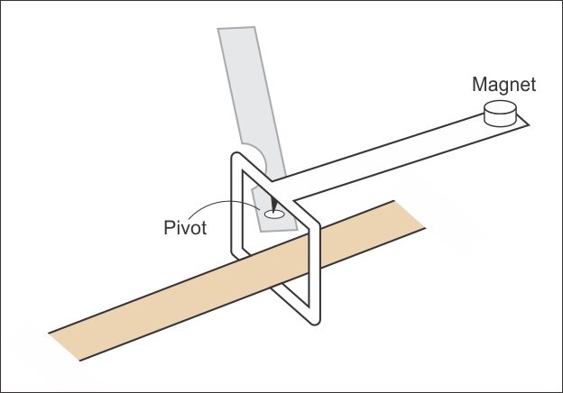

You can reduce the bearing friction by using unipivot. Something like attached picture.
Regards
...wait. posted in a hurry. Didn't notice the magnet will be pulled to nail/iron. to counter that either we need vertical gimbal type unipivot bearing top and bottom which I guess will have less friction than standard ball bearings.
Hello Hiten, thank you for your nice painting an your design suggestion.
but look at my last post, the arm is balanced to 1.5 grams and the friction comes from rubbing over the paper. In the vidio i wanted to show that the arm follows the geomety on the drawing even under that conditions, moreover the magnetic system leads the stylus back on track. I checked the arm under balance, and youre rigth Hiten, there is a problem of friction in the horizontal wand bearing. maybe the washers are rubbing at the frame.

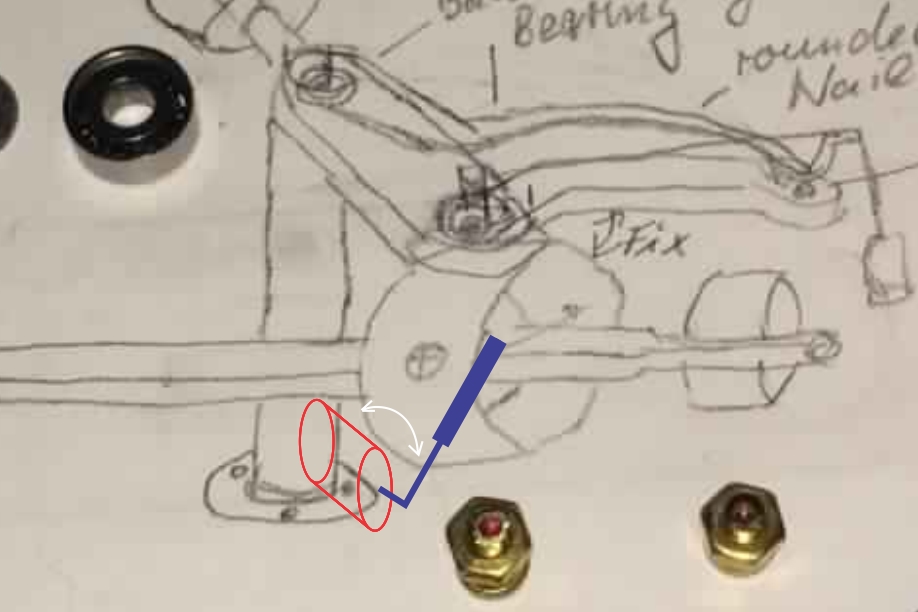

But a more severe point is I don't have a good idea for making a tonearmlift, does anyone have a sugestion?
A traditional lift is difficult to integrate. My tendency in the moment is to dip the backend of the arm because the way for lifting it would be shorter then at the frontside.
Uwe, awaiting your ideas

On the arm lift, the problem is that it has to follow the arc described by the 2nd pivot, and this is not simple (Hiten, as you think, a lift in that position can be really dangerous) You may find something at #1704 #1719, design not used because it gave more complications than advantages.

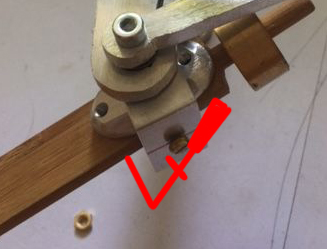

Hilten, thanks to the Idea, but my fingers are not so tiny and I would prefer to fasten the Lift at the tonearmbase, if I imagine a additional scating mechanism it may end in the way where your suggestion would be connected, or near by.
I Think I will construct the Lift from bare metal and build it completely by myself, The Idea from nocdplz sounds interesting. In fact I have still the groundplate of the lift in my lathe, but didn't manage to get completely through the metal. Yesterday it was sunday and you couldn't make too mutch noise because of neighbors. It's germany i'm living at!
Cheers Uwe
That kind of lift should be much easier to be made on your arm, since your base does not turn - it's just a z-shaped (or u) lever connected to the crank - pushed (or pulled) by the lifter at the base.

my last change was to implement double bearings, now the arm is much more precise. This was possible because I builded the arm from 4 mm profiles and my bearings are only 3 mm thick - an overhang of 2mm each side is the result. Also I was able to avoid all the small washers for adjusting the right distances between the parts. I now only have to push the bearings out of the fixation in the right direction.
